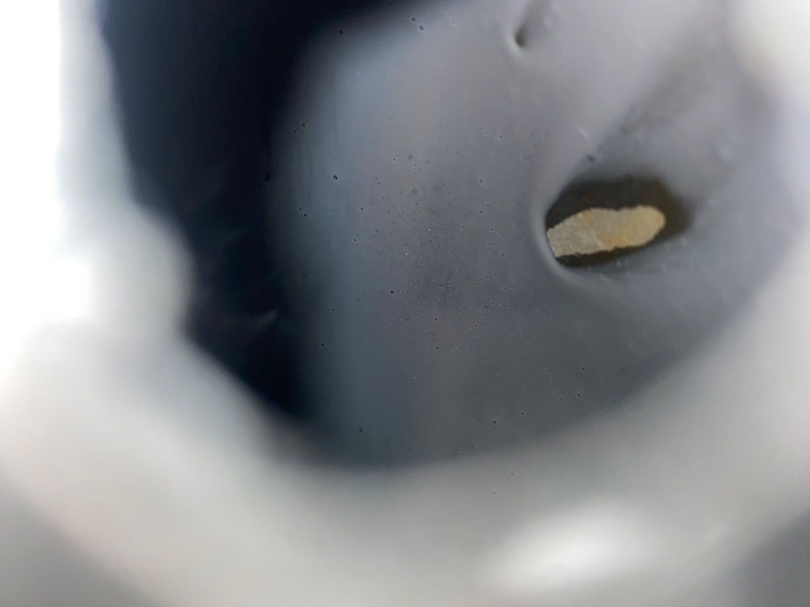

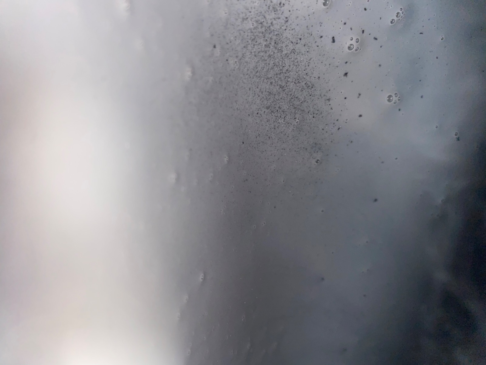

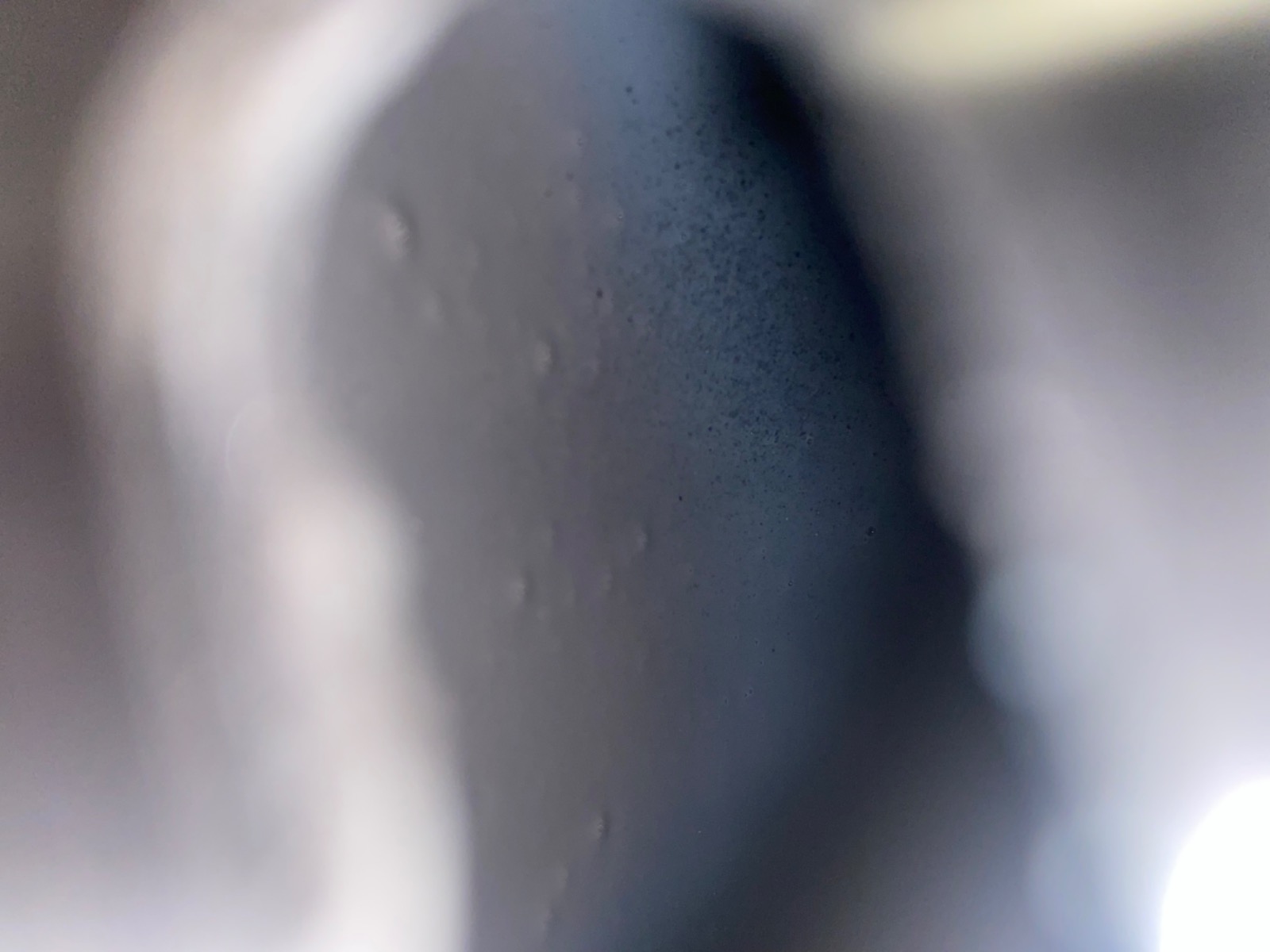

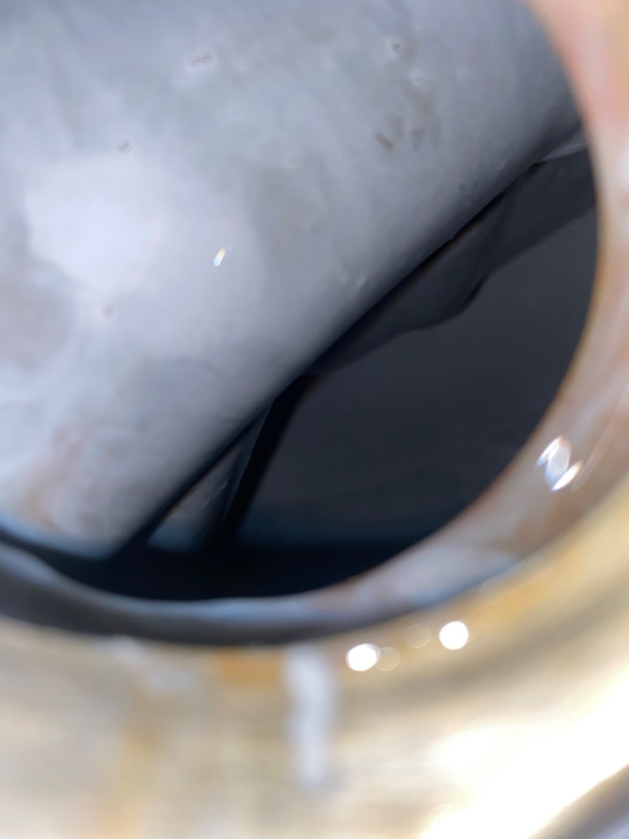

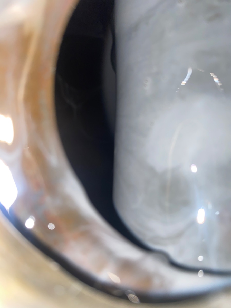

UPDATE: not sure if anyone else has ever used the Caswell tank sealer for their tank, but i would only recommend with the warning to anyone else that the “10 gallon” set for a motorcycle will NOT cover a 10 gallon tank. I mixed half of it up, 5 gallons worth of epoxy for a 4.5 gallon tank. Mix for 2 minutes, pour it in, cover the fill port with duct tape and get to rolling the tank to spread the epoxy. I do this for 15 minutes, I set a timer to confirm, at this point I am trying to drain any excess out of the petcock or fuel sensor port. Pull back the tape on those and they are bone dry, I use my phone and a flashlight to look in there and only half of the tank can even see any of the epoxy. So hurriedly I mixed the rest of the epoxy, another “5 gallons” worth and poured it in, this time I made sure it had good coverage and even had only a little to come out when it was time to empty the excess. Extremely messy stuff but that’s just my experience and .02
I’ll post some pictures once it has hardened and solidified more. It looks like it has good coverage and good color now.
TLDR: If you buy the 10 gallons worth, DO NOT try to split it between tanks. This will only lead a half-arsed job at sealing 2 tanks.

After further review, the epoxy coating has only missed one small place on the top side of the tank. Since all “10 gallons” worth was put in there, I cannot blame the caswell for missing that, it was my own error. However, everywhere else seems to be coated nicely.

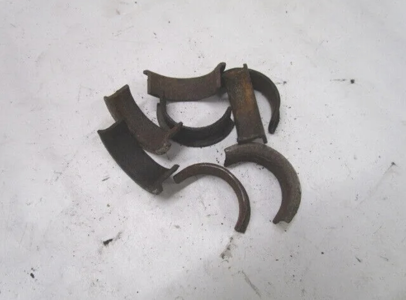

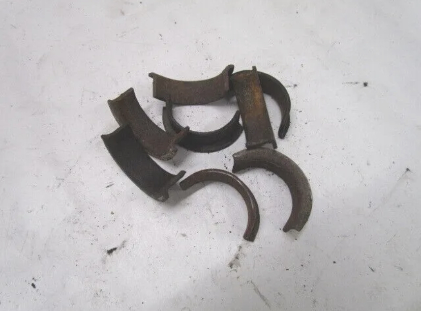

I went to install the new Delkevic system and it seems I have hit a snag. On the original exhaust, it had small little half moon kinda manifold collars to hold it into place. Looked like this…
Well I’m not sure if the KZowner I bought the exhaust from accidentally threw them in with the new Delkevic kit or if I am just missing something here. Everything installed well without them, I don’t even see a lip for them to catch on. The exhaust is held on well without them. Overall just confused here, can anyone with a Delkevic system tell me if I actually need these? Another thing that throws me off is that they are brand new, no rust, no use. They look like they were supposed to come with the kit.
