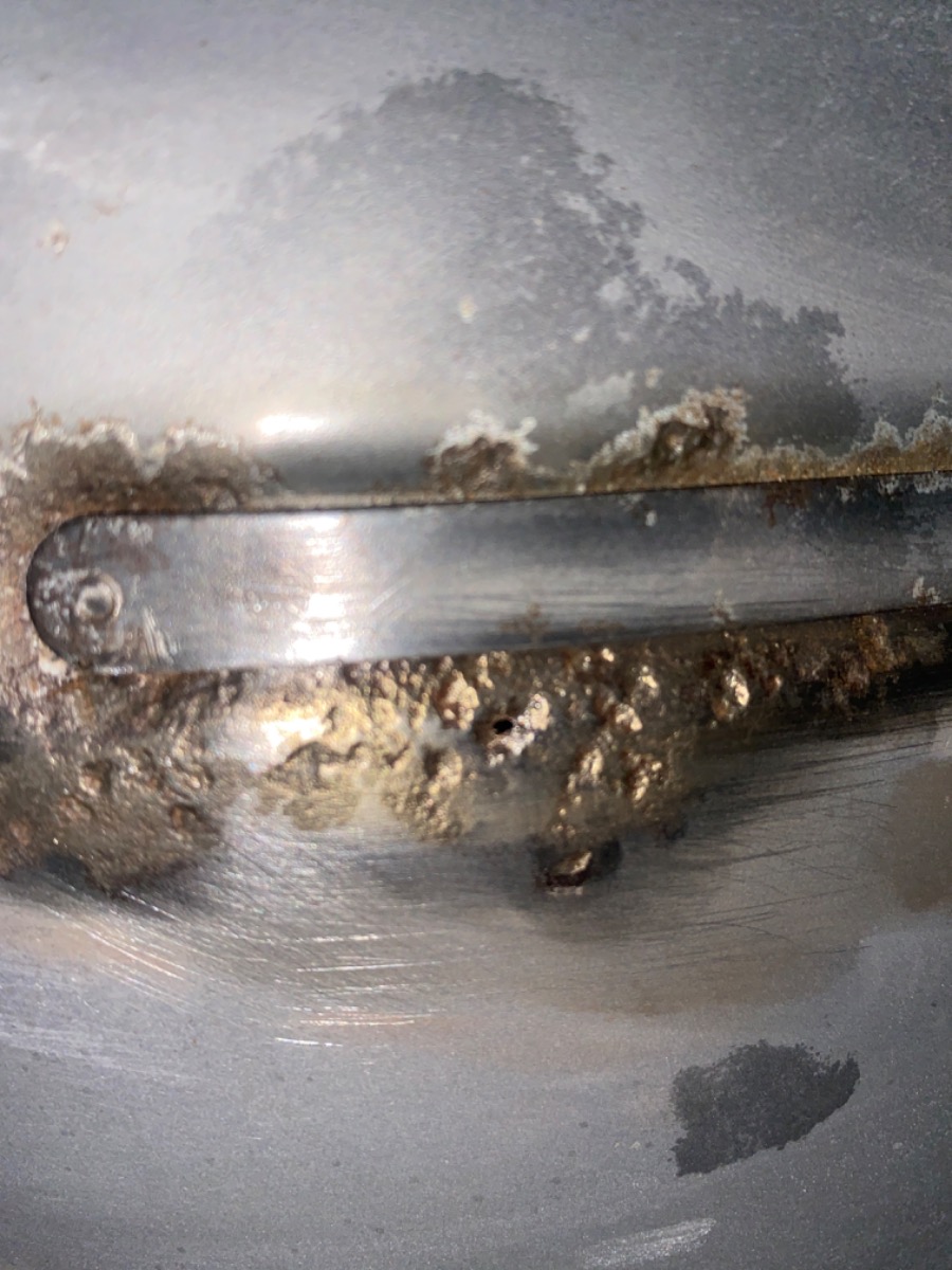

Good afternoon all. While waiting for wheel bearings I figured I would start the next project, which is to fix the gas tank I just bought. Started by stripping all the paint off the outside of the tank, not the paint under the backbone but the visible paint. I have gotten through the main top part of the tank with the body filler and blending it all down. I move to the side of the tank where the emblems were and start to clean off some of the rust that was present there and I find this
I have already put a lot of time and an ample amount of money into this tank already, is there a good way to fix it? I am not partial to the emblems so if it would involve covering the emblem mount completely and giving it the shaved look, I would not be opposed.

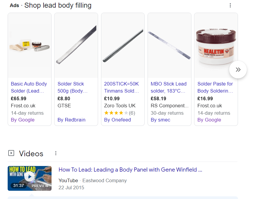

You could use "lead loading" to fill if you aren't happy brazing. This is only a problem if you intend to powder coat as the oven is hot enough to distort the lead filler (back "in the day" all body filling was done this way)

I don't unfortunately. Would be good to google it, basically you use heat (propane torch etc) and lead bar and use the lead as you would "bondo". This process preceeded bondo as a filler but is a much more permanent repair.

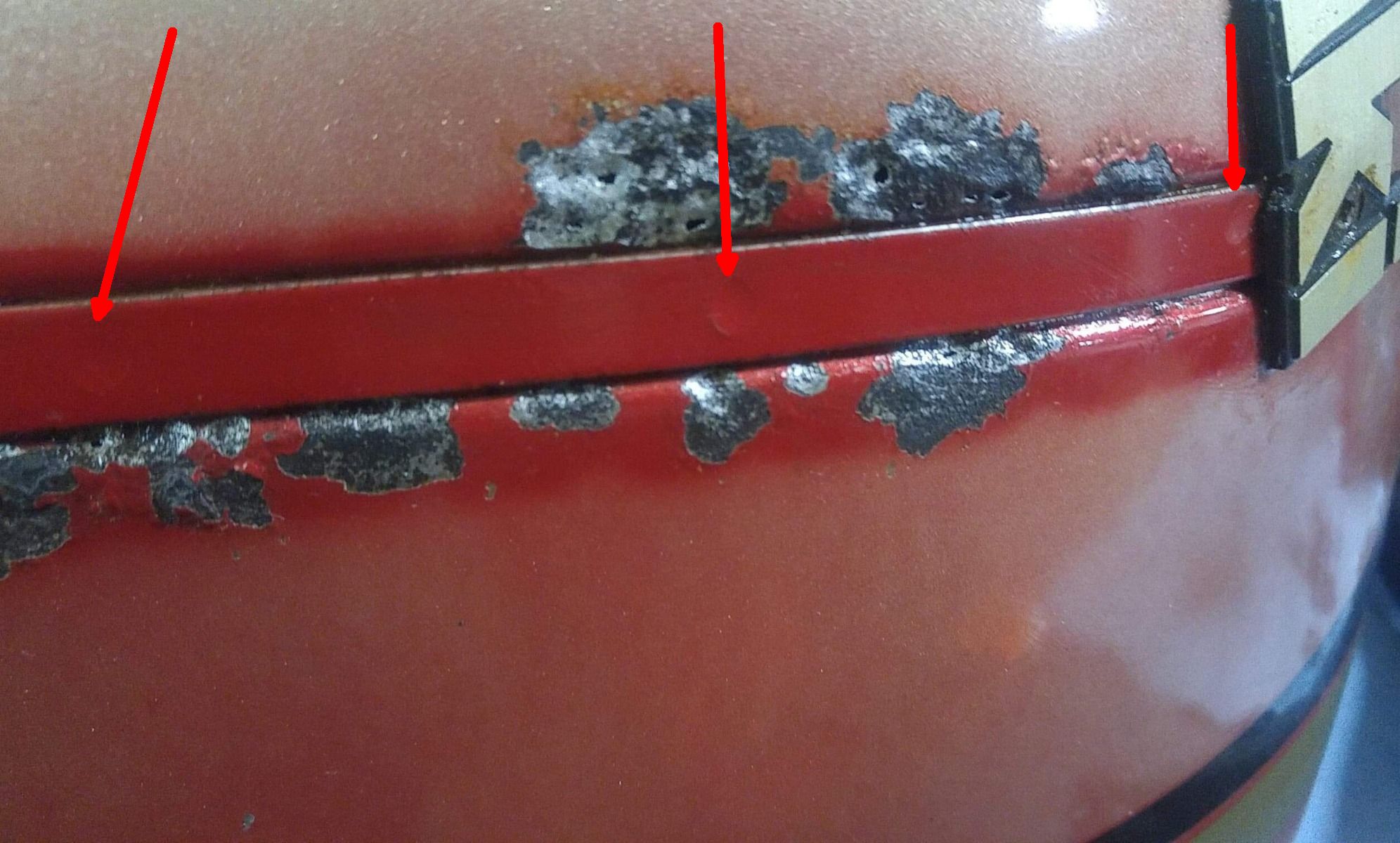

21 Jul 2022 09:43 - 21 Jul 2022 13:13How are the emblem straps held on? Would I have to grind them off to get to the back of them?
I have never had any good luck with brazing so I think I want to avoid that route as it has never ended with good results.
The enblem strap have three dot welds,
kzrider.com/forum/6-paint-a-bodywork/612...is-tank-toast#818039
