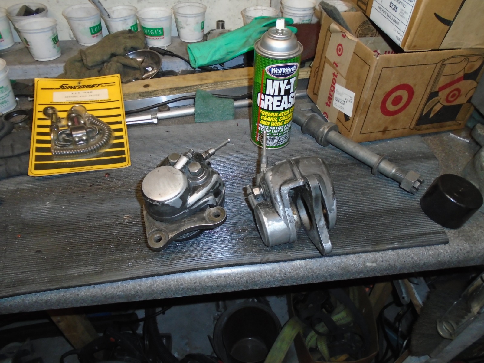

Yes, common sense will prevail! I will take them apart, glass bead them, I'm afraid of what I'll see, (pitted pistons) then paint them.
Then I will be making new custom SS braided #3 hose with the factory 10mm / 1.5 pitch fittings going up to the banjo's

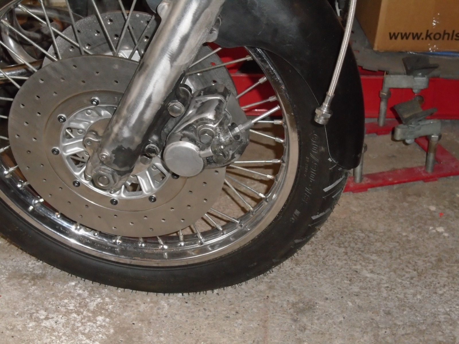

17 Jan 2021 10:40650ed wrote: If you haven't done it in a long while you may want to change your DOT-5 brake fluid with new DOT-5 fluid. The reason is that DOT-5 doesn't absorb moisture, but moisture still gets in the brake lines and puddles in one spot. While the fluid may look perfectly fine in the reservoir, the puddle may be down at the caliper and cause problems. The link below gives a description of the issue. Ed
Thanks Ed, I actually did change the front brake hose and restored the original 75 front banana caliper, maybe 10 yrs. ago and changed fluid. I found a 2014 picture. Before my current 75 FLH - HD 2019 status. Wait till you see my original paint decal 1975 gas tanks. Coming soon! Harleys are not for everyone and vice versa with Kaws, But I love and grew up on both. I was looking for a brake caliper picture and came across this one! Ain't She a beauty! I also build Mini-Bikes too. Now you guys know why I never finished the Kaw Hot Rod YET! Always doing other stuff!

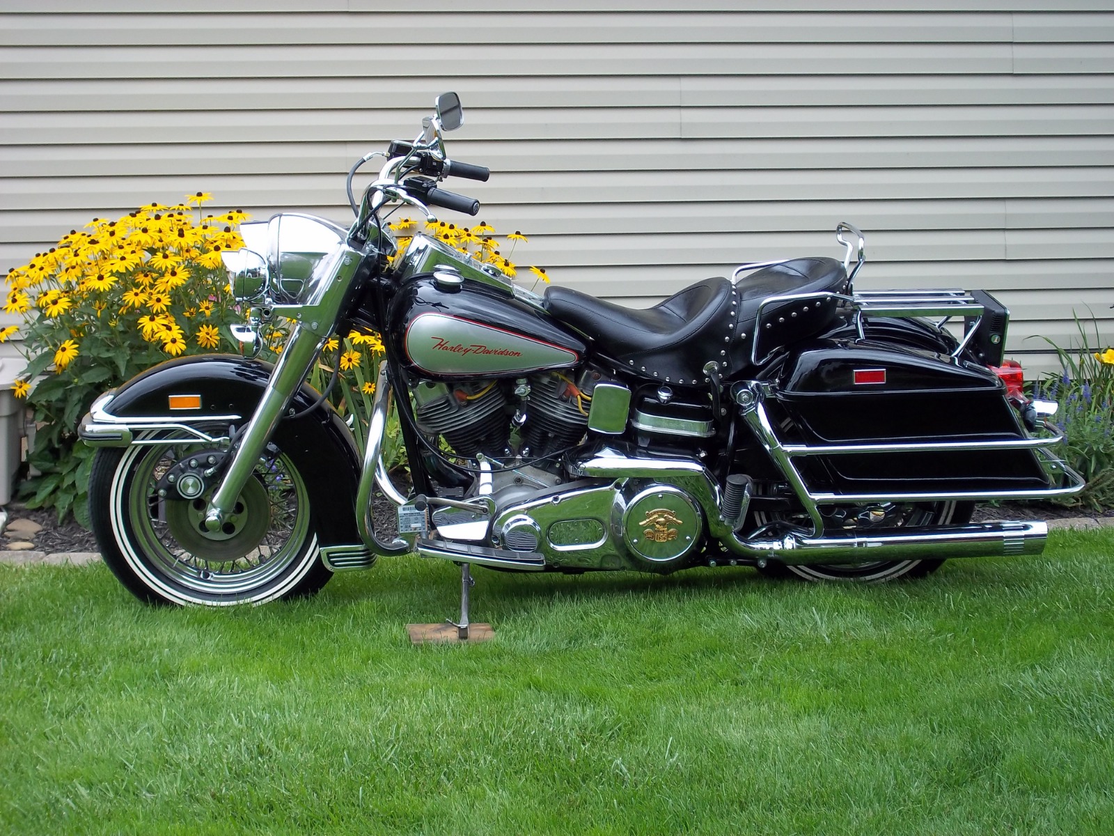

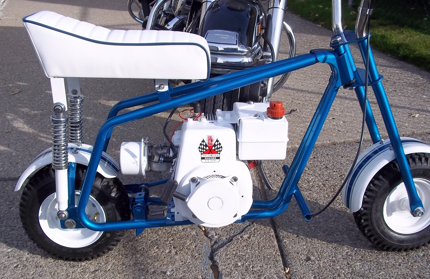

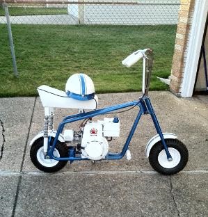

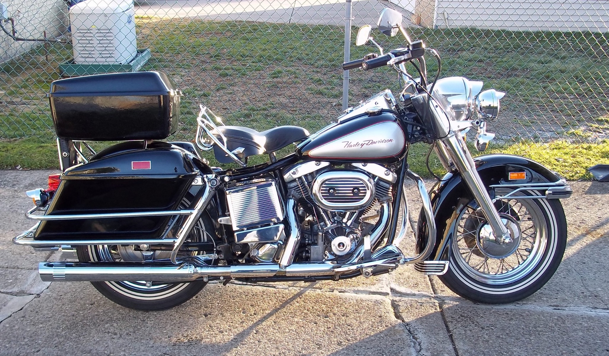

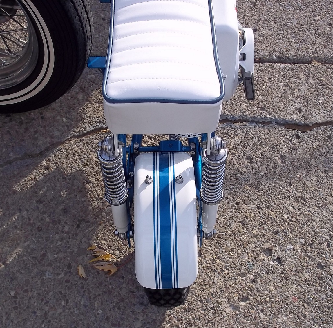

z1kzonly: Your pictures of the Harleys bring back some fond memories for me. Does the black FL have a 1st generation theft alarm on it? Looks like it does. Can't tell you how many of those alarms got tossed because they didn't work very well and would lead to rear fender cracks due to vibration. I love the mini-bike too, does it have brakes or just a "feet brake"?

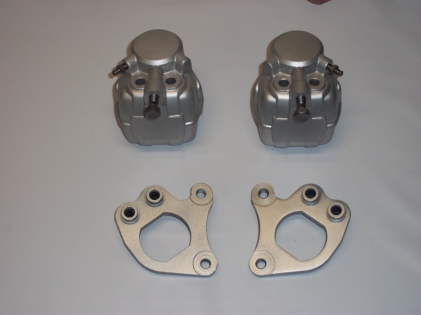

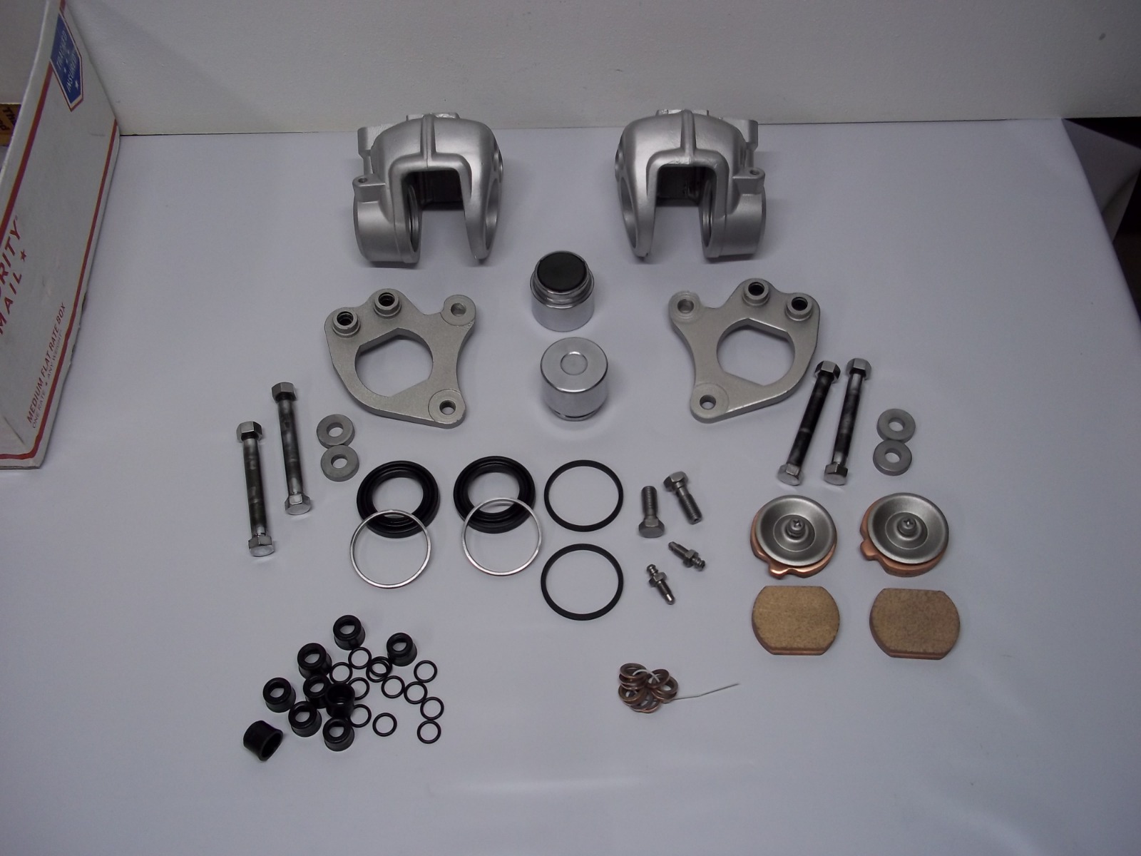

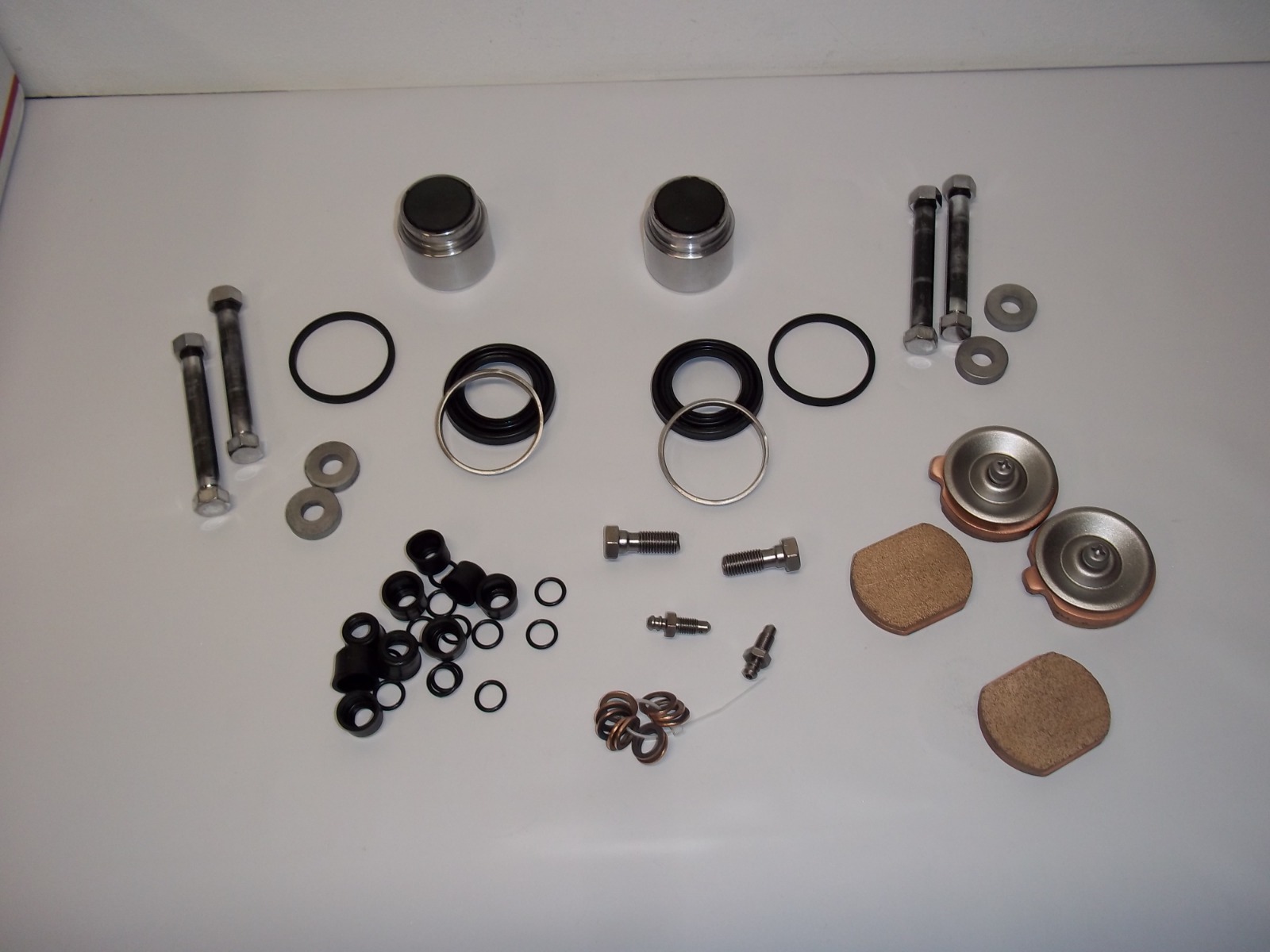

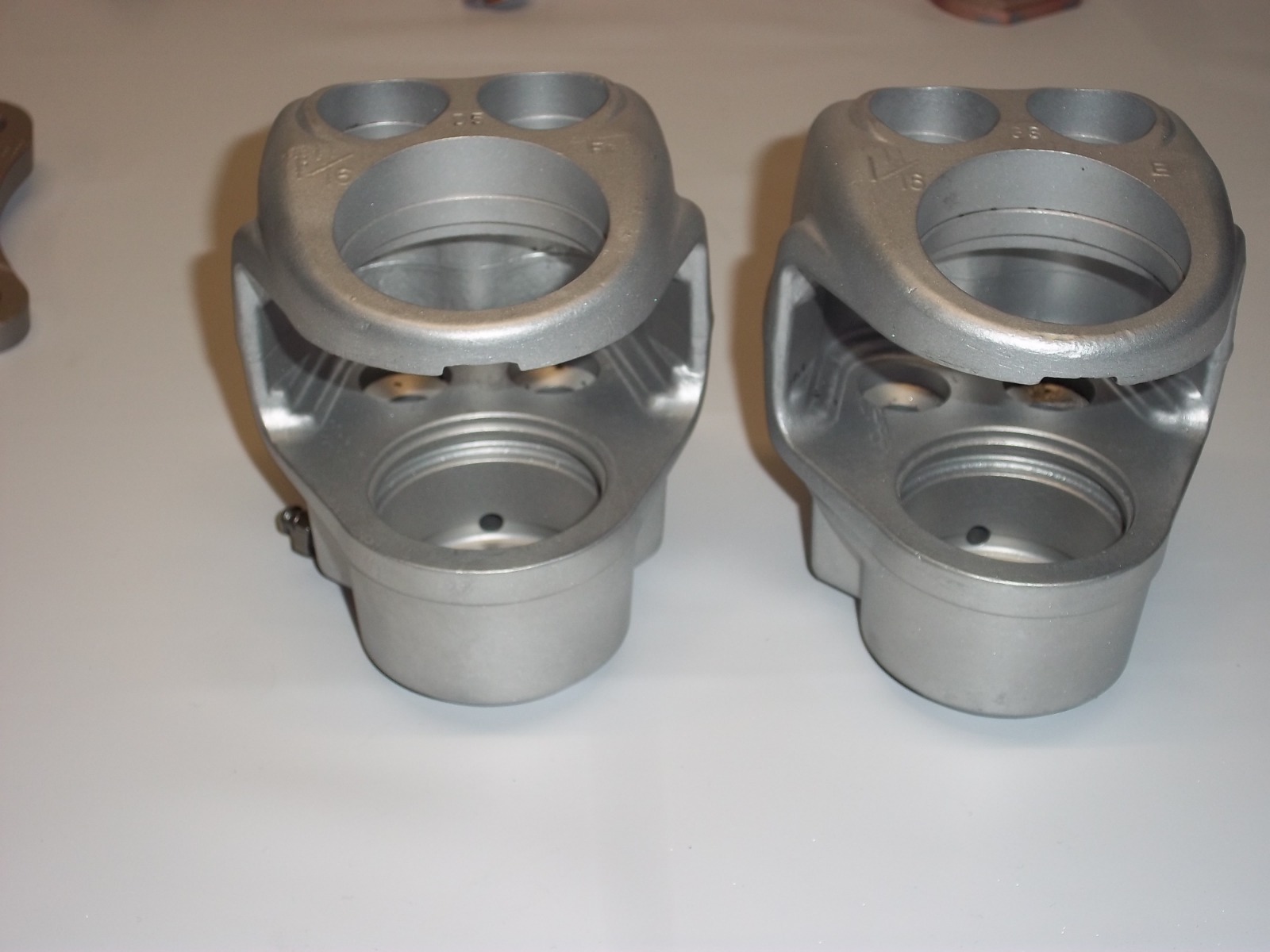

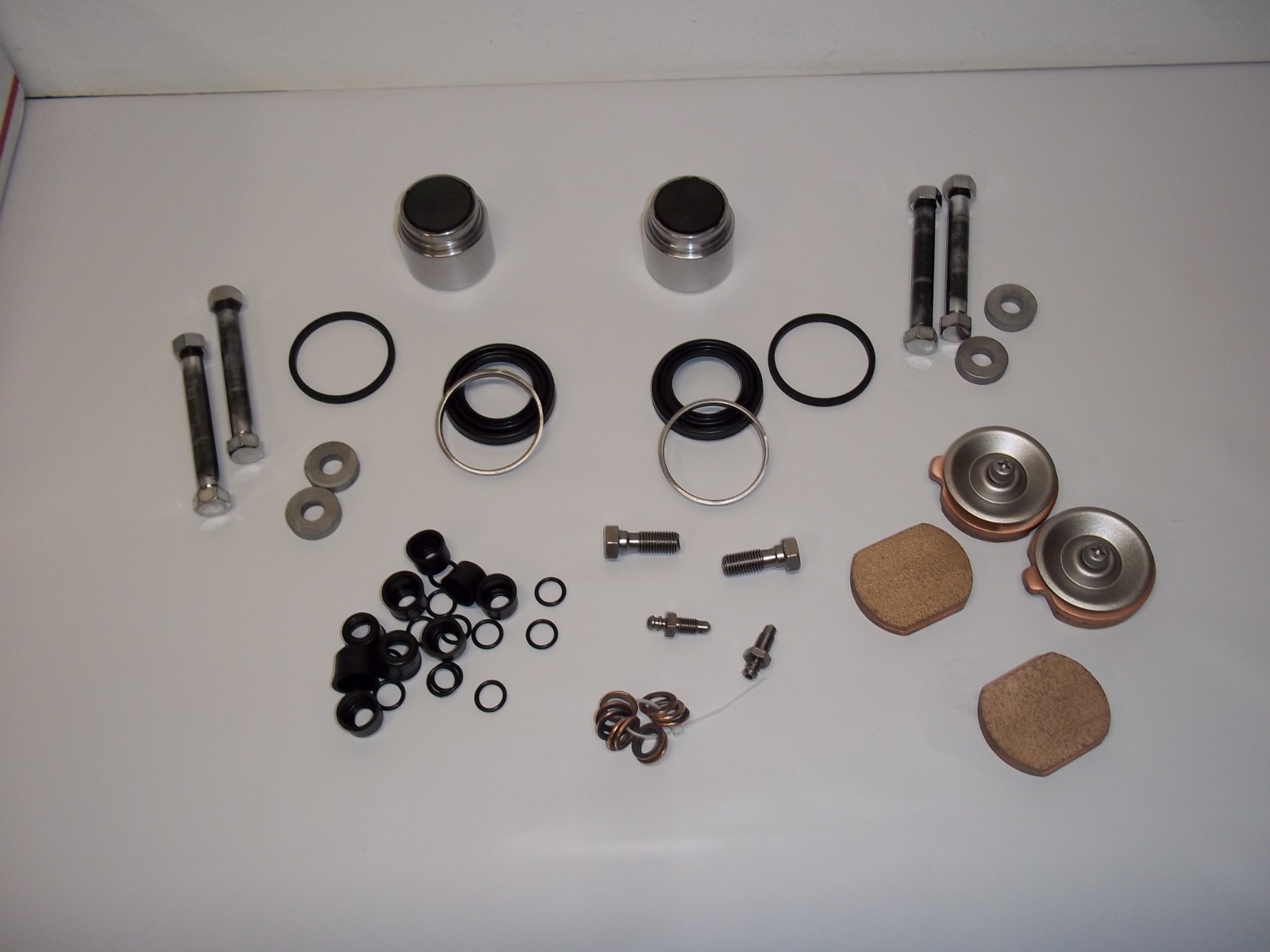

Now look at this set up I came up with! Only about 2 years! I sold this on ebay! Think what it brought for a price 1st. ??
Of course all the rubber was used, but in my opinion, I would have used it!
And, I have been trying to give up this Mad Kaw Disease for years. Every time I say I'm done, I find or buy more stuff! I'm 63 this week!
And These parts went to $80 dollars. I was happy. But it most likely took me a whole week and about $25 bucks worth of electricity to do it! :laugh: Anyone on this site buy them?? These were my ebay ad pics. October of 2018 pic file said.
Tells Ya' like all of us here we love these old motorcycles, Me Both HD and Kaw.
Yes I have Harley ink in my body, of course! But no Kaw ink:laugh:
But now I think? I should have gotten a cool type Z1 engine or drag bike or??? And I would not have regretted it today!

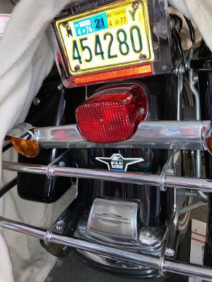

19 Jan 2021 09:58Rick H. wrote: z1kzonly: Your pictures of the Harleys bring back some fond memories for me. Does the black FL have a 1st generation theft alarm on it? Looks like it does. Can't tell you how many of those alarms got tossed because they didn't work very well and would lead to rear fender cracks due to vibration. I love the mini-bike too, does it have brakes or just a "feet brake"?
Rick H.
Thanks Rick, Yes OEM alarm from 75. And this was an old New York plate that was on my 1stlegal road bike! A little Suzuki Trails 90cc in 76, then it went on a KZ900 in 77. So glad I saved it. New York lets you use old plates as the bike is registered Antique. And the OEM Eagle in correct place on fender. That FL has not gone over 50 MPH in 20 years! Everyone tossed them alarms! They put them on Sportsters too! Still has the little vials of MERCURY in them. Check out my wall with one of the alarms. Has a Wisconsin Plate (Milwaukee-HD) & 1974 (1200cc =74 Cubic inch) How cool is that for an old Harley collectible item. Yes mini bike has a scrub brake. Here was the finished product. The handle bars are 1" on these things So I have white HD coke bottle grips, and a white brake pedal rubber from a Superglide. foot pegs have white bicycle grips. That's my grand daughter and son. Reason I built the mini bike. I had the blue paint so I used it. Plus I painted the helmet to match. Pics are from 2015.
