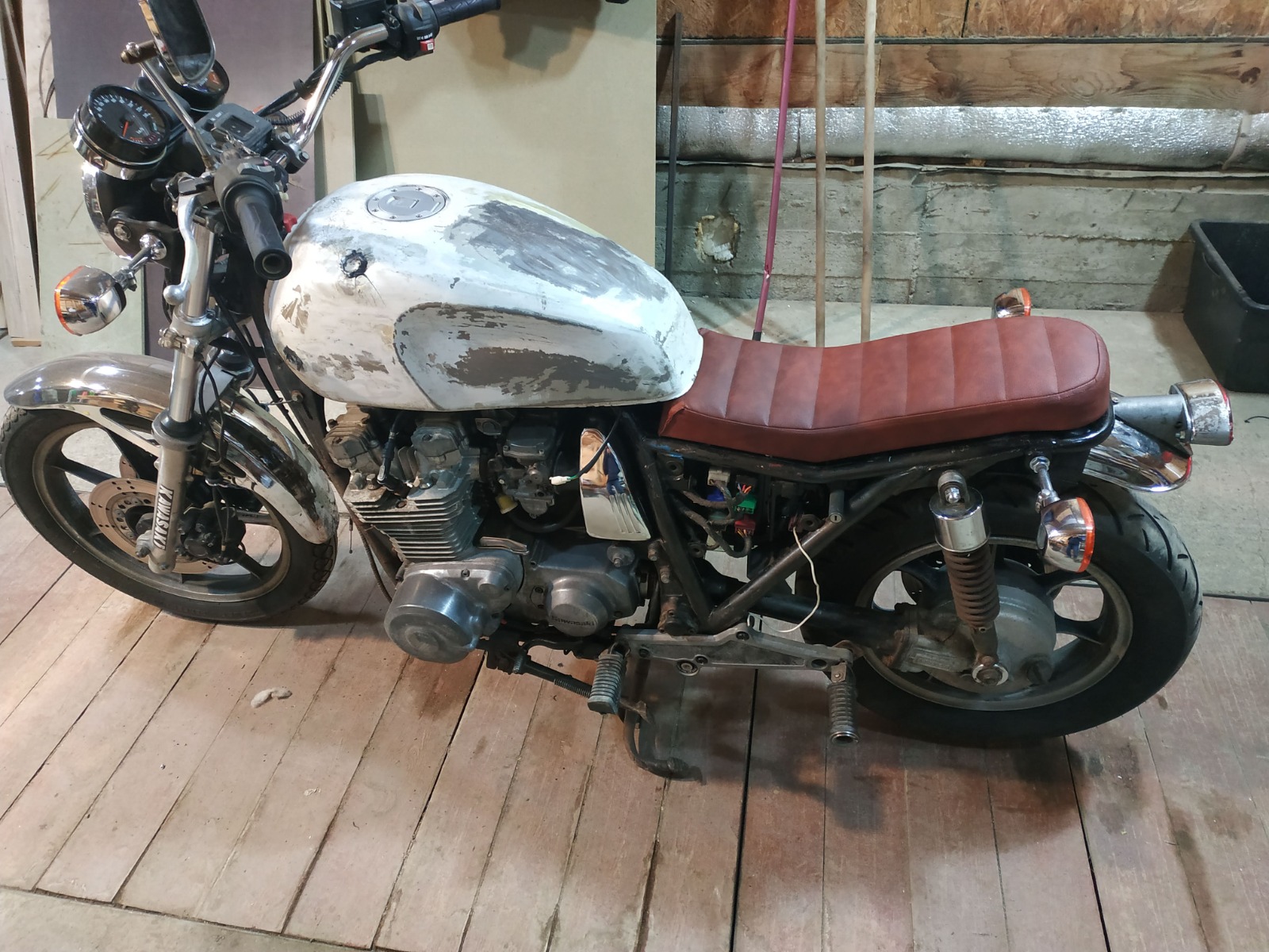

New New Update: I never did find a solution to this long term. Every filler and patch that I tried, ended up peeling off (yes, even after following the instructions exactly.)
The gas tank holes are just too big, I think. They are not really pin holes.
I've sanded this down and replaced the patch 4 times now. Enough.
I am looking for a replacement tank now:-./

YES ....finding another tank would be the best way to go, that model should be reasonably priced compared to a Z1

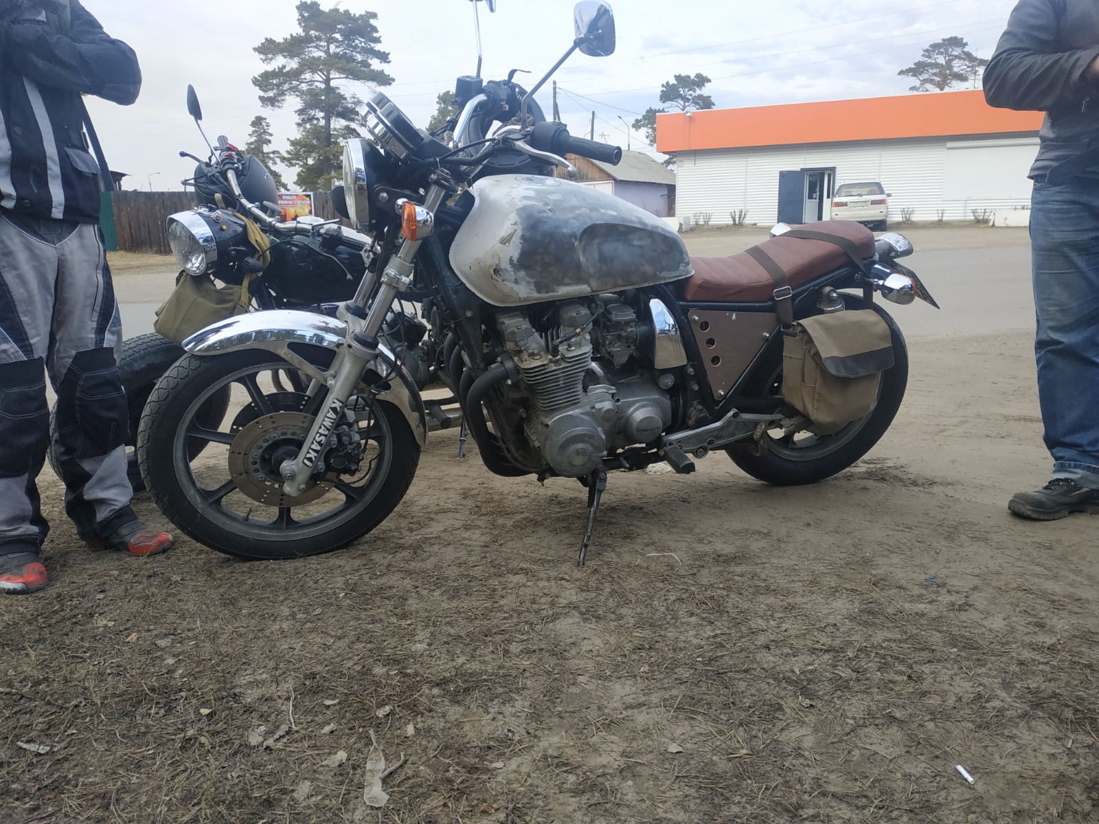

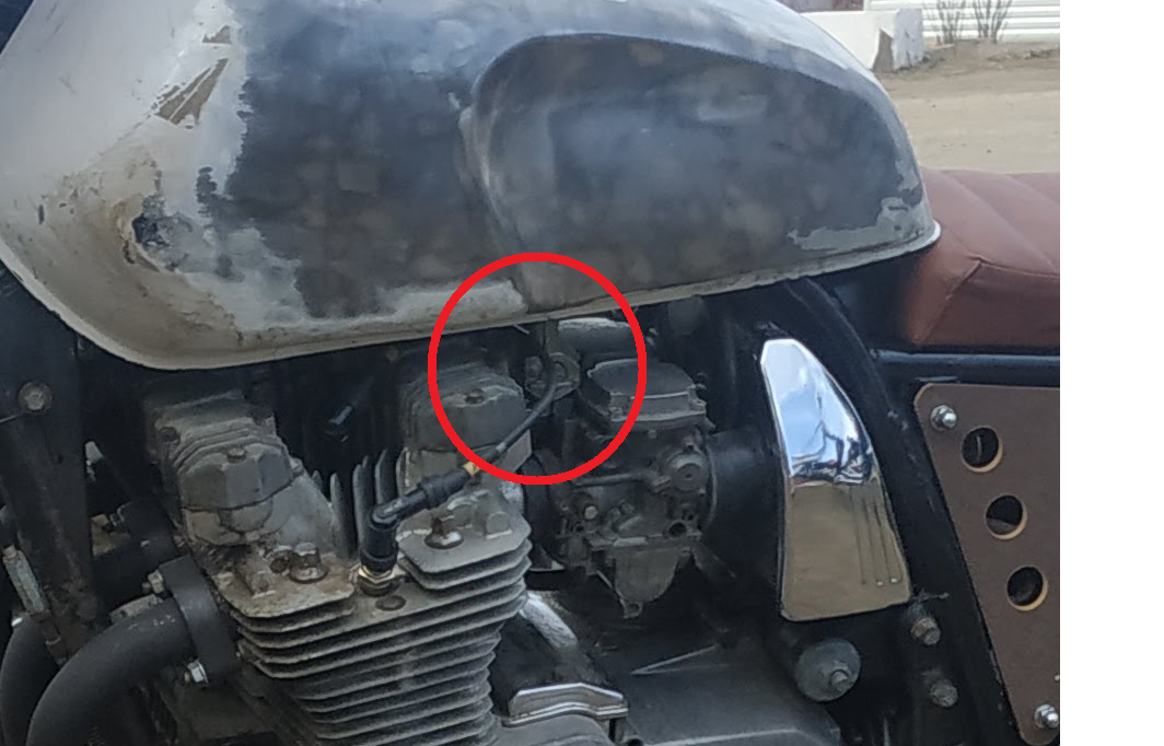

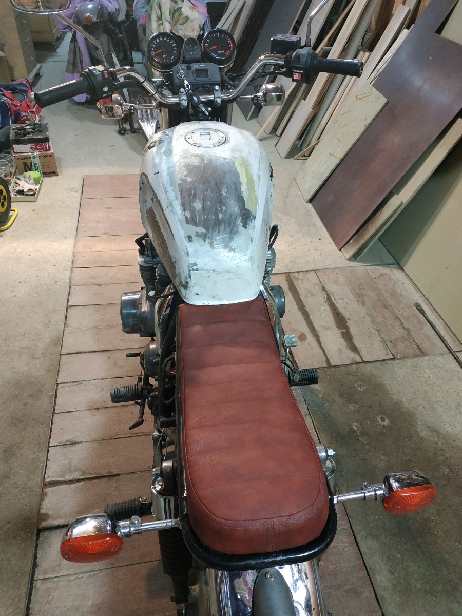

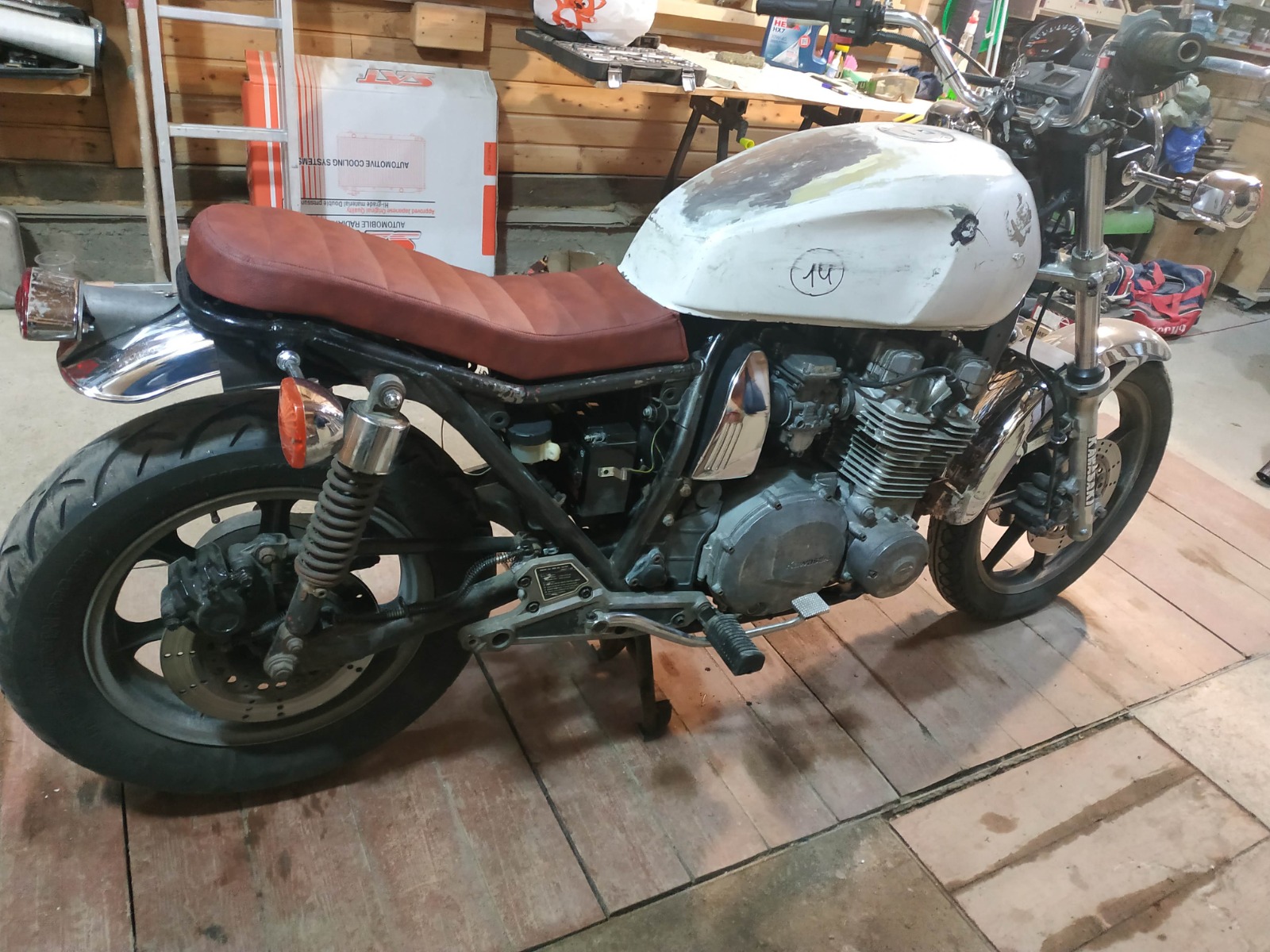

Русский язык.<br />Может кому пригодится. Для KZ 1100 очень хорошо подходит бак от Yamaha xjr400.
Обратите внимание на кран, на баке XJR он расположен идеально.<br />

It seems Yamaha xjr400 tank is a good fit. Looks pretty rad too. I will start looking for one. Thank you!

I was born and live in the north of Russia.
Unfortunately, there is practically no information on the Russian-language Internet resources dedicated to the Kawasaki Z, KZ, GPZ series. I am very glad that I found kzrider.com.
I beg your pardon, my knowledge of the English language is scarce.

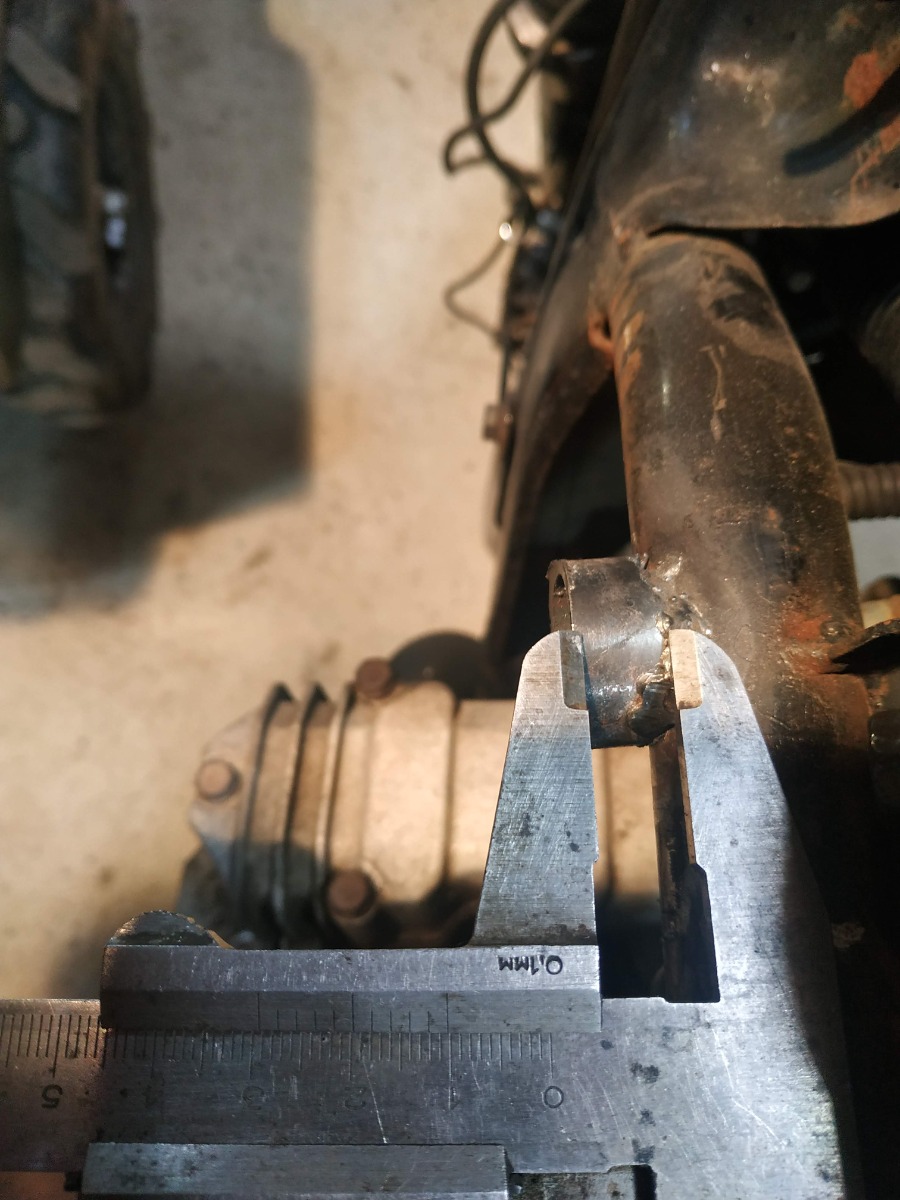

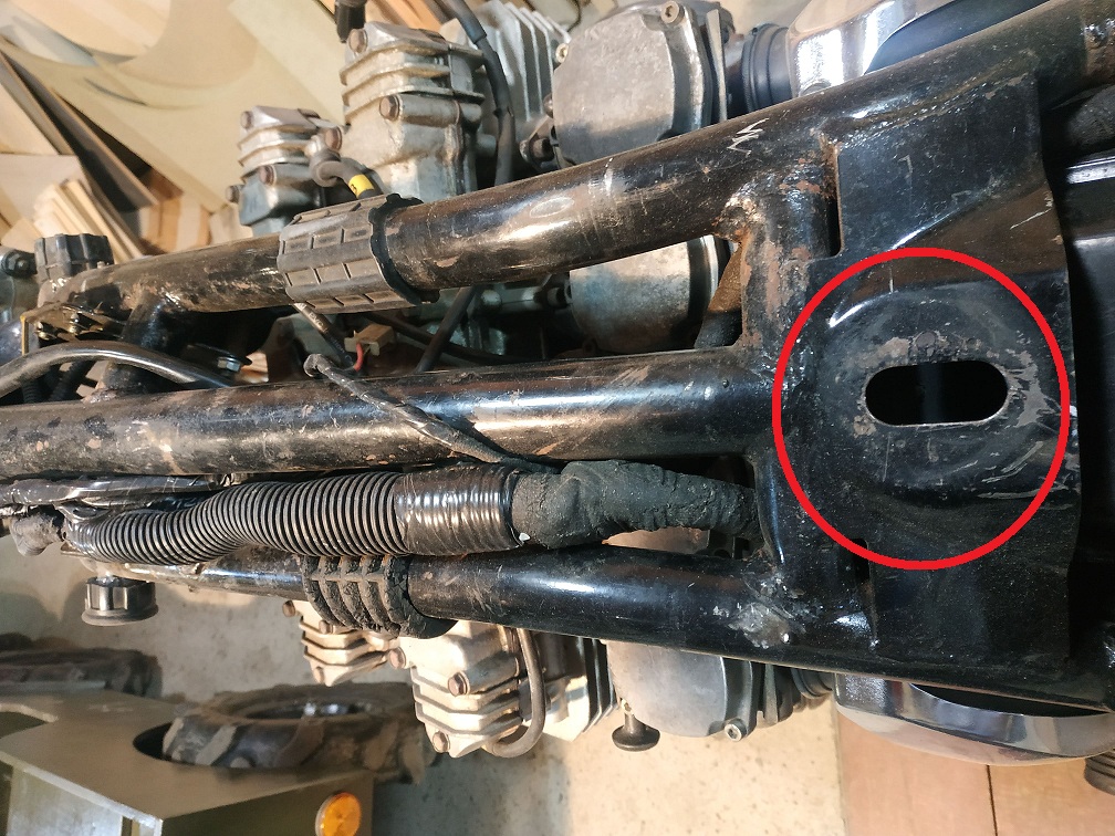

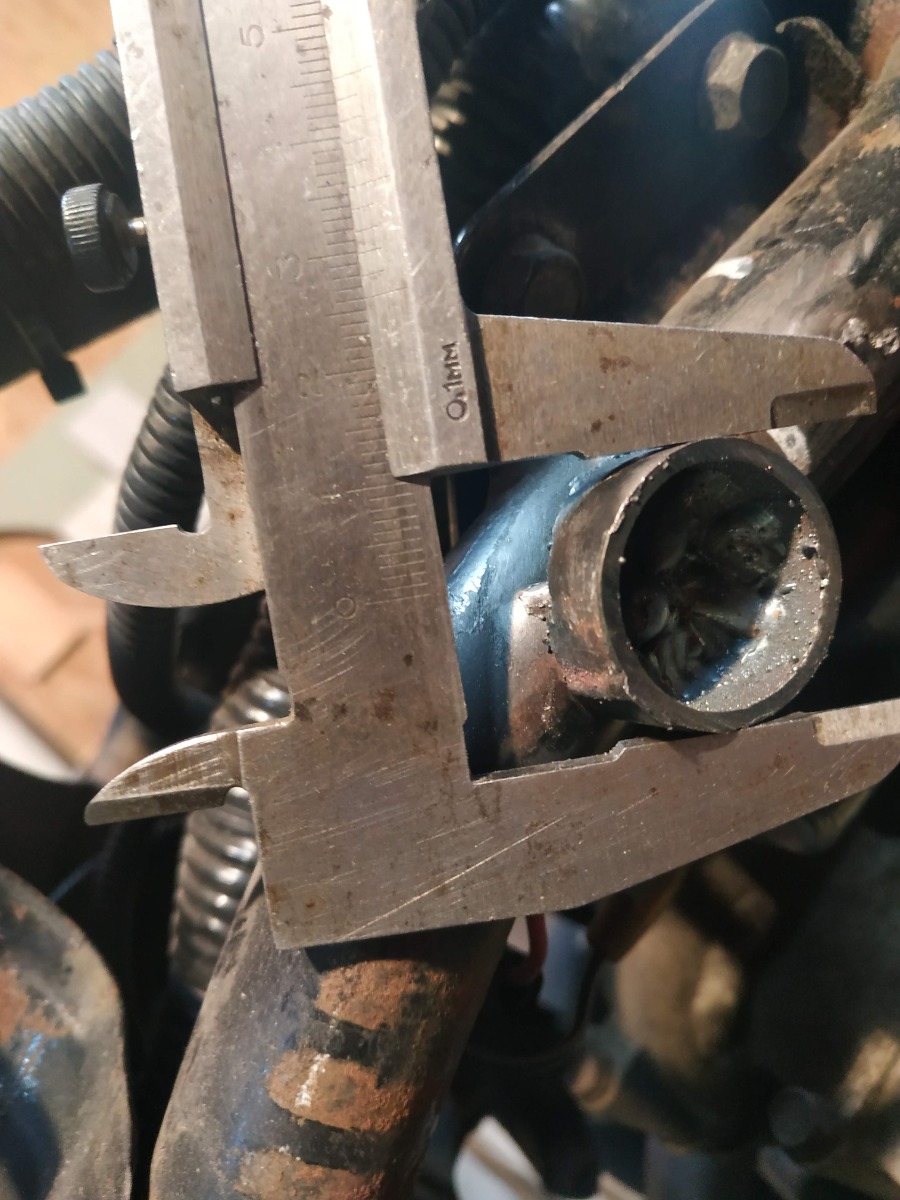

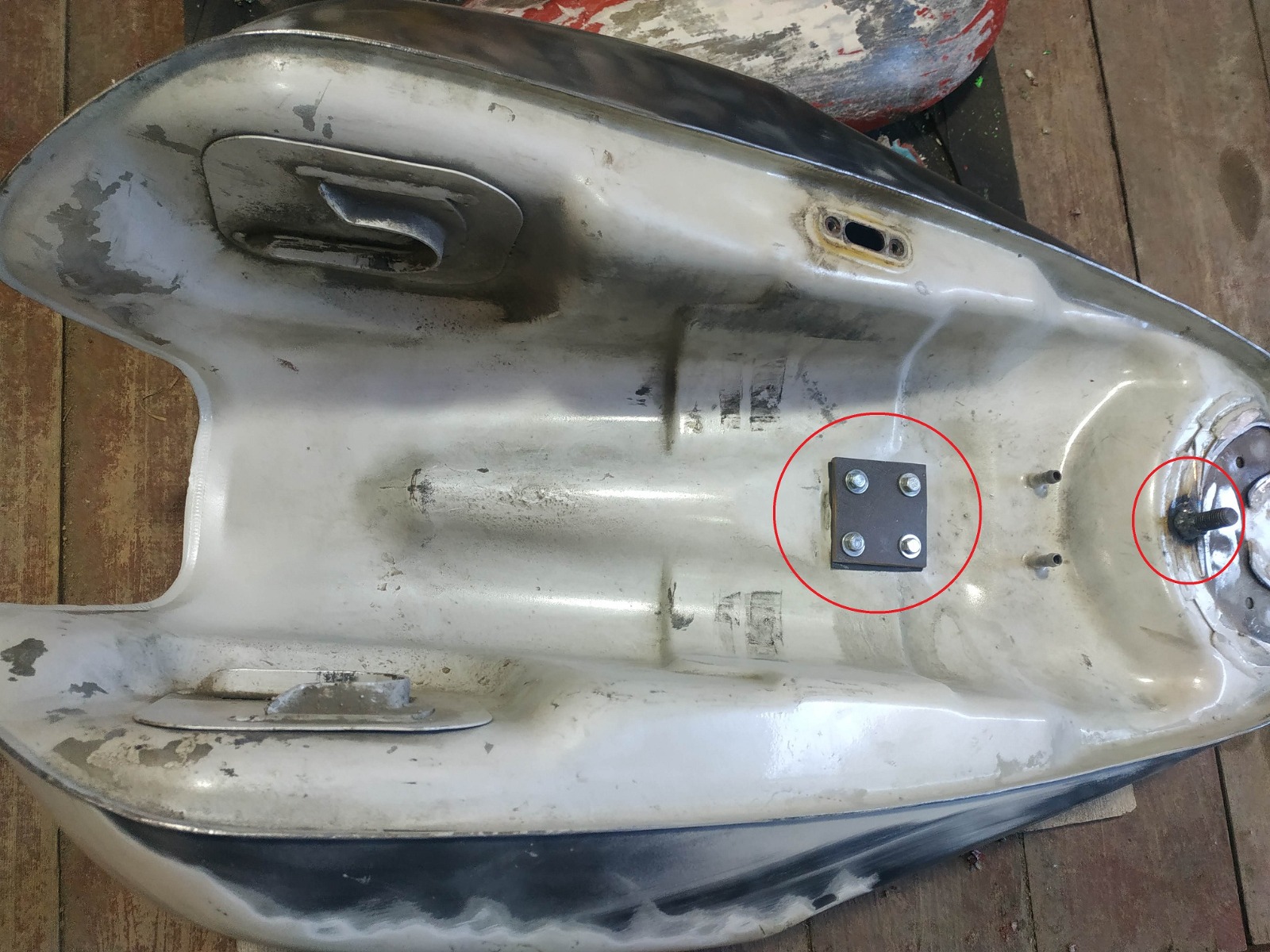

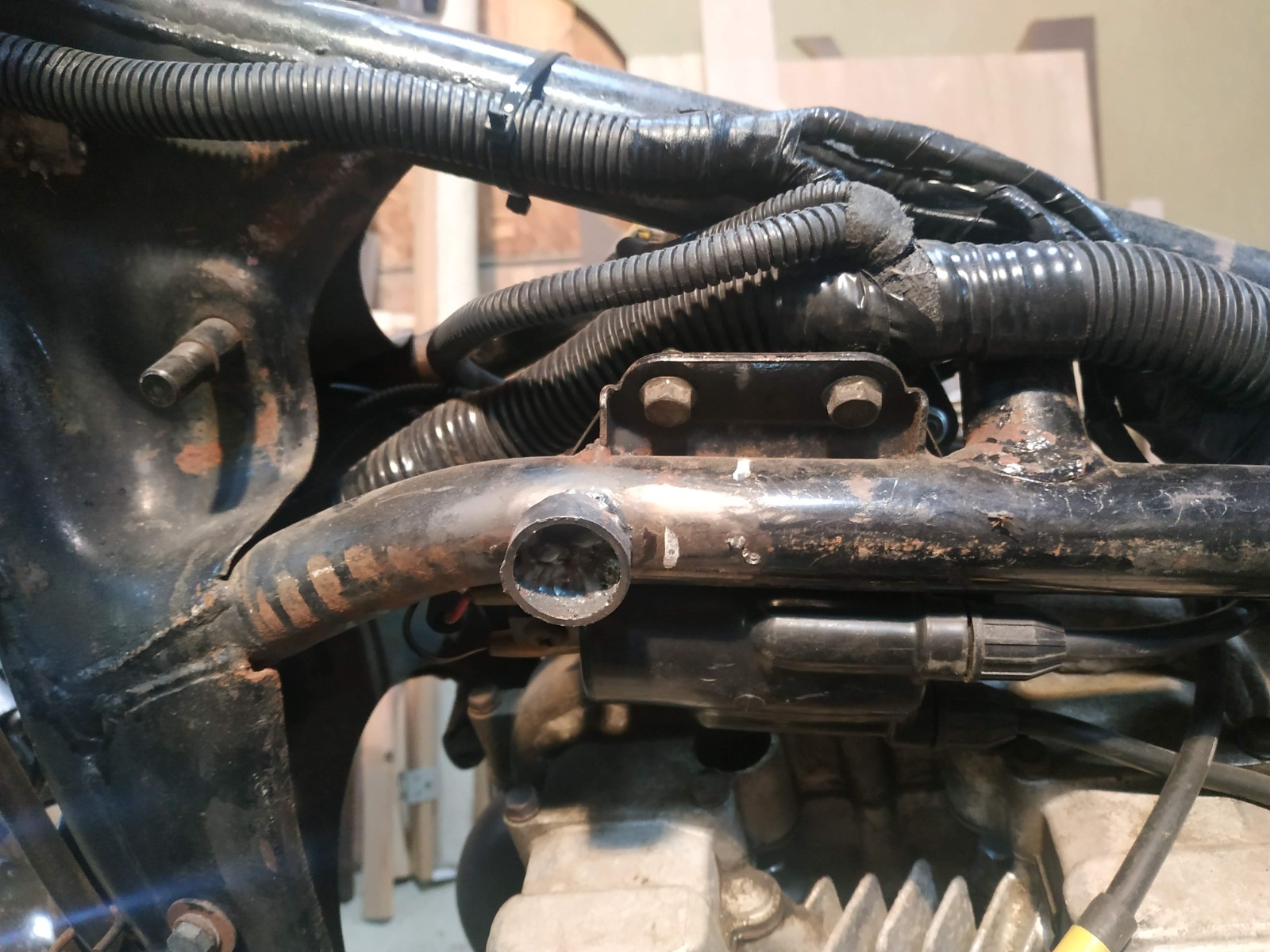

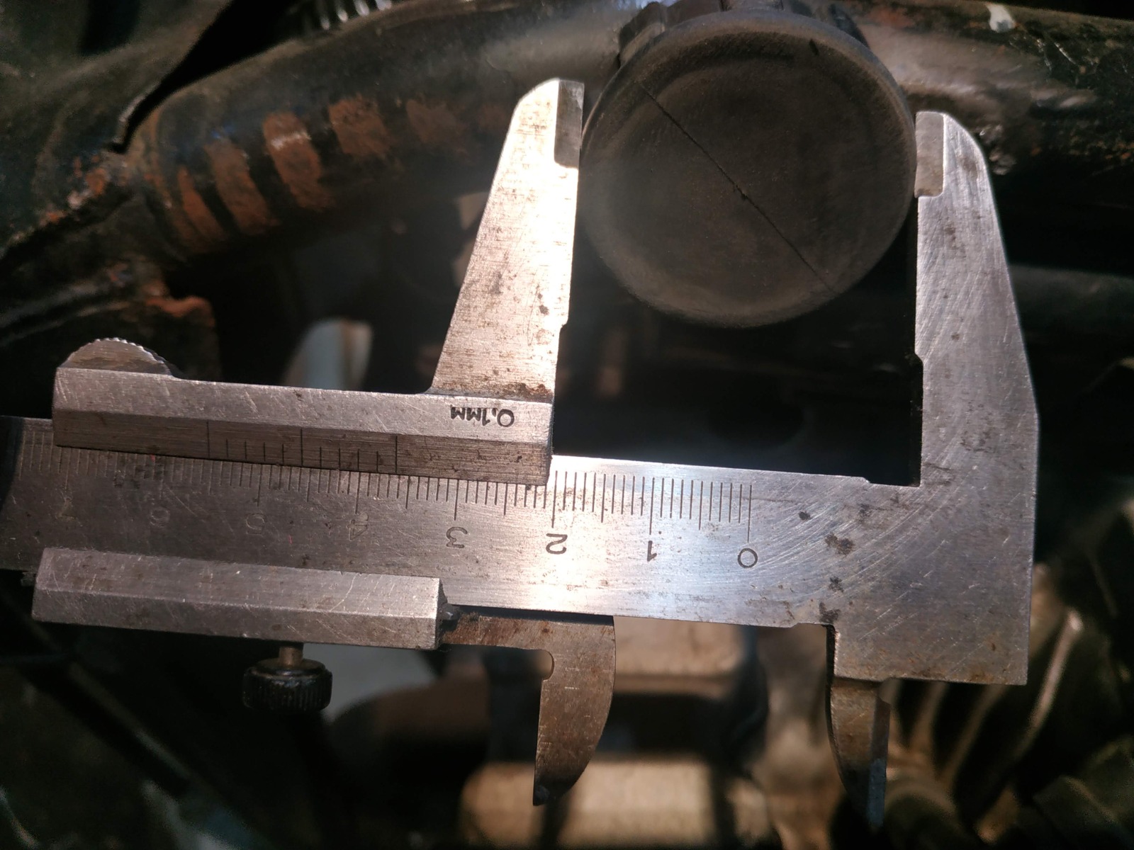

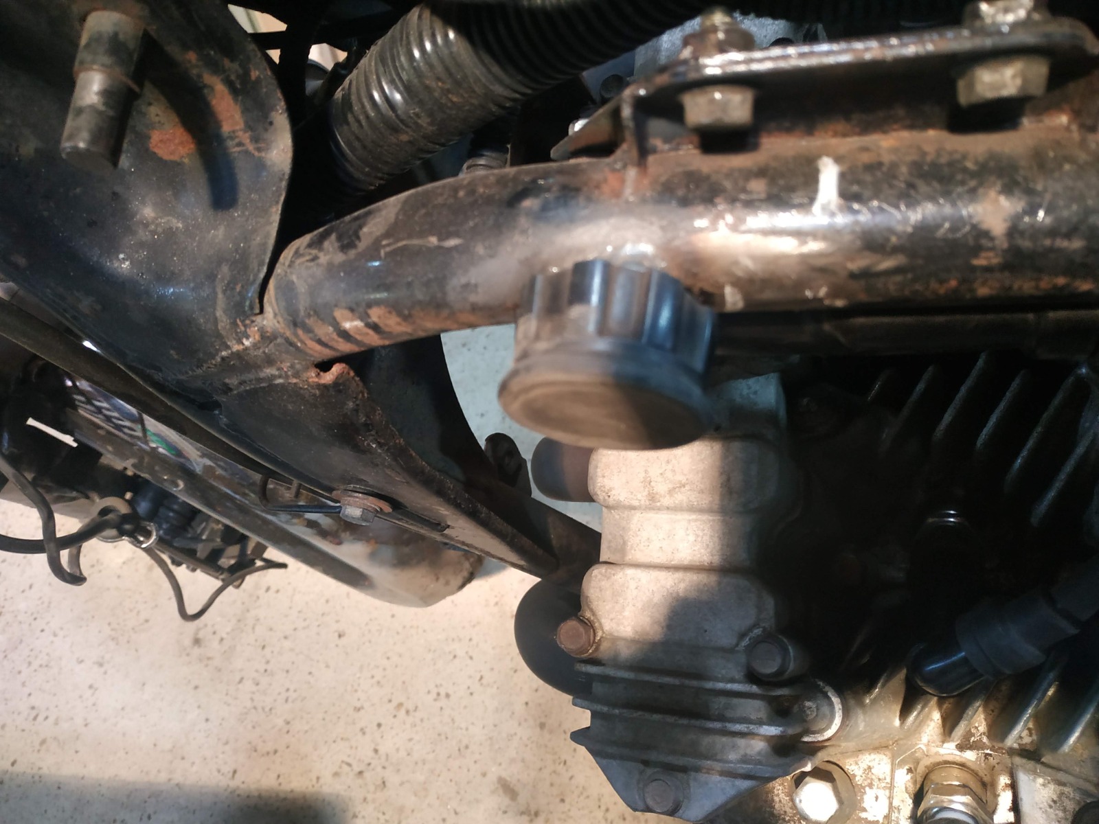

To install the Yamaha XJR400 fuel tank, you will need to weld 2 pieces of 25mm pipe to the frame.
The original tank attachment protrusions do not need to be removed.
Rubber damper 35-38 мм.
Weld the stud. Which makes it possible to fix the fuel tank in the hole near the seat.
Unfortunately, I have no idea how the XJR fuel tank will pair with the original KAWASAKI seat.
With respect, Roman.
