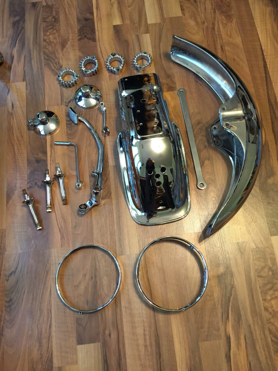

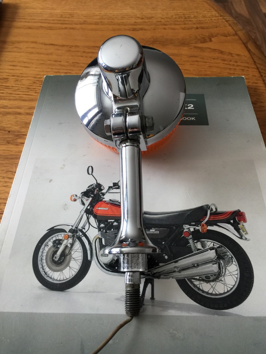

You can rechrome the turn signal pods and posts if you want to retain the Stanley stamps on them. I have a few set aside for the next time I go to a chrome shop. Or you can buy reproduction ones, or even used ones on ebay. Nothing wrong with a little patina!

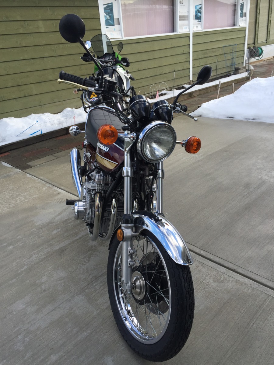

Note the right control on this bike for an original lever.

Hardrock. Great looking parts.
