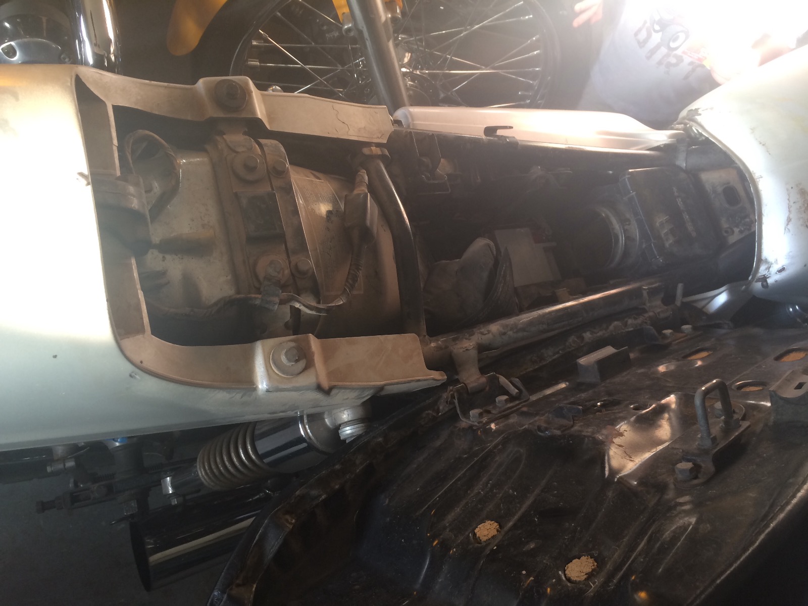

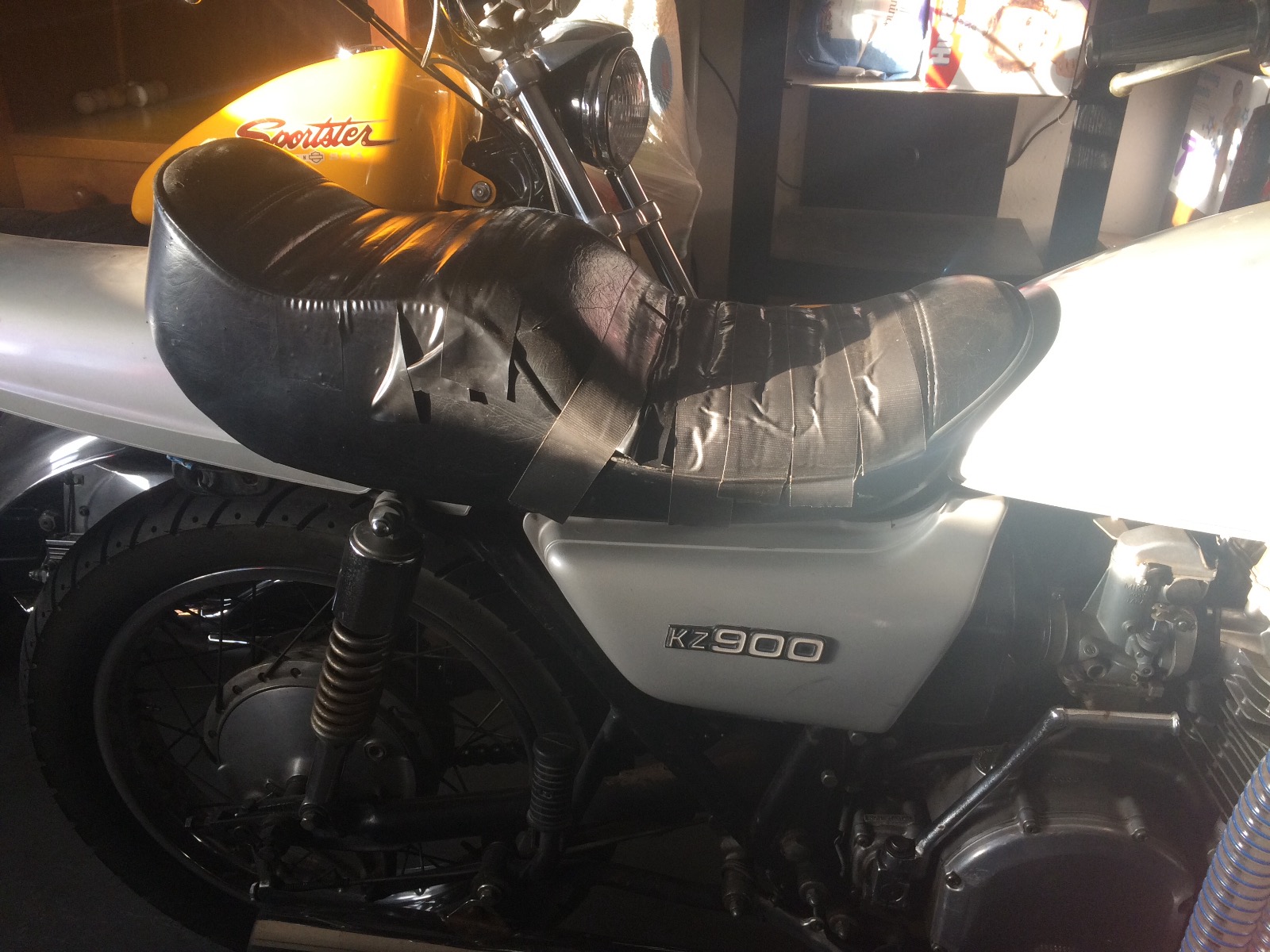

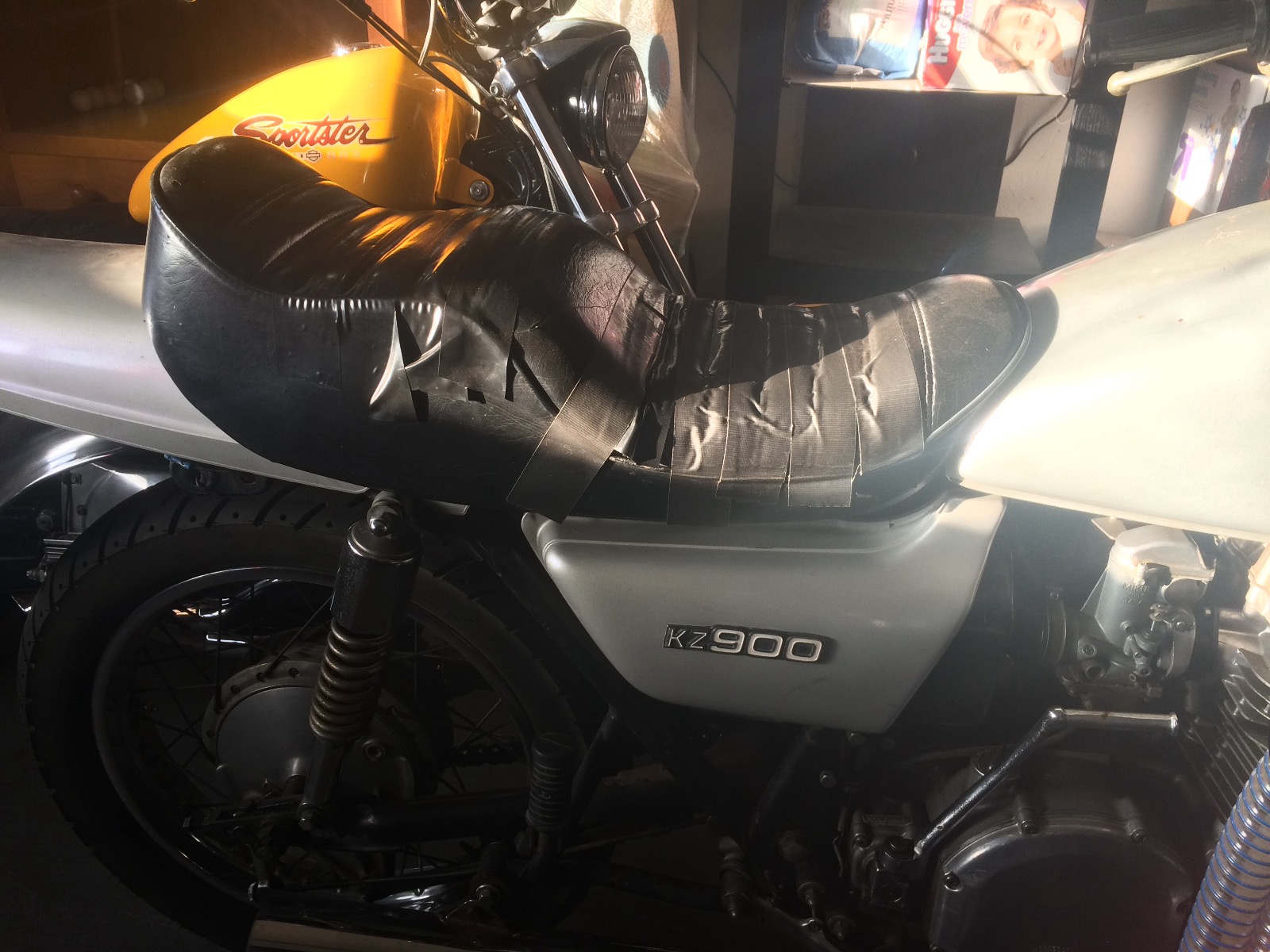

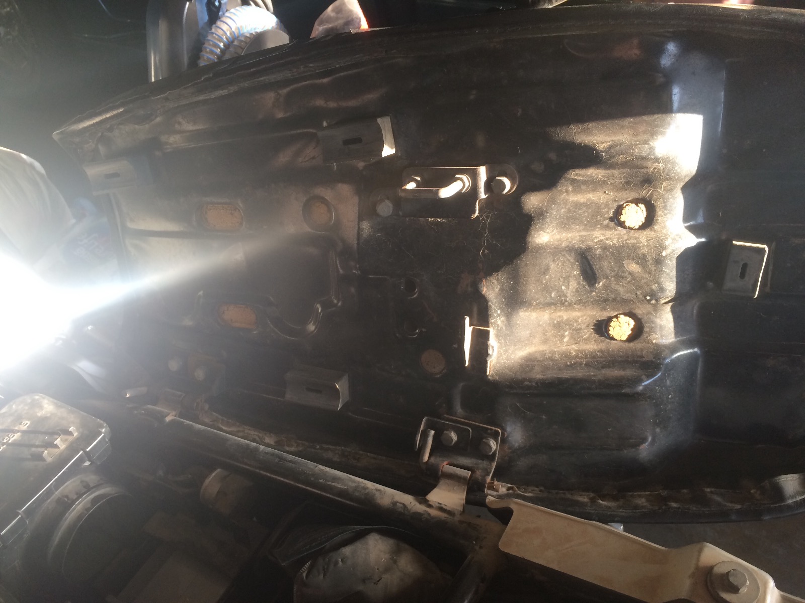

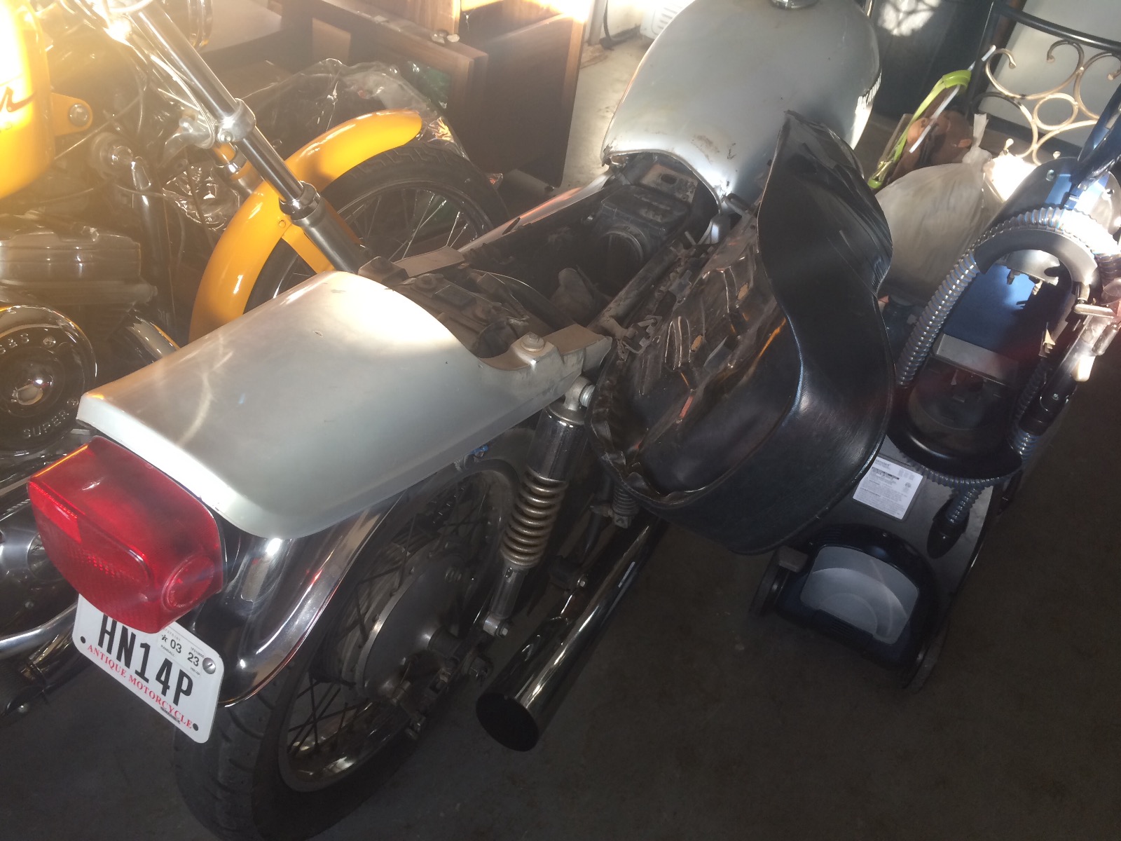

Snapped these of the seat situation real quick. Sorry for the crappy light sun was shinin thru. I’ll get some more flattering pics sometime I get a chance.

Appears to be a stock LTD seat
Stock seats for all KZ 900 or 1000s should fit
PS I fixed your pictures

The seat pan looks fine. Foam too. You should be able to just buy a new skin and replace the old one.
