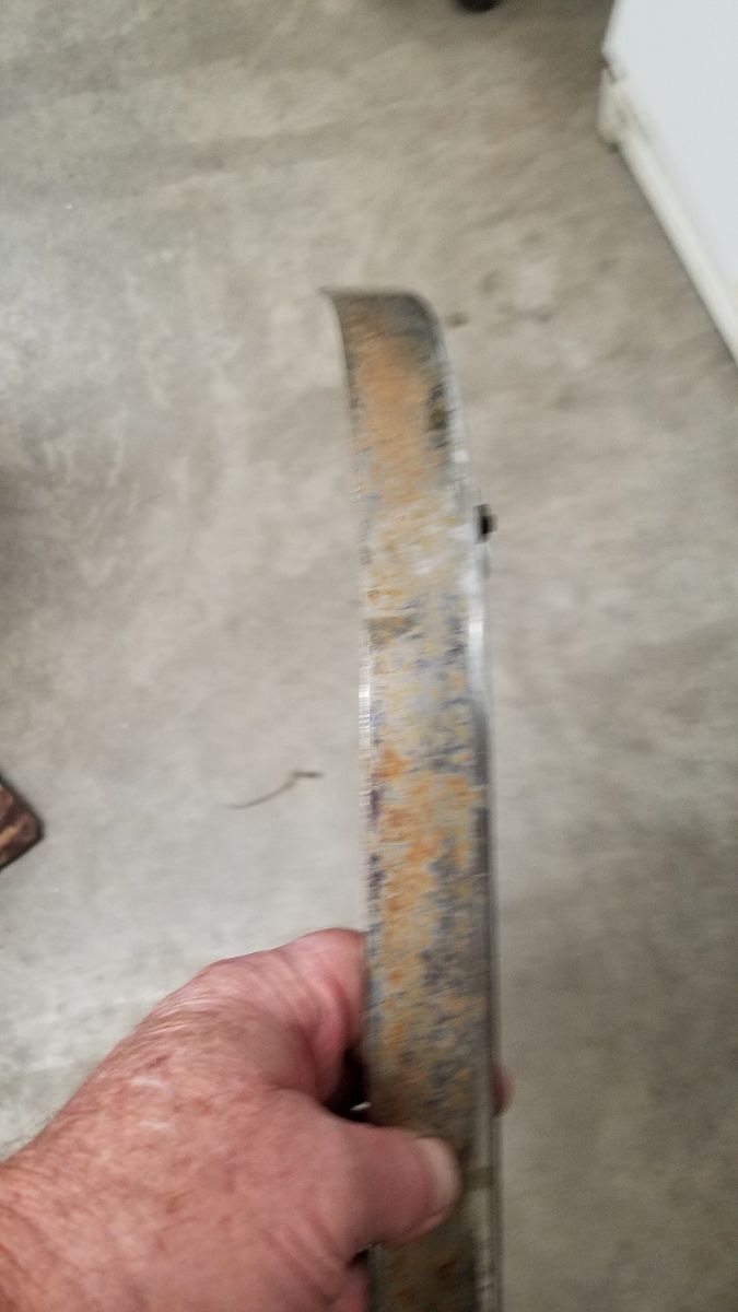

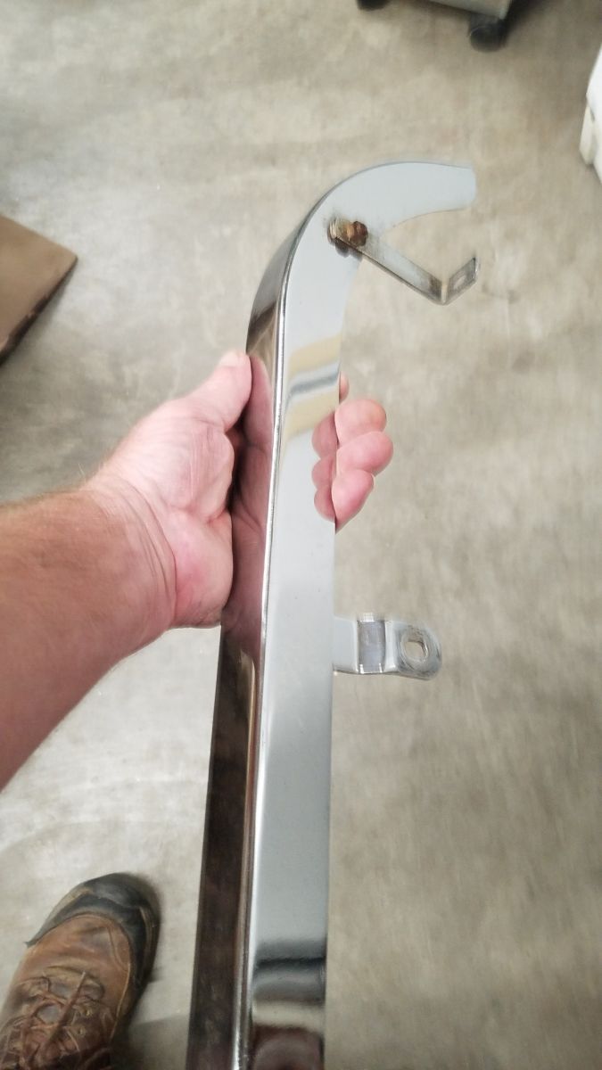

I told Honey Bunny its all natural and non toxic but she still wouldn't smell my finger!! She did show me hers though. its called Quick Glow. I have a couple of grades of this stuff Im down to use the fine next, soon as I wash it off. this I just wiped it off with a sock.

I just wish I could buff out superficial scratches on chrome, I never tried experimenting because I always need the parts.
Re: 5 minutes and 1 finger
29 Jan 2019 08:419er rider wrote: I just wish I could buff out superficial scratches on chrome, I never tried experimenting because I always need the parts.
Assuming the scratch is not just a mark on the surface of the chrome this is something that really cannot be done. The reason is that decorative chrome plating generally is no more than 2/100,000 of an inch thick. Being that thin it would be removed from the underlying surface before the scratch was gone. Ed
