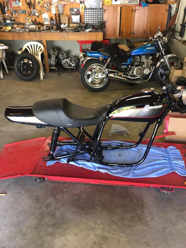

- Posts: 3122
- Thanks: 1232
Re: Putting a "duckbill" tail section and Z1 seat on a 81 Kz1000K1 LTD
28 Oct 2018 21:15

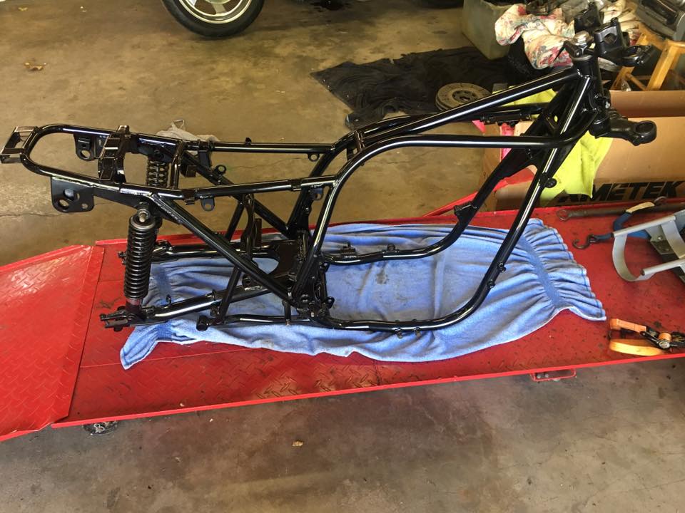

This is a '75 Z1. Unfortunately I have the tail piece on the bike now but the other photo shows the bare frame. Distance between the hinges is 24 cm.
The following user(s) said Thank You: old_kaw

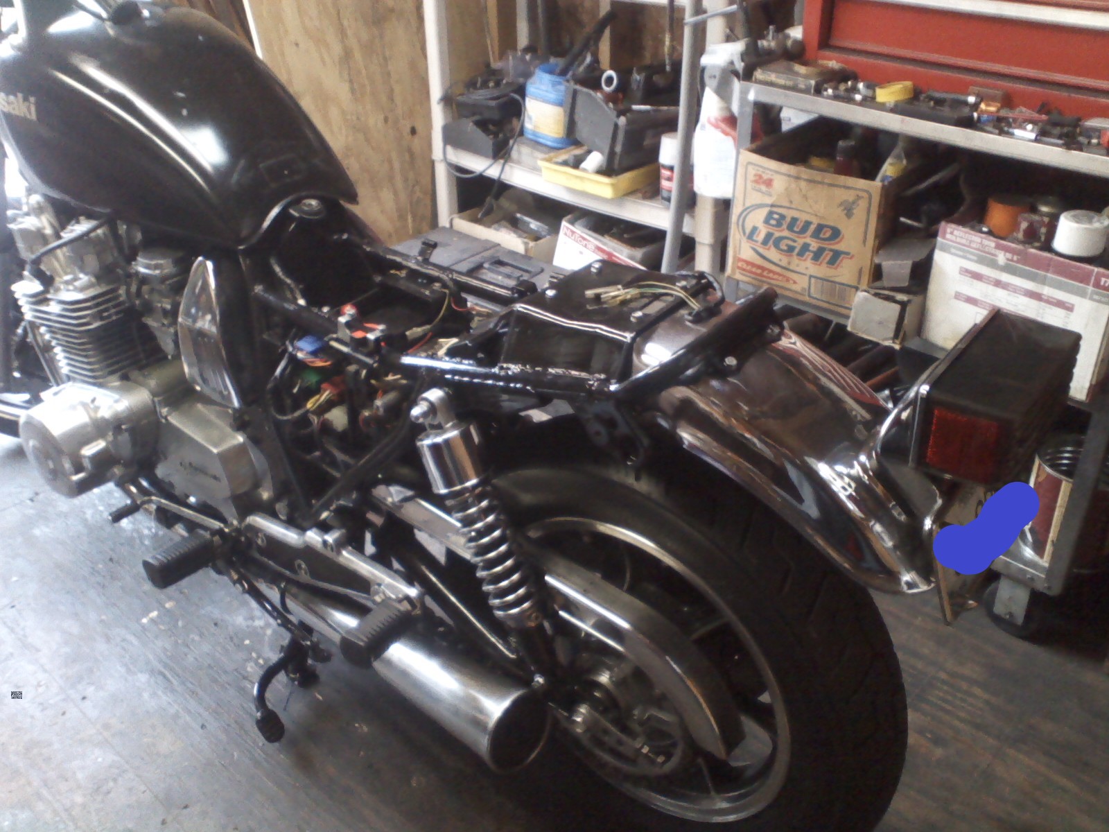

29 Oct 2018 11:05

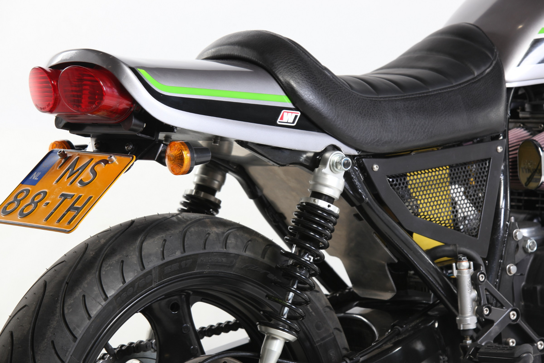

I put one on my CSR 1000. I bought a fiberglass replica from ebay,it was too narrow but being fiberglass I was able to cut it down the middle and widen it. Worked very well.No frame mods needed
29 Oct 2018 11:30I remember seeing this David. This looks AMAZING! You did an awesome job on this bike. I would like to use OEM parts if at all possible. Your body / paint / fiberglass skills are way beyond my skillset. I am more the cut weld type using oem type parts.
Also the tail light looks great, what is it off of?
29 Oct 2018 13:10
I had never fiberglassed before,this was my first attempt and it was pretty easy to be honest (though I did have a scratch on my finger that got infected,which wasnt fun).I think anyone could do it. If steelwork is your thing then understandable you would want to go that way.
The tail light is from a ZX9R. Keeping it in the family.
