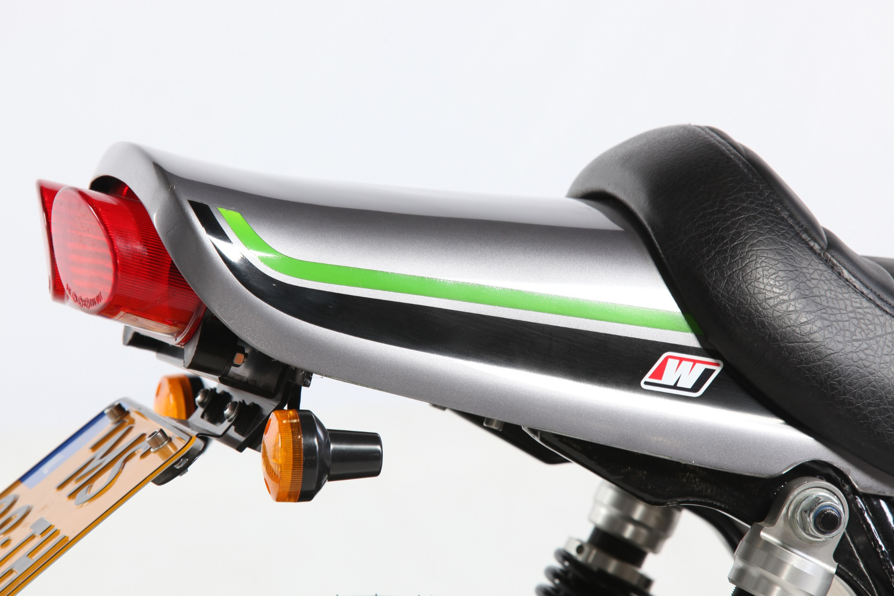

I always have liked the looks of the duckbill tail section on the older bikes, and then after streetfighter LTD pointed out a nice seat that Z1E sells for the pre 1980 bikes, I am wondering if I could use the Z1E seat with a duckbill tail section. AND, what is involved with adding one to my 81.
www.z1enterprises.com/seat-assembly-comp...-z2-z1-no-strap.html
I am hoping it would be fairly easy, but it looks like I need to accumulate the parts and do like I do with everything else, and make it fit. Has anyone done this on a later model J bike?

I think your frame is too steped for the seat to work. You'd have to sdd some mounting tabs for the bill to work.

Not sure what it would take Steve. I'm sure there are some Z1 frame pics on here somewhere. I'm not against doing a few mods, I just don't know how much yet. Too much cutting could be a deal breaker.

You may have to modify the back of the frame and change the tail light. The repops are fairly cheap.

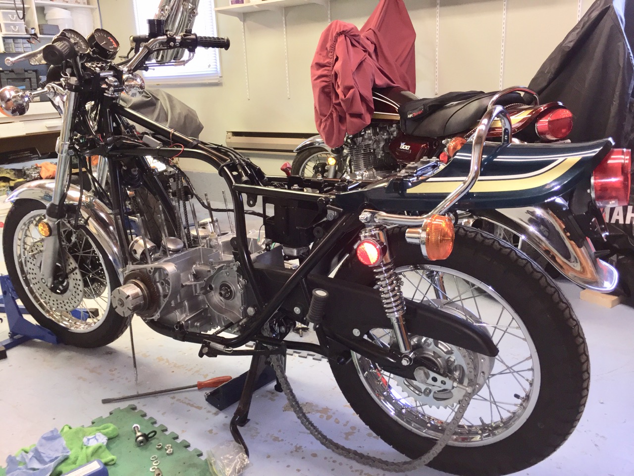

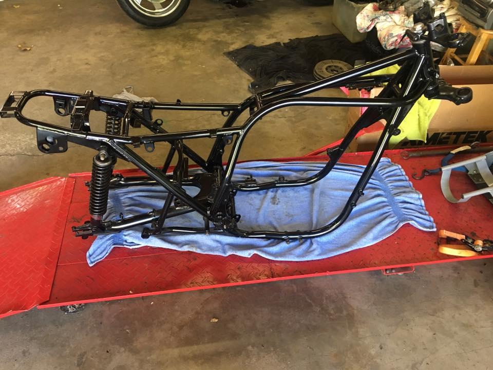

This is a '75 Z1. Unfortunately I have the tail piece on the bike now but the other photo shows the bare frame. Distance between the hinges is 24 cm.
The following user(s) said Thank You: old_kaw

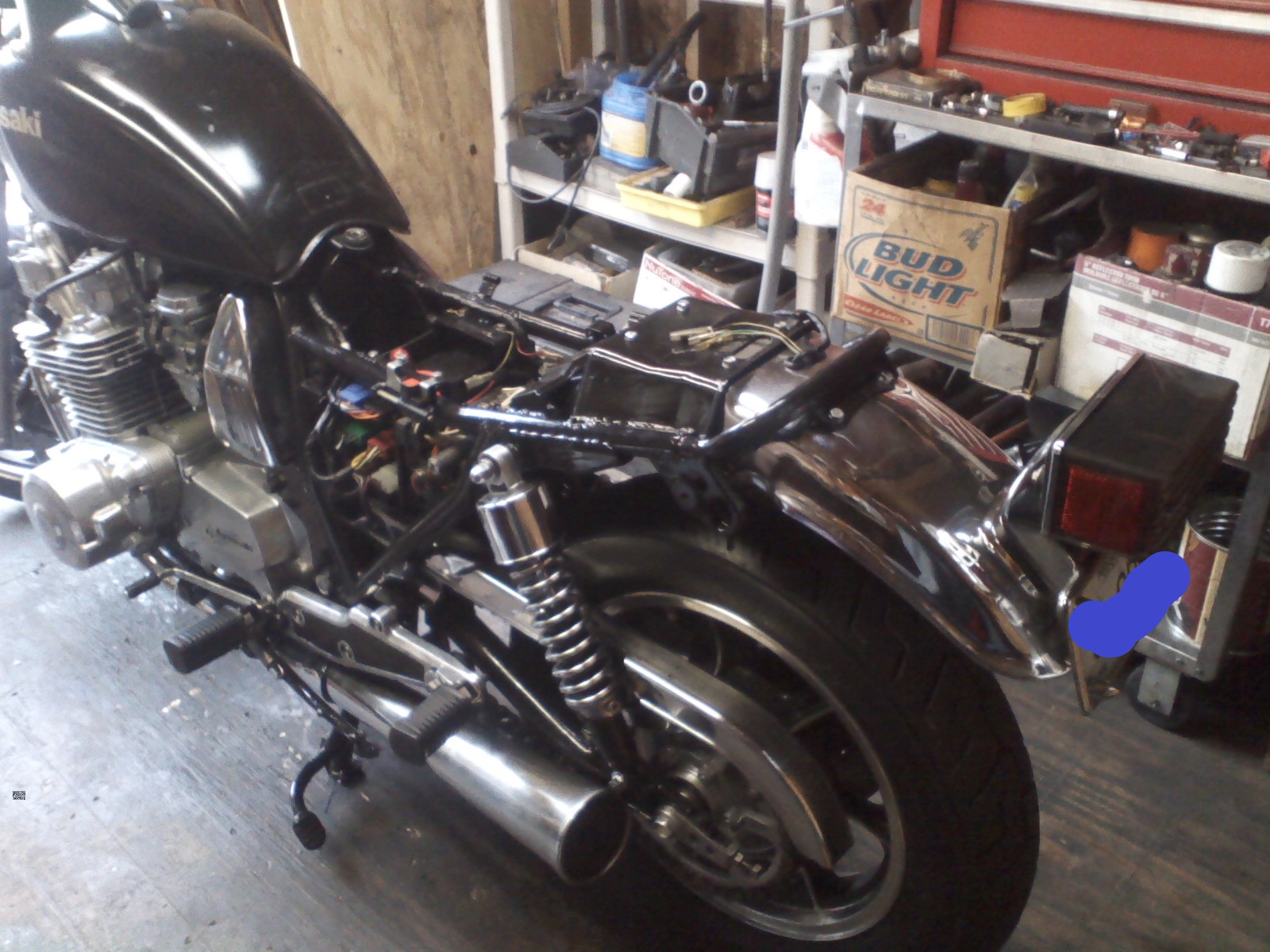

I put one on my CSR 1000. I bought a fiberglass replica from ebay,it was too narrow but being fiberglass I was able to cut it down the middle and widen it. Worked very well.No frame mods needed

29 Oct 2018 11:30I remember seeing this David. This looks AMAZING! You did an awesome job on this bike. I would like to use OEM parts if at all possible. Your body / paint / fiberglass skills are way beyond my skillset. I am more the cut weld type using oem type parts.
Also the tail light looks great, what is it off of?

I had never fiberglassed before,this was my first attempt and it was pretty easy to be honest (though I did have a scratch on my finger that got infected,which wasnt fun).I think anyone could do it. If steelwork is your thing then understandable you would want to go that way.
The tail light is from a ZX9R. Keeping it in the family.
