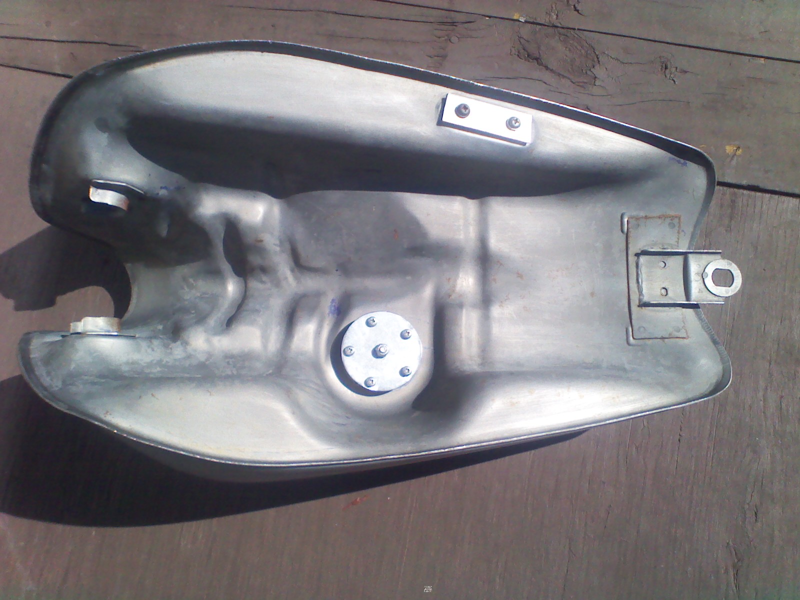

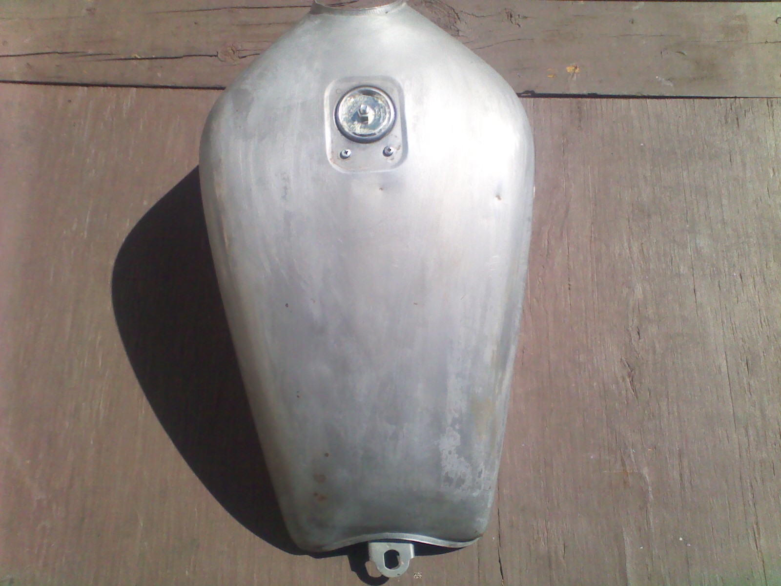

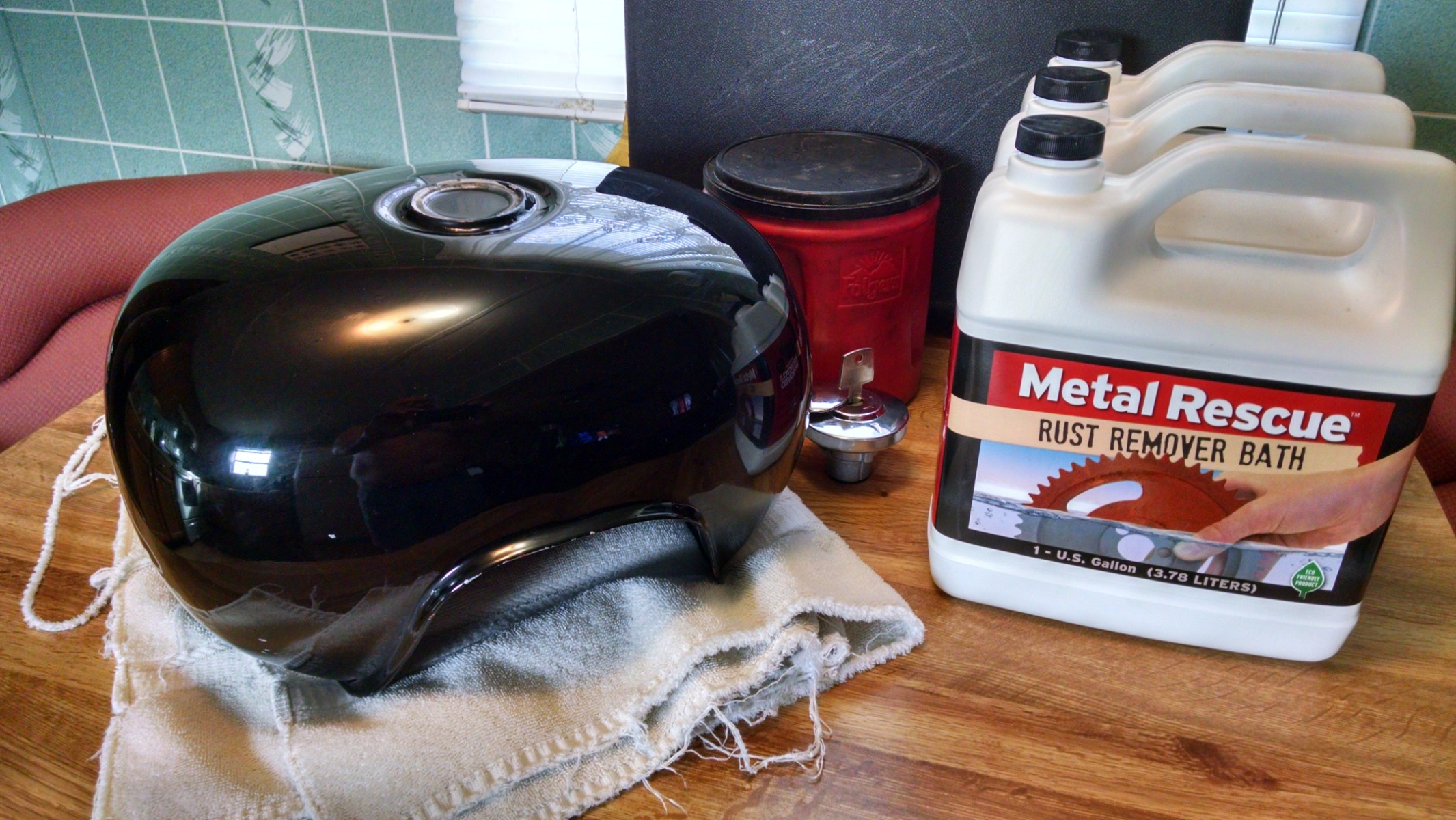

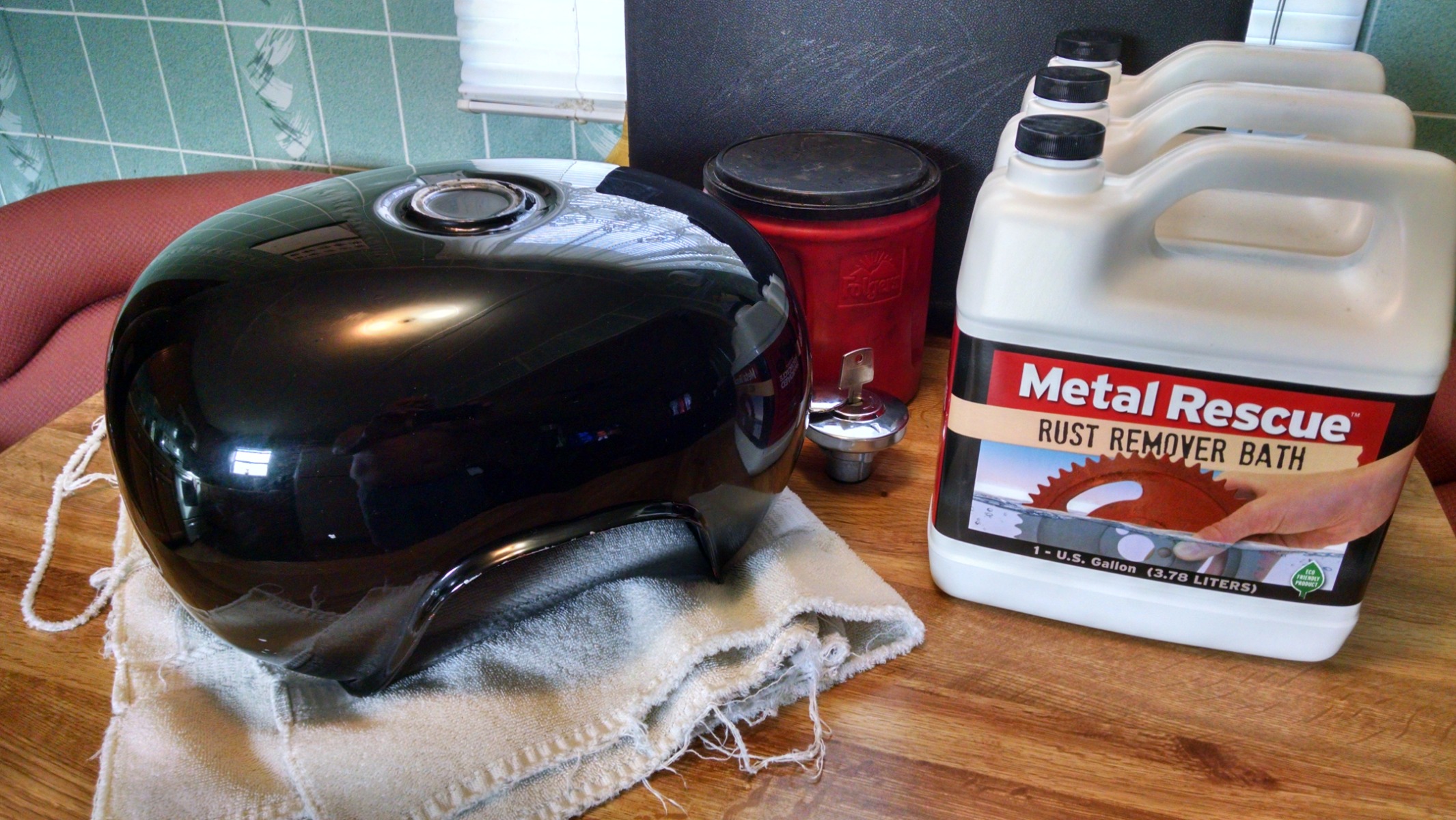

I've done the dryer tumble on several motorcycle tanks. I found an expanding rubber plug that fits my tank openings perfectly, and make up block off plates for all of the sensors and petcock. My old Kaw had a "kreme job" when I got it, and not a nice one either, (if there is such a thing). I first tumbled it in my dryer with a gallon of MEK and 50 drywall screws in it for half an hour, then I turned it around 180* then rotated it another half an hour to hit the "other side" inside the tank to remove that nasty white crap. (aka liquid death) I wrapped it in a puffy sleeping bag, then packed pillows around it so that it could not move inside my dryer, allowing it to beat a bunch of dents in it.
Definitely remove all of the senders and petcock etc.

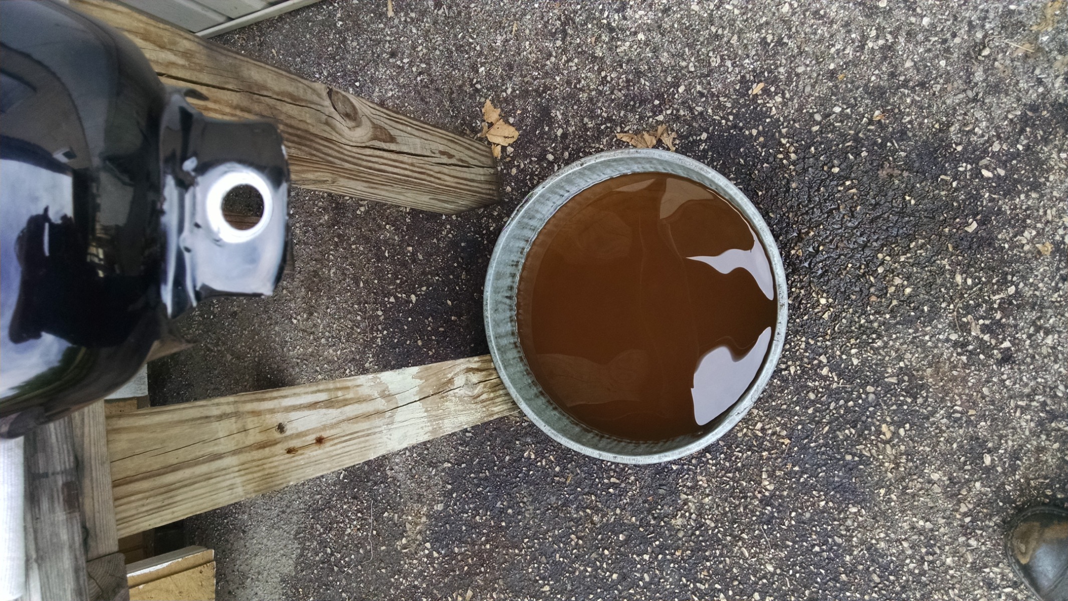

I then filled it with metal rescue to remove all of the rust that the kreme had sealed in. (This is a Honda VT600C tank):
Just a water rinse is all that's needed with the metal rescue. (I think you could drink the stuff lol) This stuff starts out clear. This is the iron oxide that the metal rescue removed.:

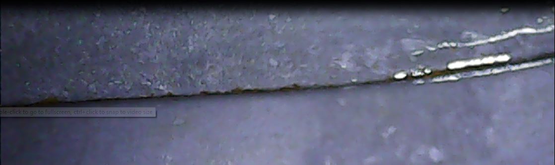

5. Turned the tank around time to time for approx. 1 hour, checked the tank and it was really good some left only.
6. Turned the tank around for approx. 1 hour more, an the tank was even cleaner, now it was only corrosion where the plate end, where they meet each other in the front of the tank, please see picture below..
7. I let the tank stay in acid for approx 2 hours more, but the tank was not more cleaner...
8. Flushed the tank with hot clean water and then cold clean water..
9. took out all water and added Isopropanol, and dumped it out again..
10. sprayed 2 boxes of WD-40 and turned it around.
11. dried the tank...

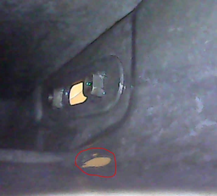

Here can you see the last corrosion who is left I think?
What is these?

Looks good. Maybe that spot is not corrosion? Chunk of varnish? Can you reach into the tank with a bent rod or something and try scraping at it?

21 Feb 2019 05:16Nessism wrote: Looks good. Maybe that spot is not corrosion? Chunk of varnish? Can you reach into the tank with a bent rod or something and try scraping at it?
Will try doing it, with the spot.
What about the corrosion left between the plate in the botton in front, mostly on one side? Just leave it?

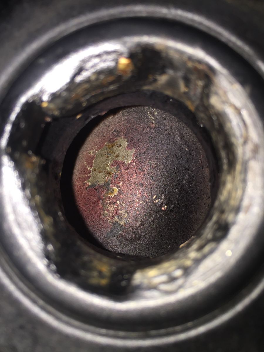

21 Feb 2019 07:45 - 21 Feb 2019 07:47
Yes, much better
What about corrosion and whole in the tank? Should I try to take the small piences rest of corrosion?
Maybe just take a need session in some years?
I din’t thing it will be any issue now? Have inlet filter in the tank and outside.
I want to have the tank for many years, maximize the life of the bike...
Here is a picture from the first time cleaning it with acid when I got the bike 2-3 years ago.

22 Feb 2019 08:57 - 22 Feb 2019 09:00gordone wrote: Yes, much better
You may want to cut down on the caustic chemicals there Gordone. There are other things out there that will remove the iron oxide without eating the metals in the process. That filler neck is so eaten up that it looks like it is two fill-ups away from crumbling into the tank.
But HEY! All I can do is suggest and tell what I have used successfully on numerous tanks.
