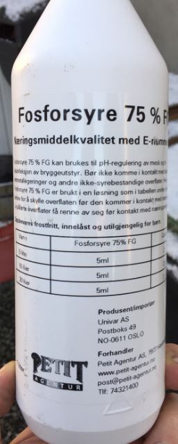

Thank you all, I have heard many good thing by using phosphoric acid also ?
Use water to mix it to down to 30 % ?

Re: Condition inside the gas tank
12 Nov 2018 14:46
The POR15 tank prep kit has a 23% phosphoric acid solution, so you have to add 2 Liter of water to your (1 Liter) 75% phosphoric acid for the right mixture.
