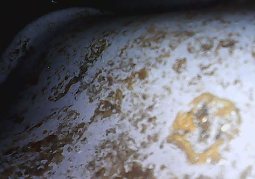

Looks like the tank still needs a little work. A very nice start though. The brown spots are either rust or fuel varnish. I'm not sure which, but it's critical for you to figure what they are because the process for removal is different. For rust you just need a little more time with the phosphate sauce. If they are varnish then you need something like carb cleaner to break through that.
Good luck and keep going...

I would put some handfull of little nuts or steel marbles with phosphate acid into the tank and shake him like hell to loosen the rust particles.

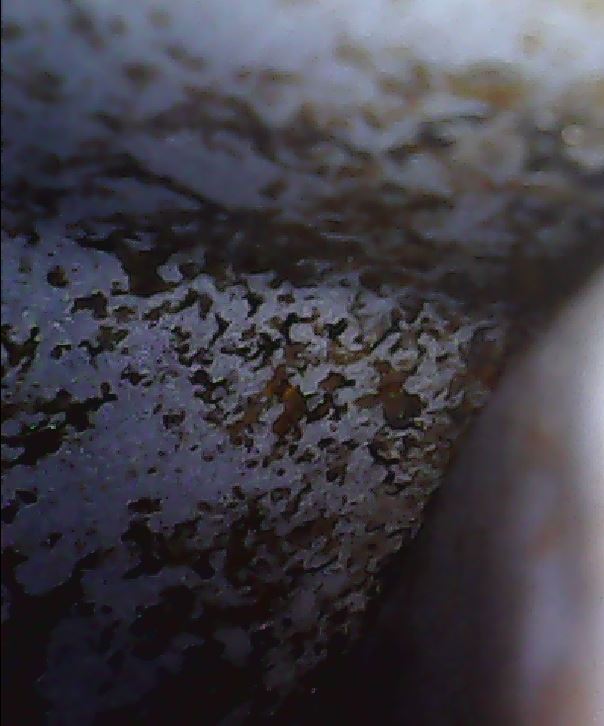

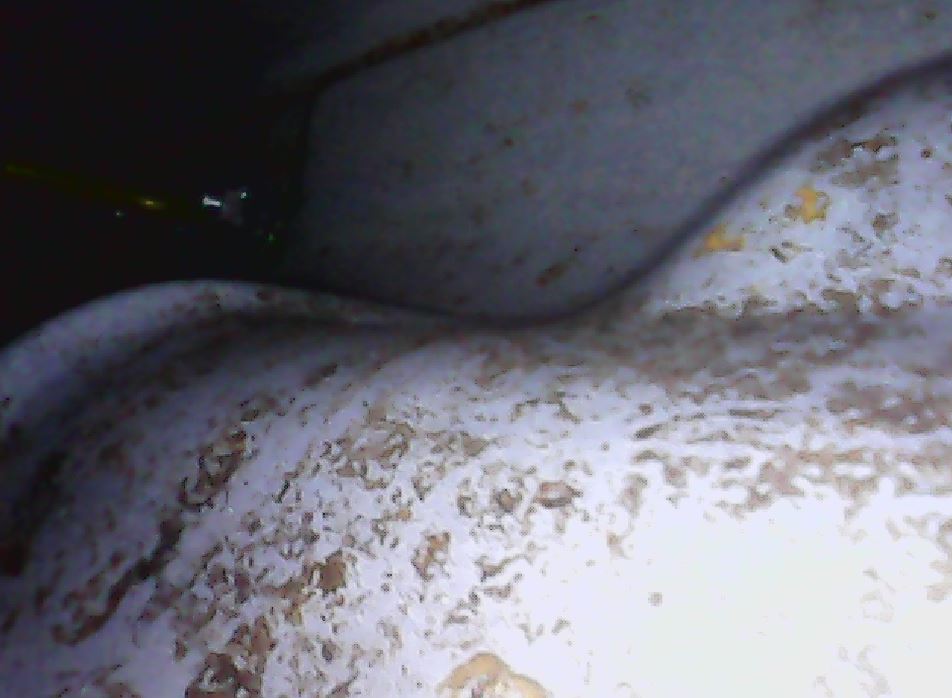

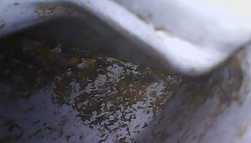

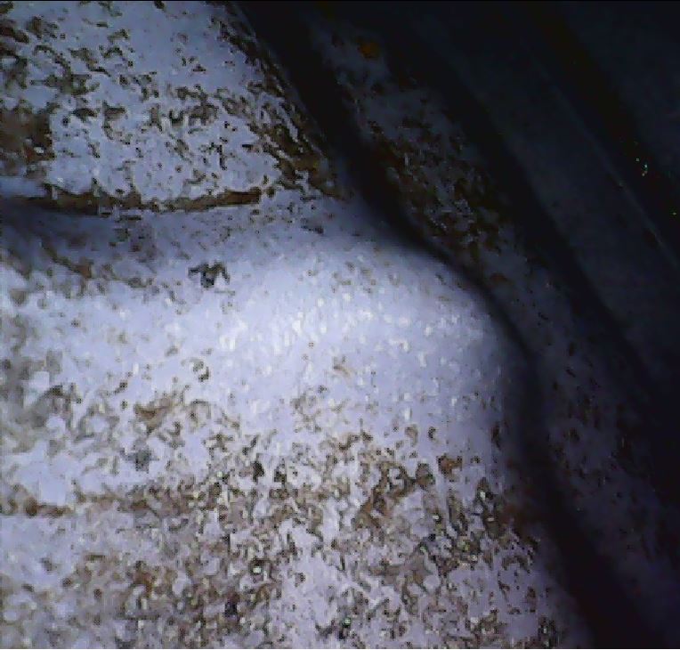

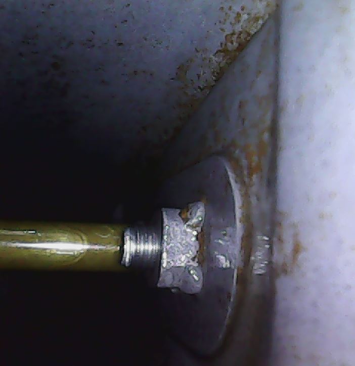

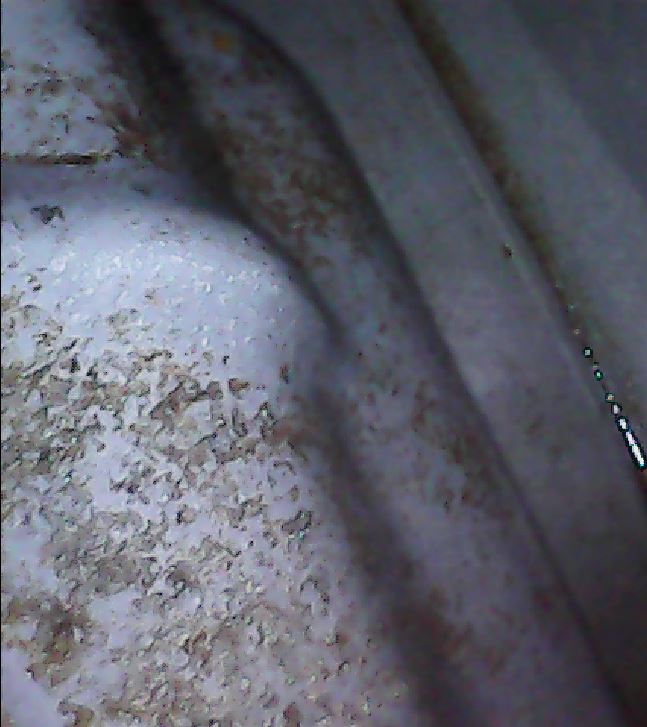

Point 1.
Condition inside the tank, old gas ? corrision?
I have tried to take some better videos and photos, please see below:
Videos:
streamable.com/s2bu7
streamable.com/939zf
streamable.com/d8mgv
streamable.com/jn9tf
streamable.com/f3e1w
streamable.com/75whq
Photos:
Point 2:
For me it looks like a combination of old gas and corrosion ?
I`m afraid I damage the nice painted surface on the outside using nuts and small metals parts to remove the corrosion on the inside?
What todo ?
1. Carb cleaner ? just spray all whole box inside the tank and then what ? must I do some mechncial to remove it ? or can I just turn the tank around same as with the Acid ?
2. Flush the tank with clean water ?
3. Add Acid again, 30% or go higher ?
Thank your for your advise !
Maybe a stupid question, but what do I gain by getting the metal 100% clean from corrosion and old gas ?
Will the corrosion of the metal go slower and the tank will be fine for longer period ?
After I installed a inline fuel filter has the big gone smooth for a season.
Thank you all for your advise and input !

Re: Condition inside the gas tank
14 Feb 2019 04:47 - 14 Feb 2019 04:49Nessism wrote: Looks like the tank still needs a little work. A very nice start though. The brown spots are either rust or fuel varnish. I'm not sure which, but it's critical for you to figure what they are because the process for removal is different. For rust you just need a little more time with the phosphate sauce. If they are varnish then you need something like carb cleaner to break through that.
Thank you, me plan is try both carb cleaner and acid.
Carb cleaner, will purchase two boxes today, and just spray all inside the thank, can I just roll the tank around? Not need mechnical clean it with a brush or something? Don’t know how to get access? After just flush with water?
Acid, shall I just go for 30% mix these time or higher? For how long time? Just investigate with camera under the process?
Thank you.
