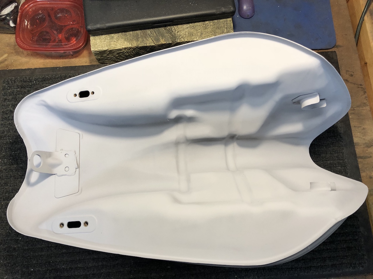

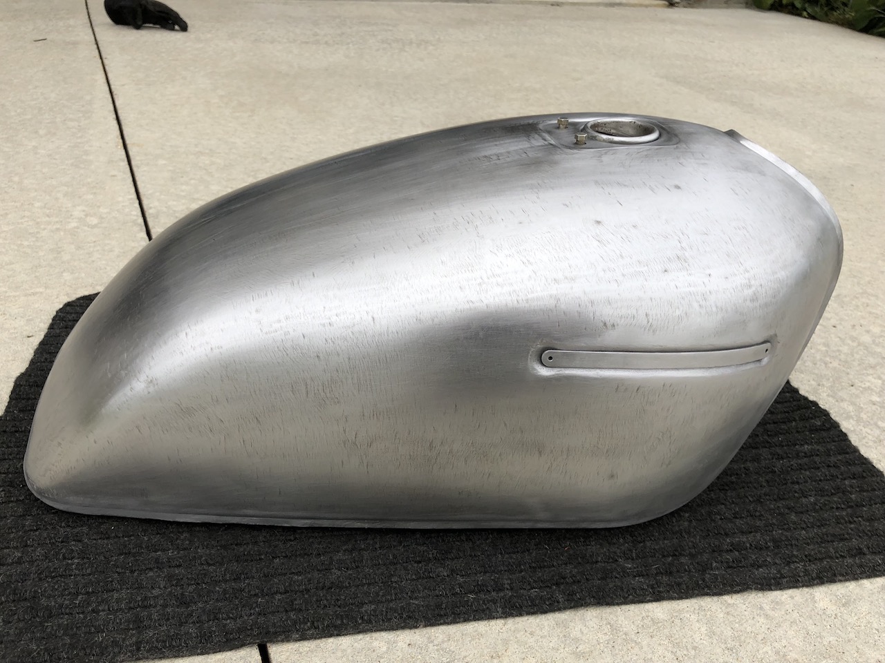

Ironically I am stripping the paint off the tank that came on my 81 kz750e. I got it out of the basement to clean up so I could sell it, but the paint job the previous owner had done was starting to craze and I wanted to know what lurked underneath the paint. The inside it still shiny metal and I can't see any rust or rust patches, but I want to know if it has any bondo in it before I sold it to somebody. ( I have also been stripping the paint off my spare zr550 tank I got years ago and found a deeeep dent as big around as a softball that was full of bondo. So it got me wondering what lurked underneath the crappy paint on the kz750 tank.)
I have no idea what your budget is for a replacement, and just the shipping may be more than you want to spend overall. But if you are interested, I can let you know how good the tank is once I get it stripped and we can talk further.

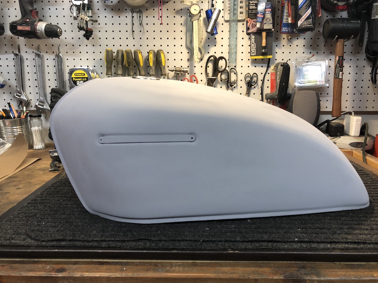

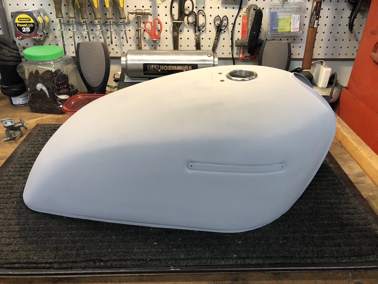

I stripped the tank all the way down to bare metal to find absolutely no dents or bondo. But whom ever painted the tank before I bought the bike used an aggressive flap wheel to sand the factory paint off and left deep sanding marks all over the tank. So I gave it a coat of metal etching primer and a coat of filler primer that totally covered all but the deepest of scratches. It needs a lot more sanding and primer, but we have already gotten snow flurries up here, so my garage is too cold to apply more primer to get it close to perfect.
The inside is full of 30+ years of gas shmutz but no serious rust spots of any kind.
It does come with the fuel level sensor and petcock, but both need new gaskets to be leak free. I think I have a decent fuel cap for it as well, but am having trouble locating it.
I can sell it to you including shipping for $75 or a bit more if you need the fuel cap as well. Let me know what you think.
