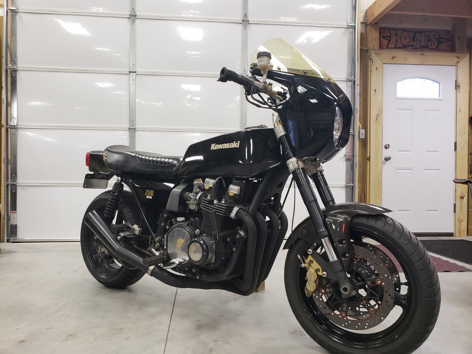

after getting the R1 front end mounted and some shakedown time,(and a discussion with an OHP about old bikes with modern suspension.i got caught tipping up out of a corner at 89 mph :blush: )
i set some time aside (yeah right i just put everyone else's stuff off and used working on my own bike as therapy :evil: )and made new brackets to get the Z1R fairing mounted.

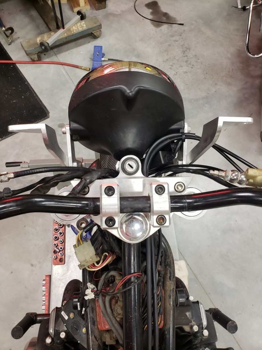

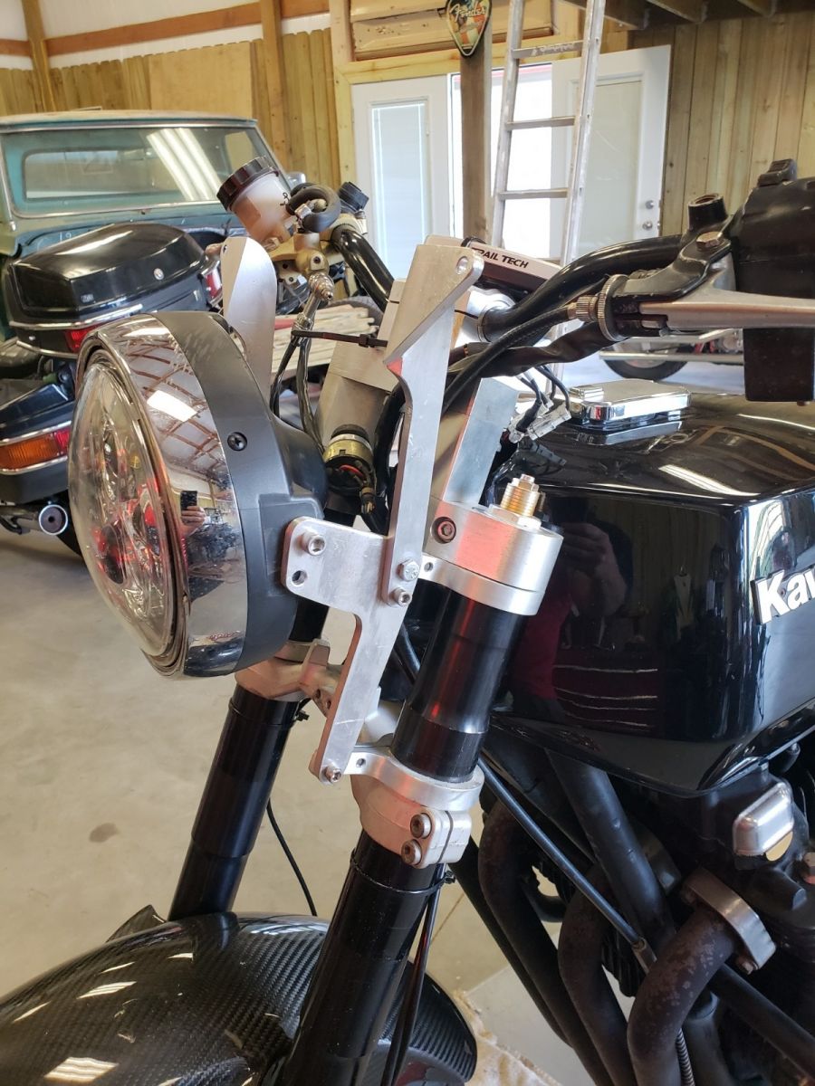

i scribed out brackets (after making cardboard templates)on some 1/4 inch thick aluminum,cut them out with the port-a-band and filed and sanded them to the scribe lines.
i was able to use the fork clamps i had already made to hold my headlight brackets,to hold the new brackets that relocated the headlight and gave me a place to bolt the upper fairing mounts.
my old headlight mount had the key switch mount in it.so i made a new key switch mount that bolted to the bolts that hold my bar mounts on under the upper triple clamp. .
i still want to lower my headlight a quarter of an inch to get the headlight sitting exactly where i want it in the opening.
but i am very pleased with how it all worked out.

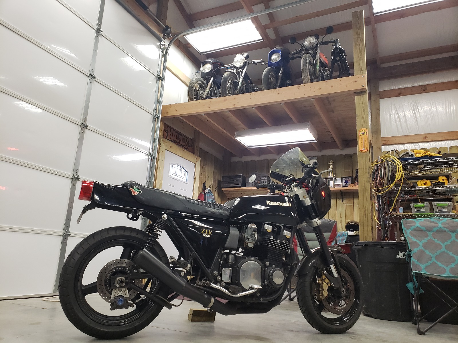

Re: custom brackets to mount my Z1R fairing
15 Aug 2018 10:21
Fine work as always.
BTW, how do you get those bikes down? Elevator?

- Posts: 7442
16 Aug 2018 09:01
i used a beam across two rafters and an electric hoist to get them up.
i have since acquired a walk behind electric forklift.
so,
that will be how i get them down
so,
