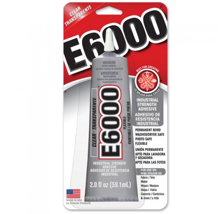

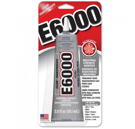

Ran across this on the internet E6000 ? Anyone used this stuff ?
Saw on a Video that it looked like it worked well on cracked panels.
It seems like JB Weld Plastic Weld doesn't come in a "clear" version ?

04 Apr 2018 05:23Sorry, but I have no experience with that stuff. Most likely fine. I'd do some more research before trying it though. I used 3M DP460 epoxy.

04 Apr 2018 11:35That stuff says it works on ABS and it looks very similar to a 2 part product I used on a side cover years ago.
I am not using the same side cover now but it never failed in around 30,000 miles of use.
www.kzrider.com/forum/6-paint-a-bodywork...-cover-repair#511272
