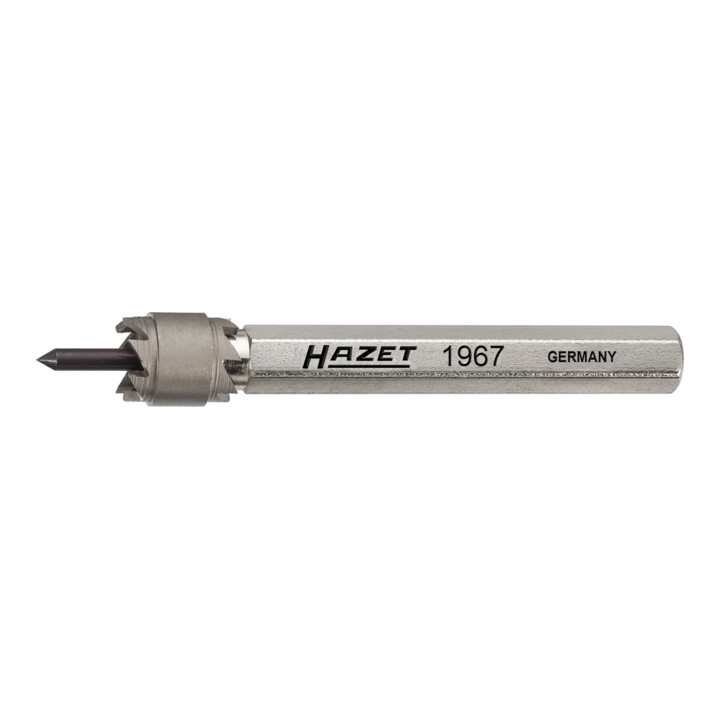

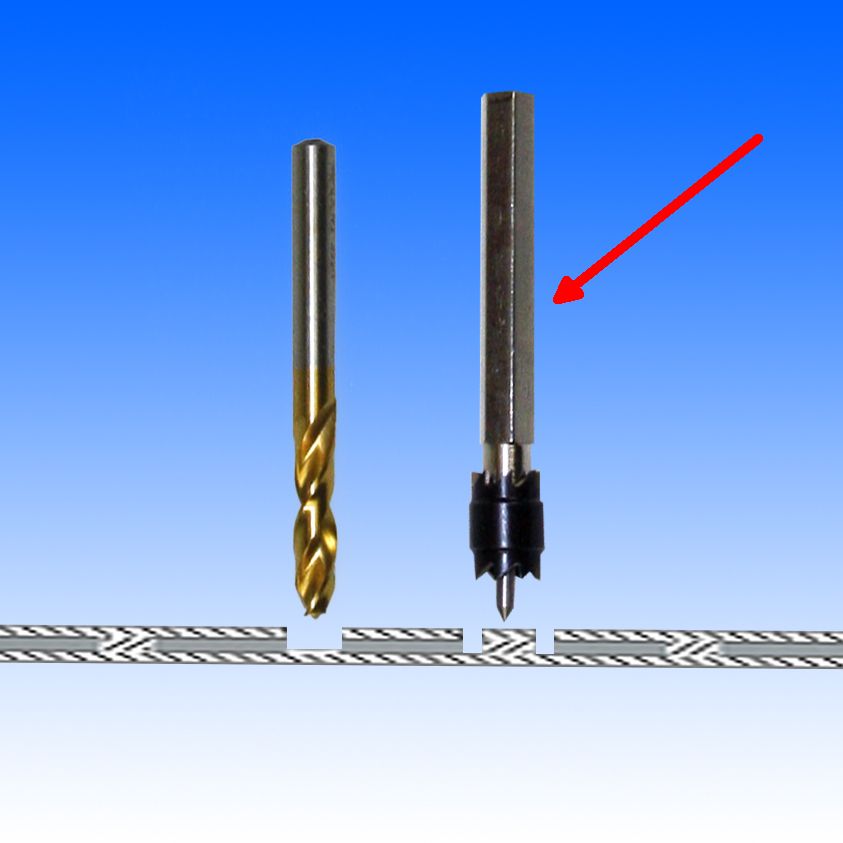

The dot welded strip for the screws can be (must be) removed with a special drill. You only have two dot weldings to remove.

Why would you remove the metal strip?
Those bits are designed to go all the way thru.
Do you trust yourself not to blow thru the side of the tank.
What is it like on the inside?
Is the seam at the bottom in the same condition?
The area where the badges fasten to?
I have use epoxy to fill similar holes before.
Just DO NOT remove any more of the base metal.

From what I have seen the "J", ELR and GPz have the same top with a different bottom soldered on.
I had to switch to a B2 tank when I swapped to carbs on my B1. If you try to drill out the spot welds
on that metal strip for the badge. You will more than likely end up with some more holes in the tank.
If you have any welding done both the inside and outside need to be cleaned down to base metal
especially for TIG. Use wire brushes and Scotch Bright pads on your favorite rotary tool.
