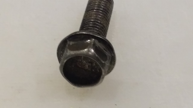

Does any body know what kind of plating it is on the fasters on a Gpz?
I guess its black zink, cos its not black oxide or black chrome.
// Anders

Not sure about all the types but I've seen zinc with black or green chromate. I've got a Caswell's Plating zinc kit and have some black chromate. It works well but the finish is dull, not shinny like the OEM parts. Better than nothing though.

Pretty expansive these kits, for some pretty basic chemicals, but you are happy with how they performe Ed?
If the zink is dull it could be Black nickel, but then again not as a nickle plating should be thicker an sturdier.
I really would like to pep up my bolts and nuts.
/A

That is a zinc chromate finish and it is a sacrificial coating just like cadmium or regular zinc. Zinc chromate is a finish used in the aircraft industry as a corrosion inhibitor. I use almost all of the original hardware on the bikes I restore and I have used the Caswell kit for over 4 years and the results are equal to the plating places you send your stuff to for zinc plating. The level of shine on the particular fastener is determined by the finish it has prior to plating. I chemically strip all of my hardware so the edges aren't softened, then give a quick buff with 0000 steel wool and plate. The brightener that comes with the kit will give a shine almost like chrome if you want. To reproduce the finish on the dark green Kawasaki hardware I strip and plate like normal and then use the black chromate. The shade of green is determined by the length of time you leave the piece submerged in the chromate bath. If you leave it in for a minute or more it will be black but if you take it out after about 30 seconds it will be dark green. A poster above said he didn't get good results but that can be from a lot of different factors. I have a lot of experience with my plating kit so I get very good results.

Just to be clear, hardware plated with the Caswell's kit will come out bright and shiny if you get everything just right: proper amount of brightener added, proper current for the number of parts in the batch, and the electrolyte balance is just right. Main problem is the last part and I can't explain why but sometimes the parts come out amazing and other times they are dull, and the reason is the electrolyte sauce. Even if the plating turns out dull it's easy to bright it up with a soft stainless steel wheel on the part so no crisis though.
There are various type of chromate dips: yellow, black, green, and blue. Blue is for bright plating and in effect, is clear. The chromate increases the corrosion resistance of the zinc, even the blue that you don't really see the color. A bright and shinny part dipped in the black will come out dull. There is no way I've found to make a shinny black part with the Caswell's kit.
