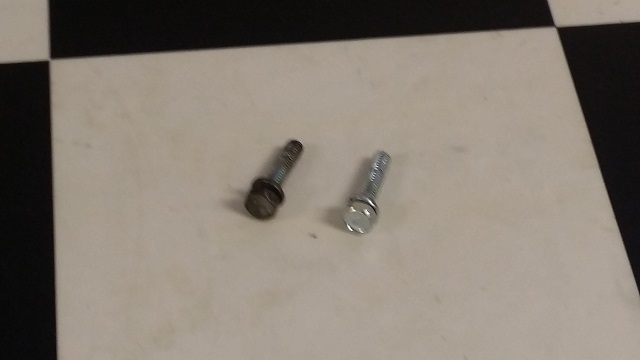

So I ended up buying a plating kit from Gateros Plating in the UK,
www.gaterosplating.co.uk/
pretty pricy at 55 £ considering what you are actually buying. Everything except the passivation chromates can easily be obtained locally, but without the passivation chemicals I am getting nowhere. So I bought their 5L kit and supersized it with olive drab passivation with extra darkener.
With a staggering 40 £ shipping to Sweden it came out quite expensive.
Anyhow today was the day to do a first test run.
• Wire brushed a couple of M6 bolts, nuts and washers
• Soaked them in naphtha based degreaser, brushed with a nylon brush, rinsed in scolding hot water.
• Soaked them in warm sodium carbonate as an alkaline degreaser, brushed with a nylon brush, rinsed in scolding hot water.
• Soaked them in the Heavy Duty Alkaline Cleaner that came with the kit, really aggressive stuff that started the metal to fizzle, quick dip in clean water.
• 30 second dip in the Acid pickle that came with the kit (Sodium hydrogen sulpahte) pretty strong acid that instantly makes the hydrogen start fizzing from the metal, quick dip in clean water.
• The into the Zinc electrolyte running on a reduced bike battery, within a minute all metal surfaces were covered in Zinc, but I left them for 10-15 minutes , then quick dip in clean water.
• Finally a quick dip in the clear passivates and left to dry.
It comes out really nice, all covered and shiny as new. (actually shiner than new)
Sorry for the shitty photo, but I think you can notice the difference.
But off course it all comes down to the preparations. I need to be more thorough when cleaning the fasteners as I could see some imperfections, so I sealed up all the chemicals in plastic cans and spent the rest of the day brushing fasteners and getting ready for the next time I will have a chance to give it a go and then I will see how the darkened olive drab will turn out, GPz black or not.
