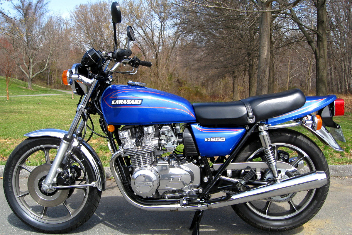

I have owned my KZ650-C1 since it was new (41 years). The paint is completely original. The decals on the fuel tank are under the clear coat and they look like new. Those tank decals cannot be felt with the fingernail since the clear coat is built up on them making them smooth with the rest of the paint. The decals on the side covers and tail piece do not appear to be under the clear coat and they too still look like new. Unlike the tank decals they can be felt with the fingernail, but I suppose it is possible that they have a very thin coat of clear coat over them. Ed

07 Apr 2018 09:54650ed wrote: I have owned my KZ650-C1 since it was new (41 years). The paint is completely original. The decals on the fuel tank are under the clear coat and they look like new. Those tank decals cannot be felt with the fingernail since the clear coat is built up on them making them smooth with the rest of the paint. The decals on the side covers and tail piece do not appear to be under the clear coat and they too still look like new. Unlike the tank decals they can be felt with the fingernail, but I suppose it is possible that they have a very thin coat of clear coat over them. Ed
I never get tired of looking at Ed's beautiful 650.

07 Apr 2018 09:59ThatGPzGuy wrote:650ed wrote: I have owned my KZ650-C1 since it was new (41 years). The paint is completely original. The decals on the fuel tank are under the clear coat and they look like new. Those tank decals cannot be felt with the fingernail since the clear coat is built up on them making them smooth with the rest of the paint. The decals on the side covers and tail piece do not appear to be under the clear coat and they too still look like new. Unlike the tank decals they can be felt with the fingernail, but I suppose it is possible that they have a very thin coat of clear coat over them. Ed
That is one of the reasons I picked Eds 650 as the First Bike of the Month when I started doing my features

That is one gorgeous bike, Ed. Congrats!
