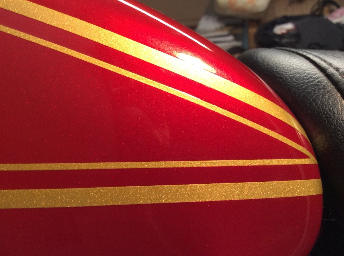

I painted my tank, side covers and tail with a red Chrysler color, put the stripes and side cover badges on and clear coated with the 2K MAX stuff. Finish is like a mirror and hard as rock. Gas resistant. Turned out pretty good.

Turned out GREAT! Beautiful bike! Ed

Looks excellent. Well done. I'm a huge fan of the SprayMax 2K Glamour coat. It looks very professional.

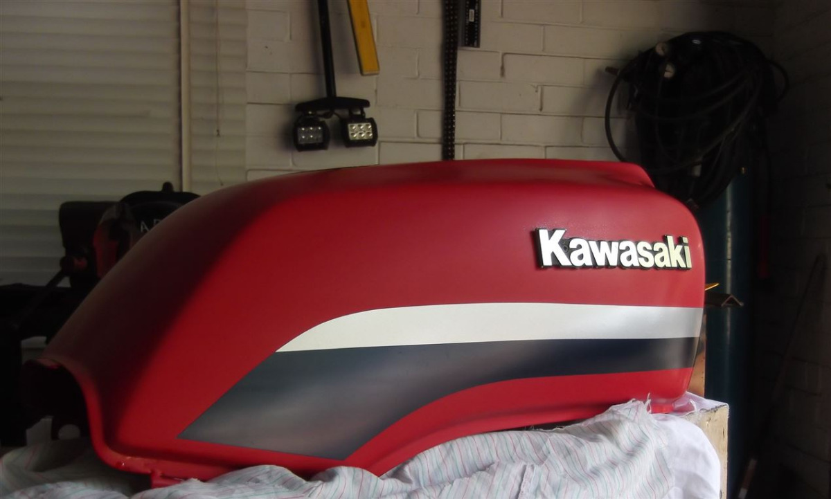

All ready for clear coating. the paint MSDS called for 800 grit abrasive paper But with all the edges i went with a 800-1000 sanding sponge and the gray scotchbrite pad that was recommended

Nice, I thought the gray scotchbrite was equivalent to 600 grit. No?
