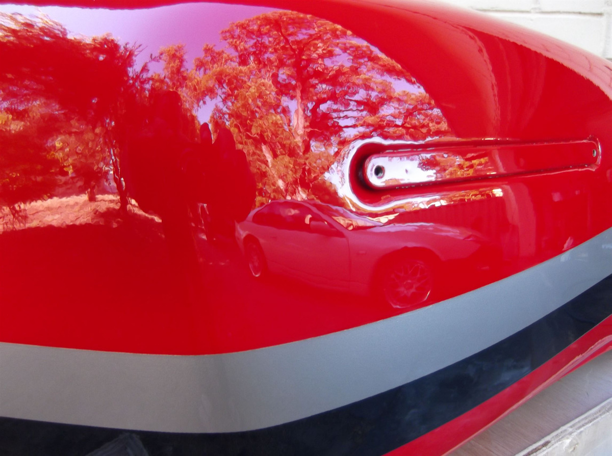

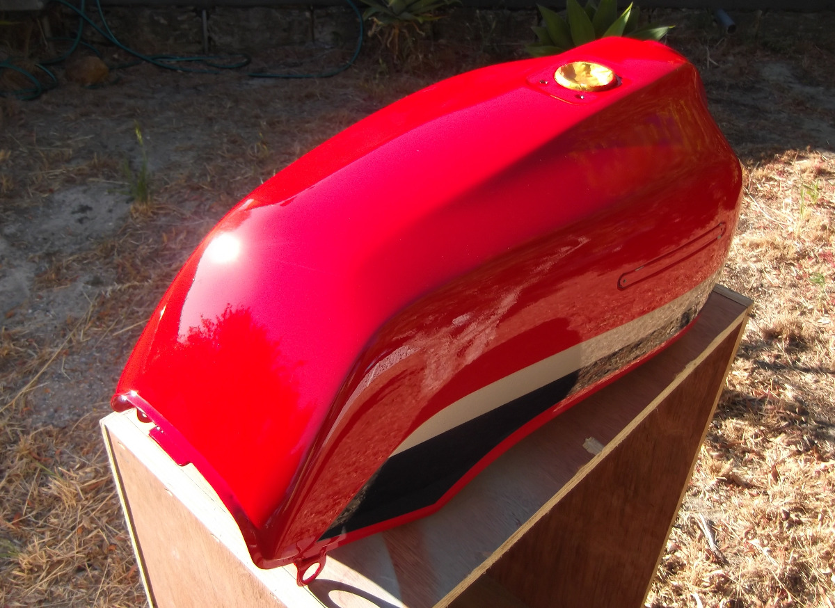

I finaly got to clear coat the tank today, Im Stoked with how its looking.
1 mist coat and 3 wet coats, I reckon i will remove at least one coat when i sand and polish to remove the dust nibs from not painting in a booth

That looks awesome!
