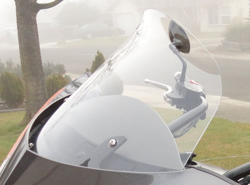

Pic below is from a vendor showing the "flip", as they call it. This is NOT a picture of the actual P windscreen
I finally have the beast running and it has a windscreen that has been cut down to 14 inches tall. When on the freeway I can feel the wind with my hand hitting my helmet right at my nose/ears and have LOTS of wind noise. It looks cool, but seems kinda pointless to even have a wind screen.
Going to buy a new screen and am considering the "recurve" or "flip" at the top of the screen. Depending on the vendor, I am told that it deflects the wind another 2-5 inches. I am 6' 1" and am considering an 18" screen with the recurve option. Thoughts/experience anyone? The stock for a P is 20.5", but I want to still be able to see some road above the screen if possible. THANKS!
