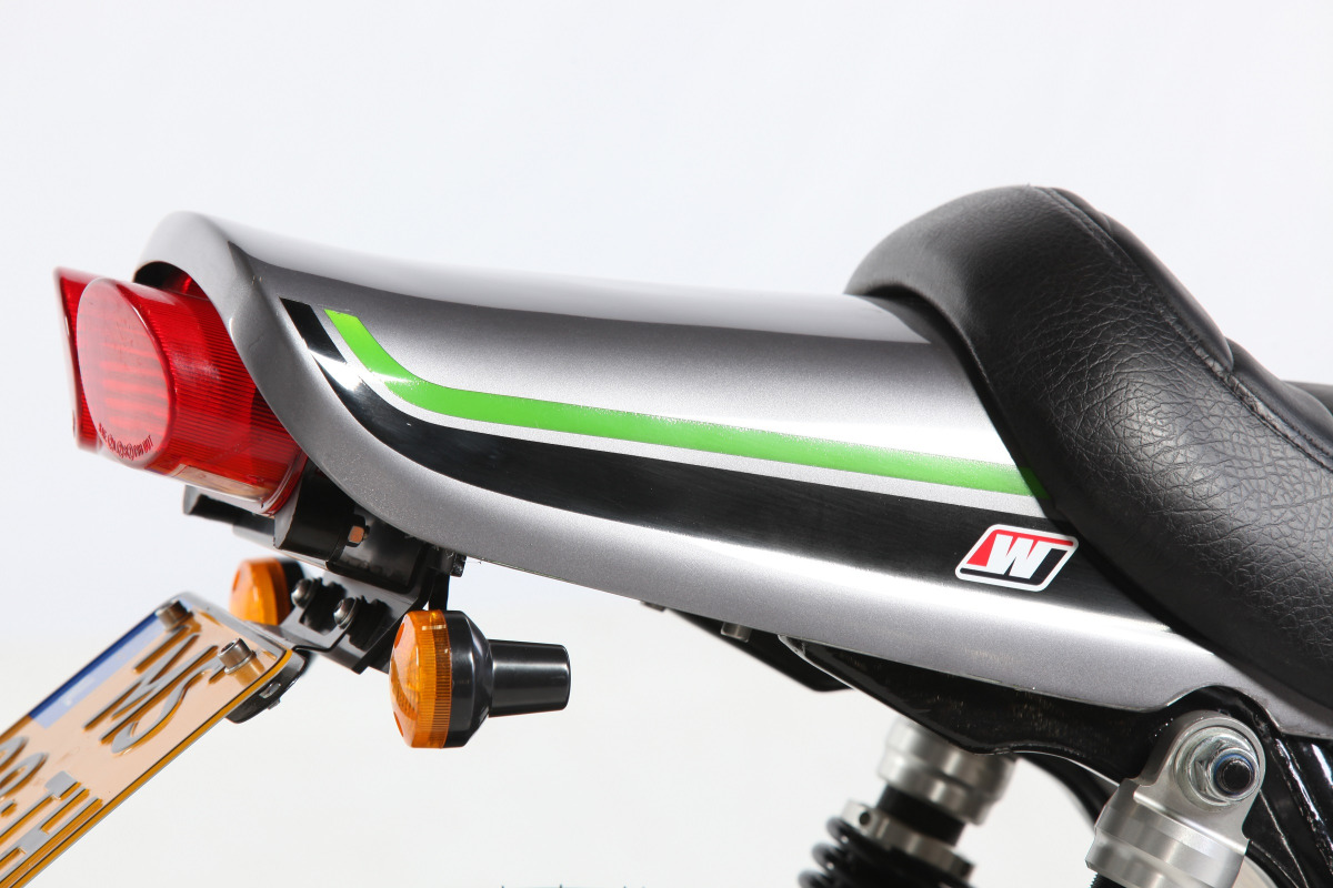

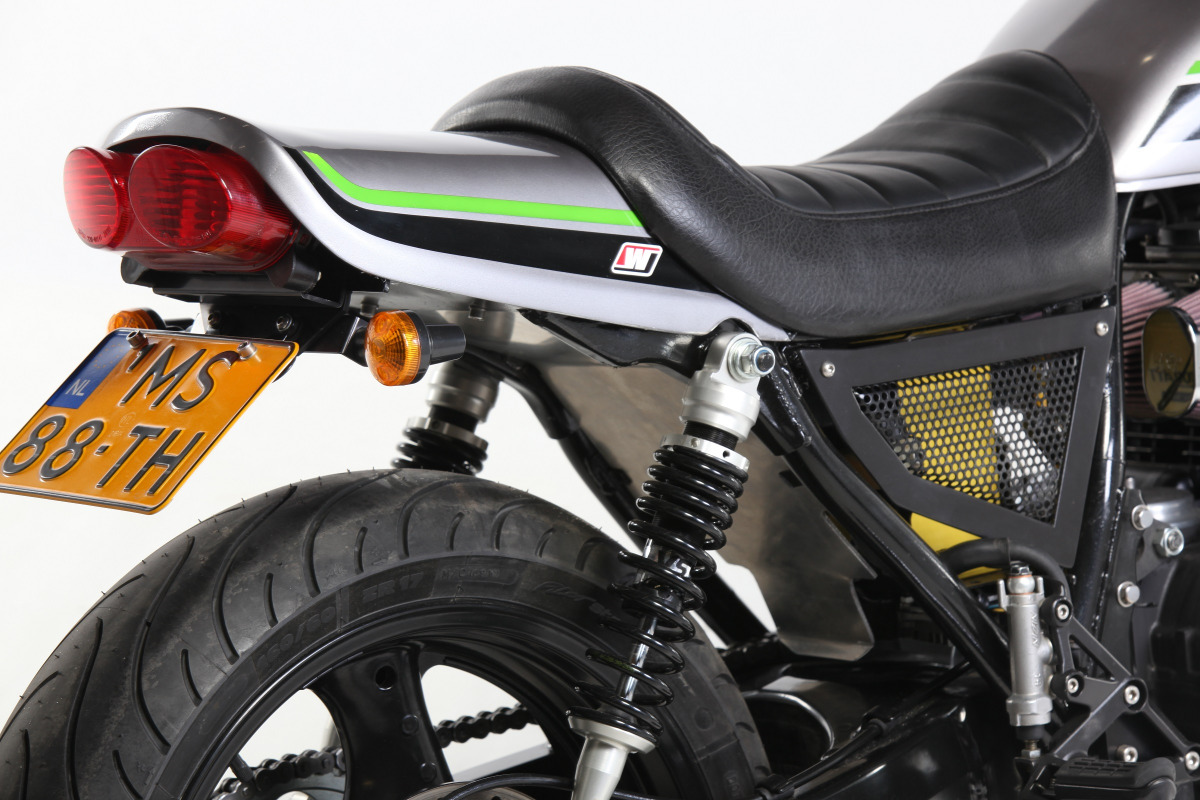

No eBay APP ID and/or Cert ID defined in Kunena configurationI did this on my CSR project, Using one of these;
It was way too narrow to fit over the frame rails but being fibreglass, I was able to cut it up and remodel it. I built it into a complete one piece tail unit/seat pan, did away with all the original hinges and lugs on the frame.No welding involved (Though I did shorten the subframe as I was going for a mono seat anyway)
I did a step by step in my build thread,though Ive no idea where. Somewhere in the first half, Id reckon.

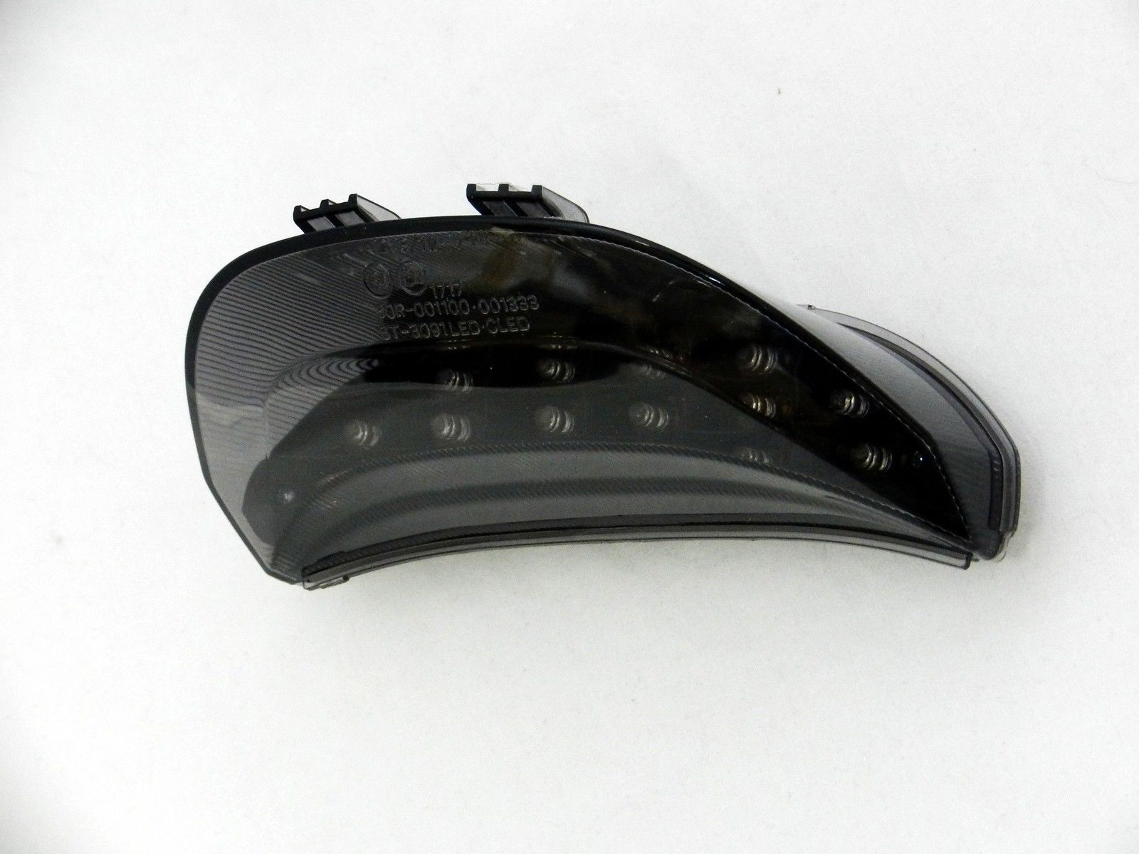

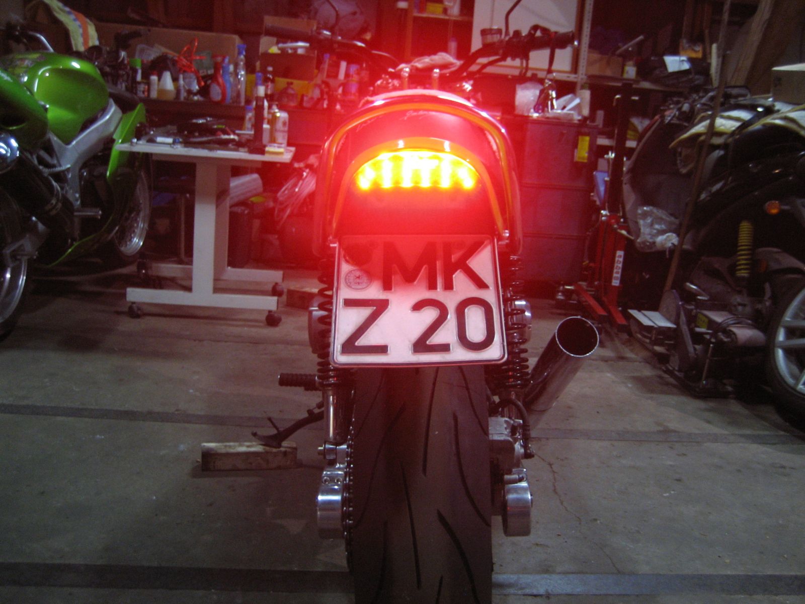

My suggestion
A HONDA RC37/SC57 rear light fits near perfect into the rear tail piece
On my project bike, the smoky rear light
