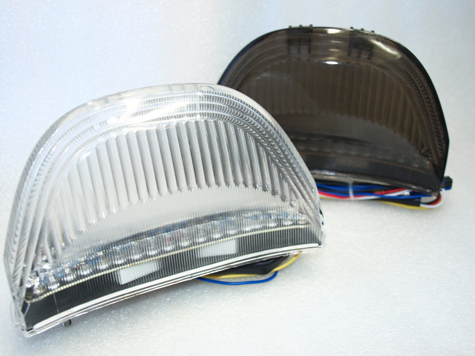

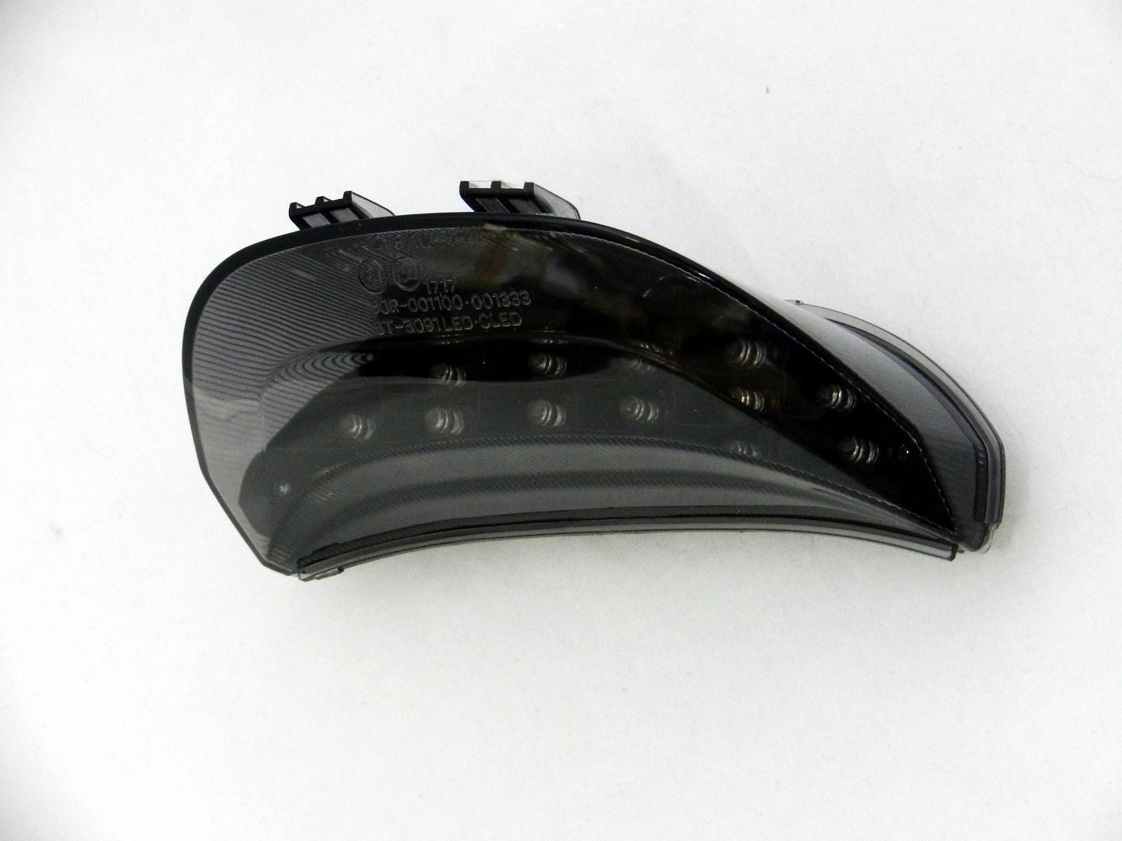

My suggestion
A HONDA RC37/SC57 rear light fits near perfect into the rear tail piece
On my project bike, the smoky rear light
