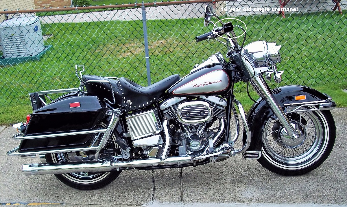

I have always used silicone brake fluid DOT 5 for over 30 years. My old Harley has a front master cylinder painted with dupont single stage urethane for over 20 years. Silicone Brake Fluid! Does not eat paint!! It is tough in this cheap ass chicomm produced materials! Take D/L products sorry! All your rubber O-rings, brake seals, petcock seals, they all suck.
So if anyone converts over to DOT 5 Silicone brake fluid. Make sure your rubber O-rings and rubber and seal items do hold up to silicone brake fluid. Mine is purple, I poured it in, it still looks purple today! silicone fluid does not absorb moisture!!!!!!
And paint last for years! In my conditions under normal use!
