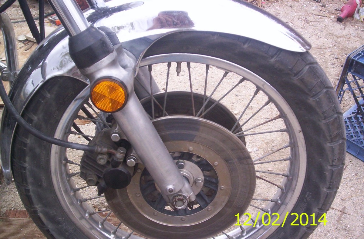

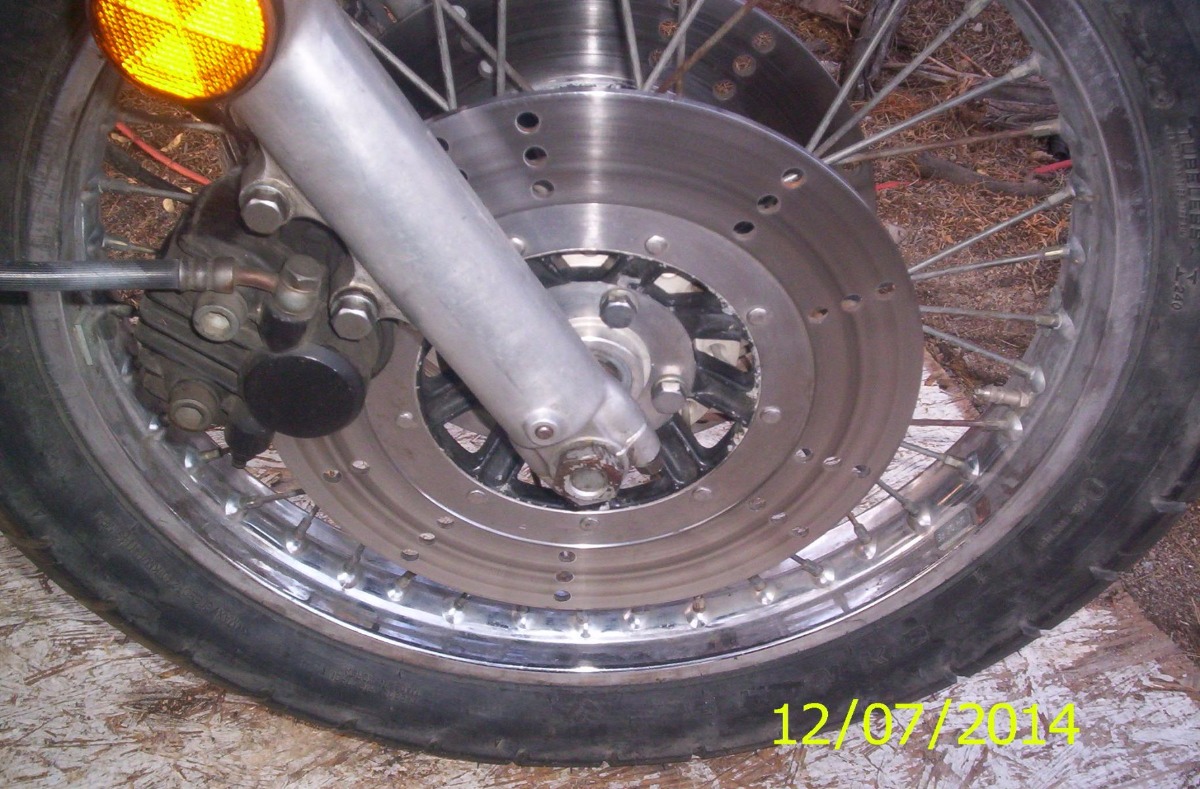

I'm not certain about the 440 but I'm pretty sure the front fenders are like the KZ400s. They use a brace with a fender bolted or riveted to it. I believe the earlier ones (like my 76) are bolted but the later (my 78 and probably later) are riveted. If you grind off and drill out the rivets you will be left with just a brace. Here is a pic showing just the brace:
Once you've done that you can add any fender you would like (given it will fit between the forks) with a drill and some bolts. Here is a fiberglass fender I added with some spacers under it to raise it up a bit:
I recommend you go ahead and buy the LTD fender that you're sure will bolt up to your bike, separate the fender from the brace and put the brace in place for the time being. That will give you something to tighten up the forks and also give you time to work on cutting down the fender that came with it or decide to go another route.

Hey that's a great idea!
I like the fender you chose for yours! Looks cool!
Ya I'm gonna start with just the brace I think. I dig the brat bike vibe currently and might go that route.
