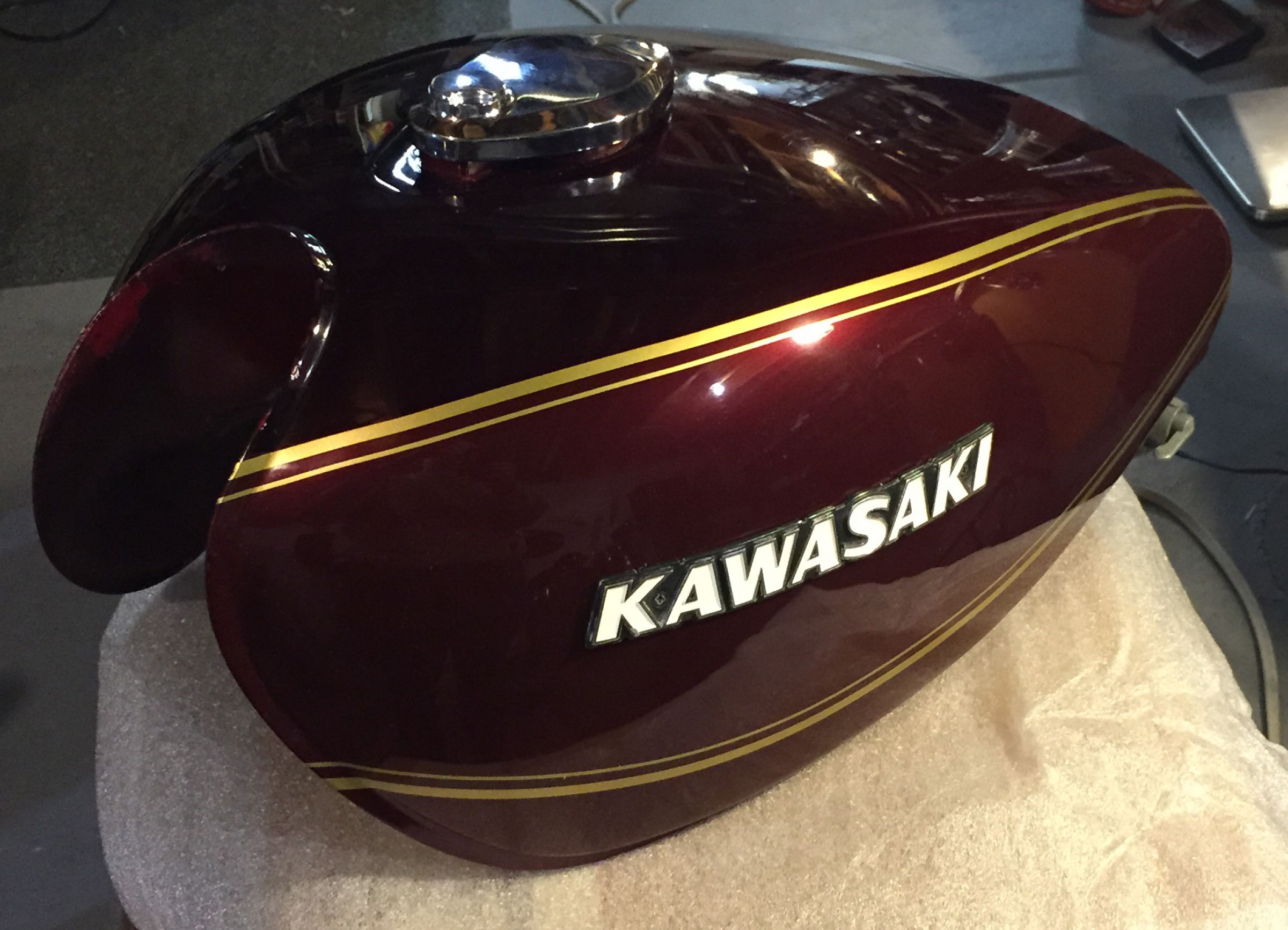

After applying the clear I had some slight orange peel too. IIRC, I used 1500 then 2000 wet in one direction, just to knock down the peel a bit, cleaned it off with a wet sponge then used Maguires polish on a small polisher.
Some "compund" polishes are too harsh, look for a clear coat safe polish.
This was after 2000 wetsand
polish and finally wax.

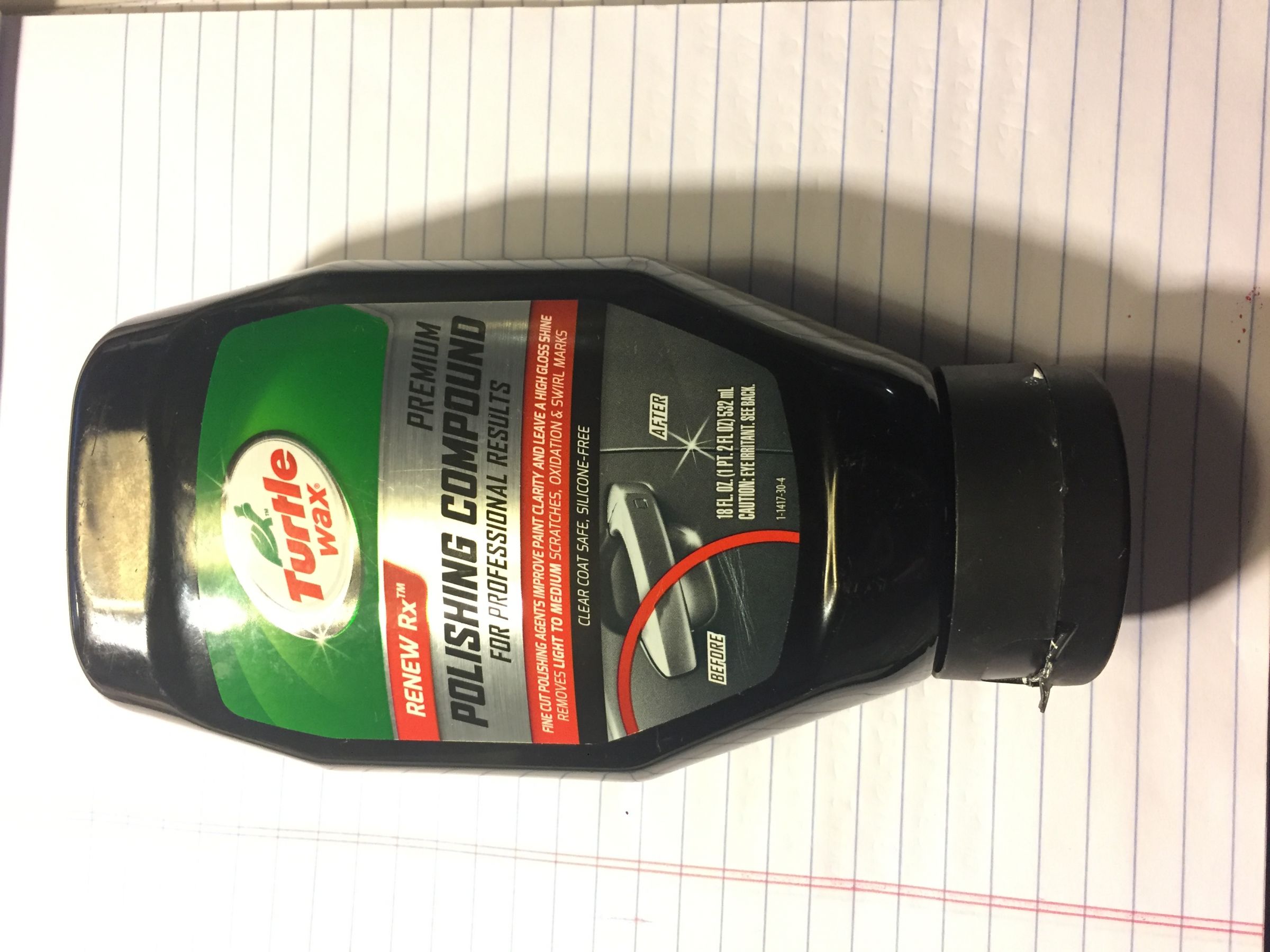

What i used to get the gloss in my avatar was inexpensive white polish from Turtle wax called Premium Polishing Compound... LOL

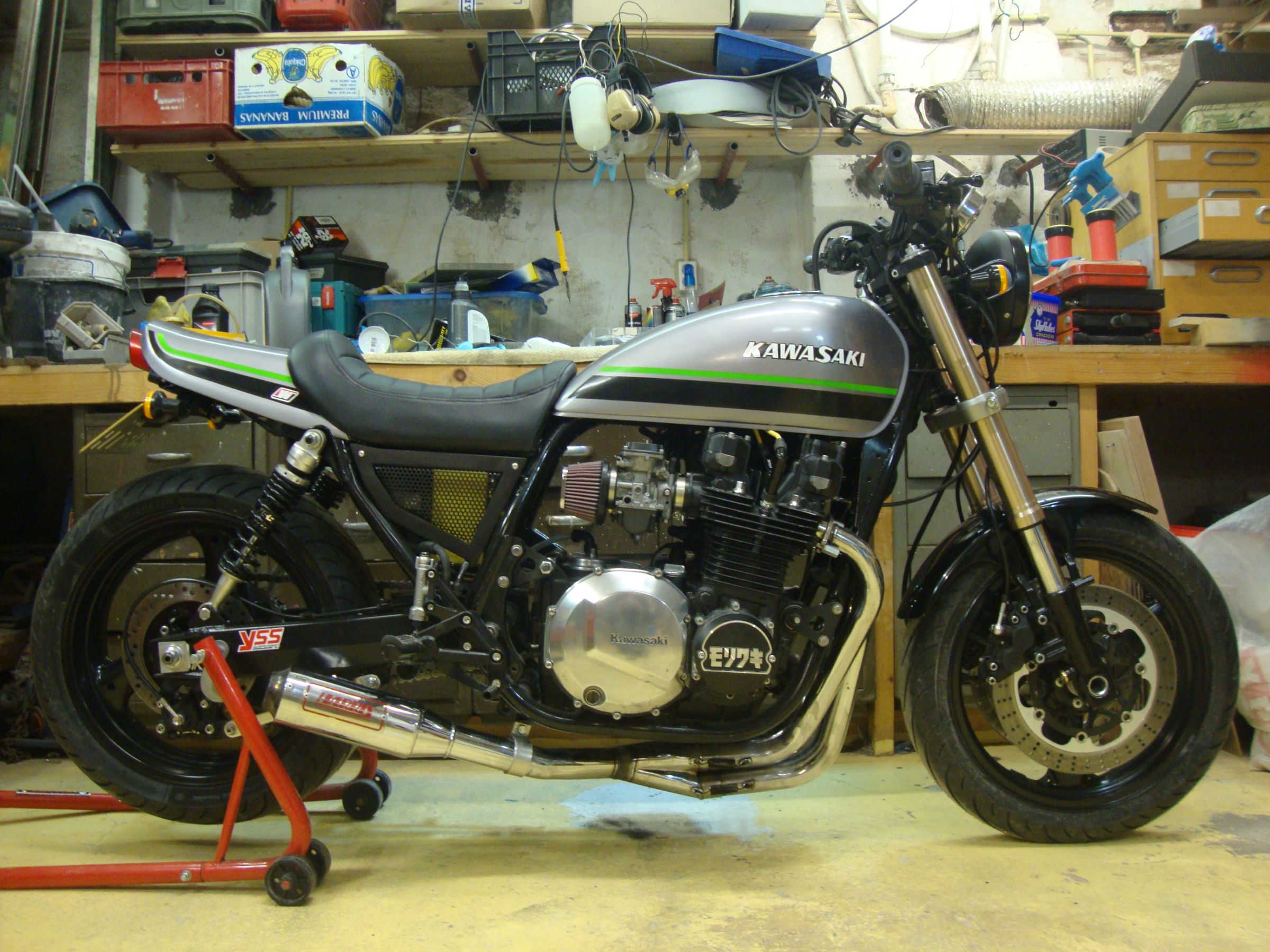

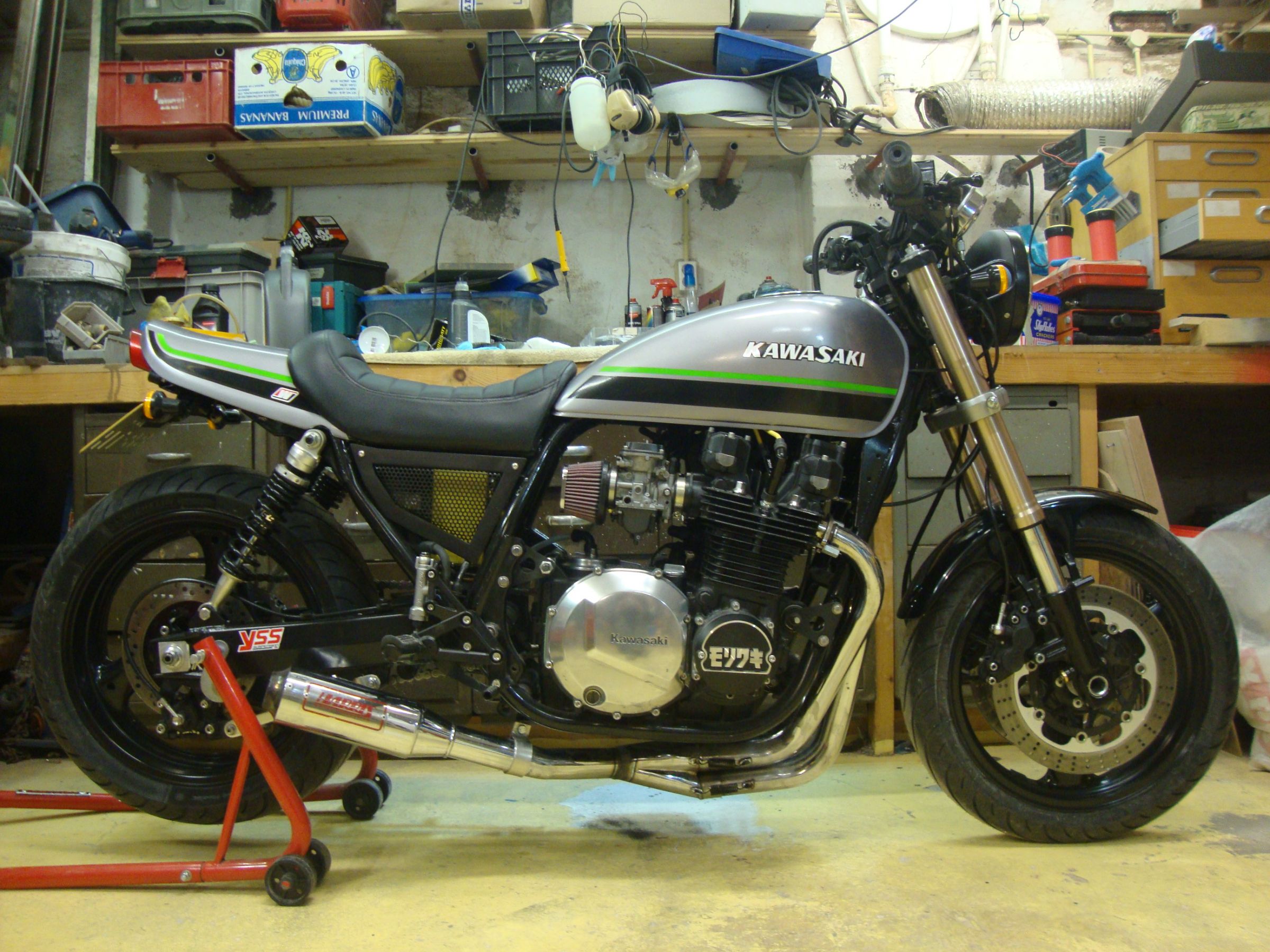

OK,done and dusted. Sorry I let the thread go.I was carried away with the rest of the build. Anyway,heres how it turned out;
Not a perfect finish by far but Im happy with it. It fits with the 'homemadeness' of the rest of the build.Thanks for all the help and advice.(That 'Spraymax' was very nice to work with.)
Not bad for a first attempt!
