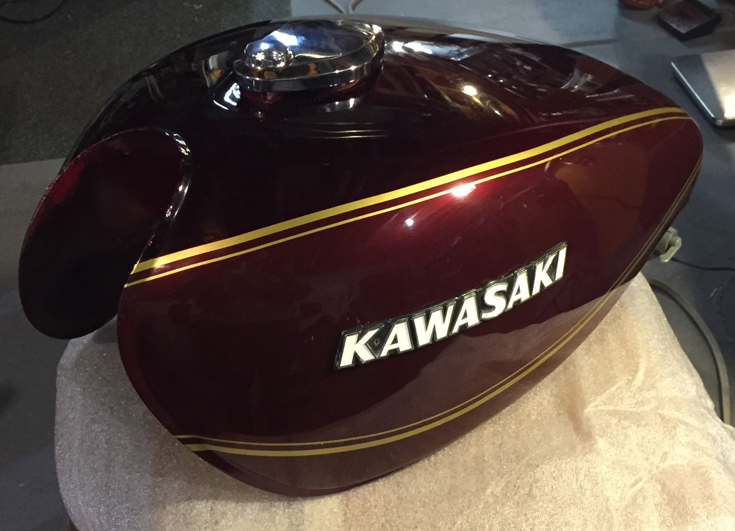

19 Dec 2016 11:41 - 19 Dec 2016 11:43I have sprayed it over acrylic lacquer many times....martin_csr wrote: Do you know any bodyshop guys? They might know if a urethane can be sprayed over acrylic-lacquer.
As long as the acrylic lacquer is fully cured.
If it is already cured and rather glossy, wet sand the acrylic lacquer with at least a 1200-1500 grit wet and dry paper first.
Make the old finish look dull but very smooth.
Clean the living bejesus out of the old finish after this and wipe it with a CLEAN tack cloth.
One light but well covering thin'ish coat of Spraymax 2K followed by a nice thick coat with NO RUNS a little later.
Then let it dry and cure... depending on temparture this could be a while.
After, break out the wet and dry 1500 paper for the hard part.
After that I usually do one more coat of clear and super wet 1500 sanding rounds.
Finish up with 2500 to 3000 wet and dry paper... almost looks glossy then but still satin like.
Then get GOOD quality paint polish, NOT rubbing compound.
You should be able to polish with a good quality polishing rag but if you know how to use a bufffing wheel..... that is much faster.
Below is a weekend project tank using this method....
Total investment, including the tail piece and side covers was around $42.00
