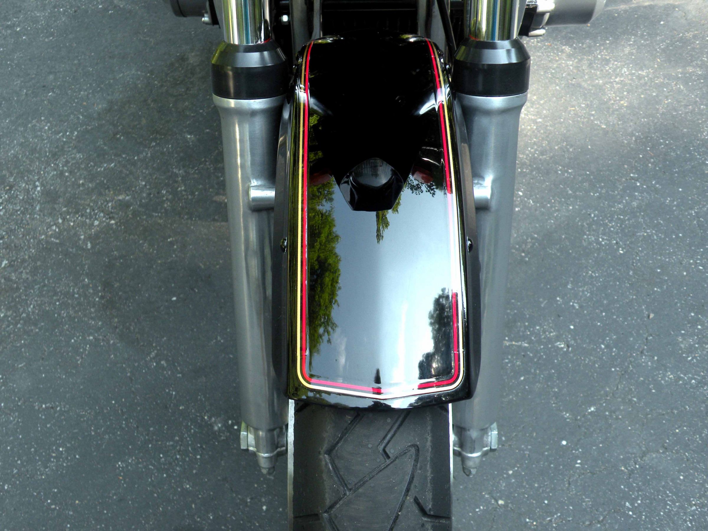

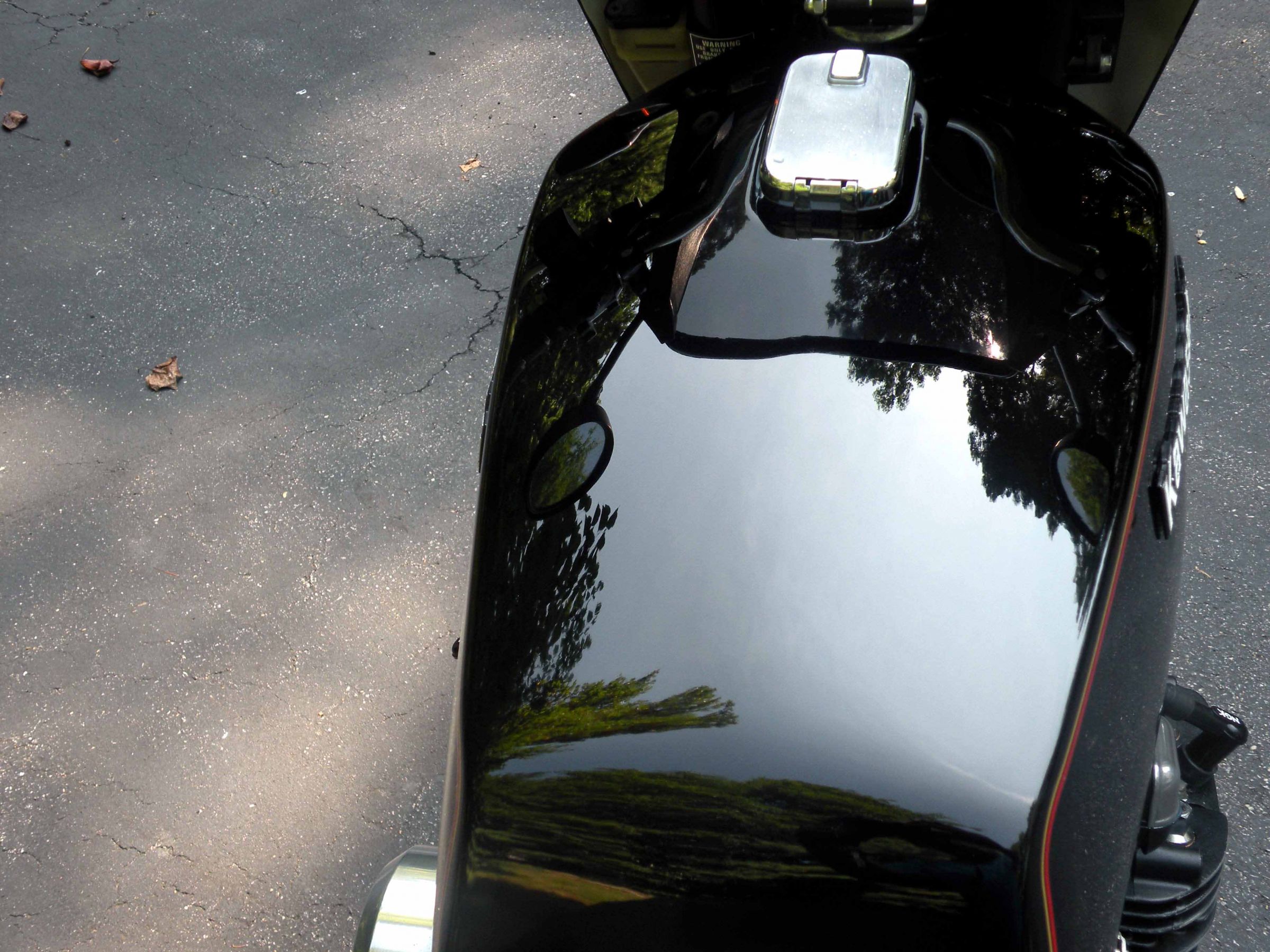

Here's the Clear on my 80 Z1R I just finished. I used all House of Kolor.
Reducer is relatively cheap, so a quart is typically the smallest size you'll find. Call or check your clear manufacturer's website for the nearest stocking dealer in your area. Wait and get the right stuff. Clear is the final and critical step. If it goes bad, everything you've done will be wasted.

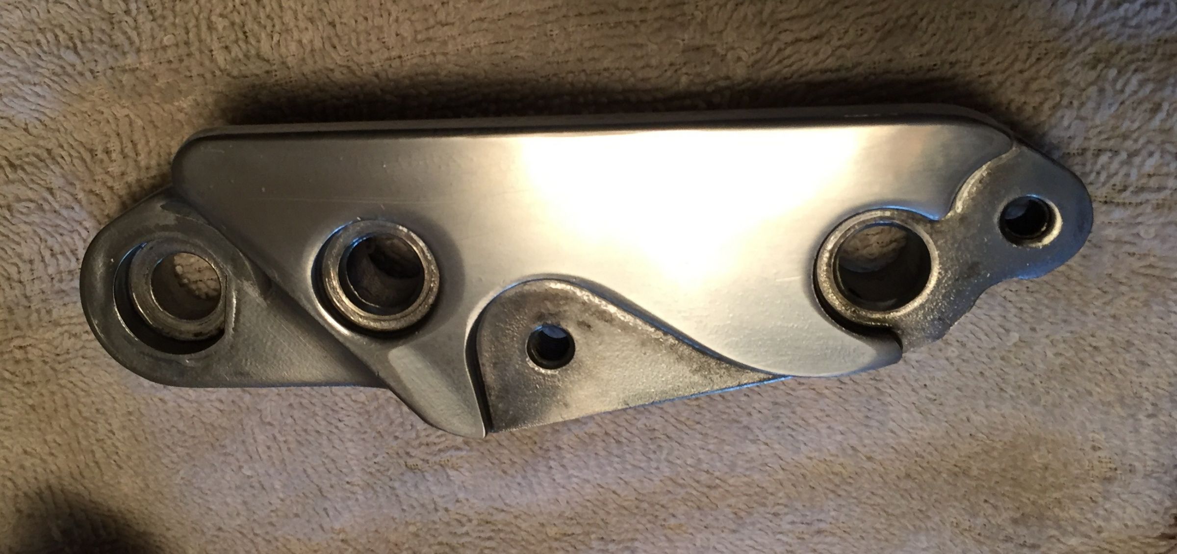

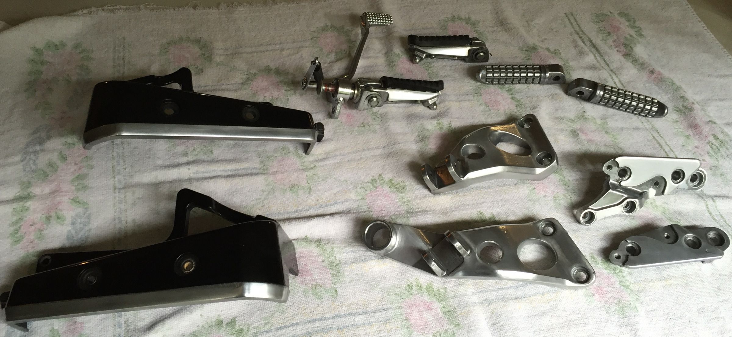

I carefully polished each part and degreased them with chlorinated brake cleaner. I shot three coats, allowing 15-20 minutes flash time between each and then 15 or 16 hours to dry. Most of the pieces had a little orange peel. A couple of them had a small run, and the muffler hanger had a sag on the most obvious part. I (almost) carefully wet sanded each with 1500 grit, and applied three more coats as before.
Here are the parts after the first three coats and drying---

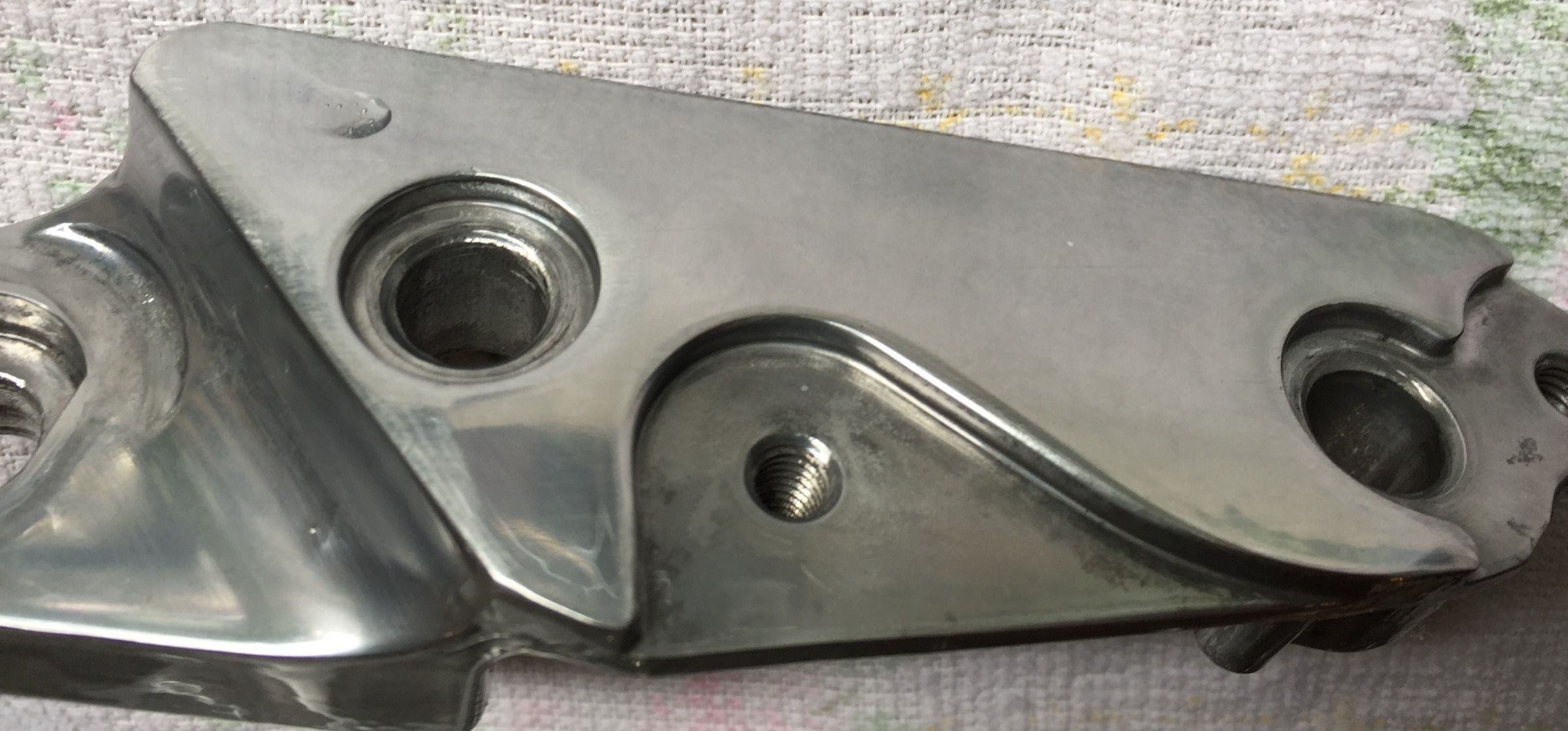

Here is the piece with the most obvious run--
After the second coats had dried, I wet sanded again and buffed and polished by hand. Here is the part above after that process---
What I did not notice until I was spraying the final coats was that I had sanded all the way through the first coats in two small spots on the muffler hanger. :pinch: I decided to go ahead and finish the piece and see how they looked. I suspect that most folks will never see them, but I know they are there taunting me.
Overall, I think it went pretty well. If I had paid a shop a handful of cash to do this, I'd be much pickier. At any rate, the parts look MUCH better than they did before and I have a bunch of clear left over to practice on. Perhaps a heavy coat would keep the dog from shedding :whistle:
The Preval system worked as advertised, though like most spray cans the pattern is not as well defined as with a real spray gun. With a bit of practice, I think the results could be even better.. It was certainly worth the $4.97 I paid for it.
