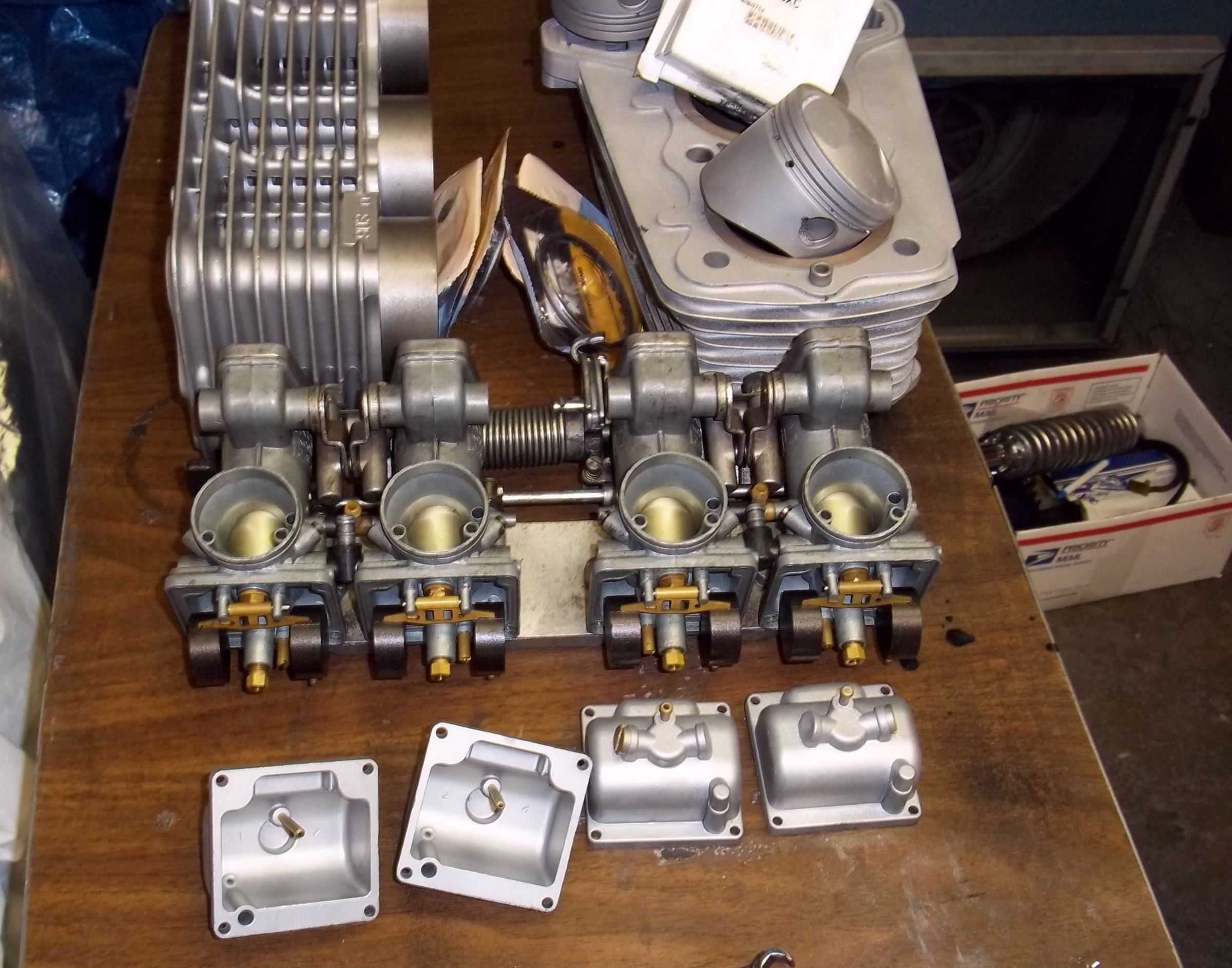

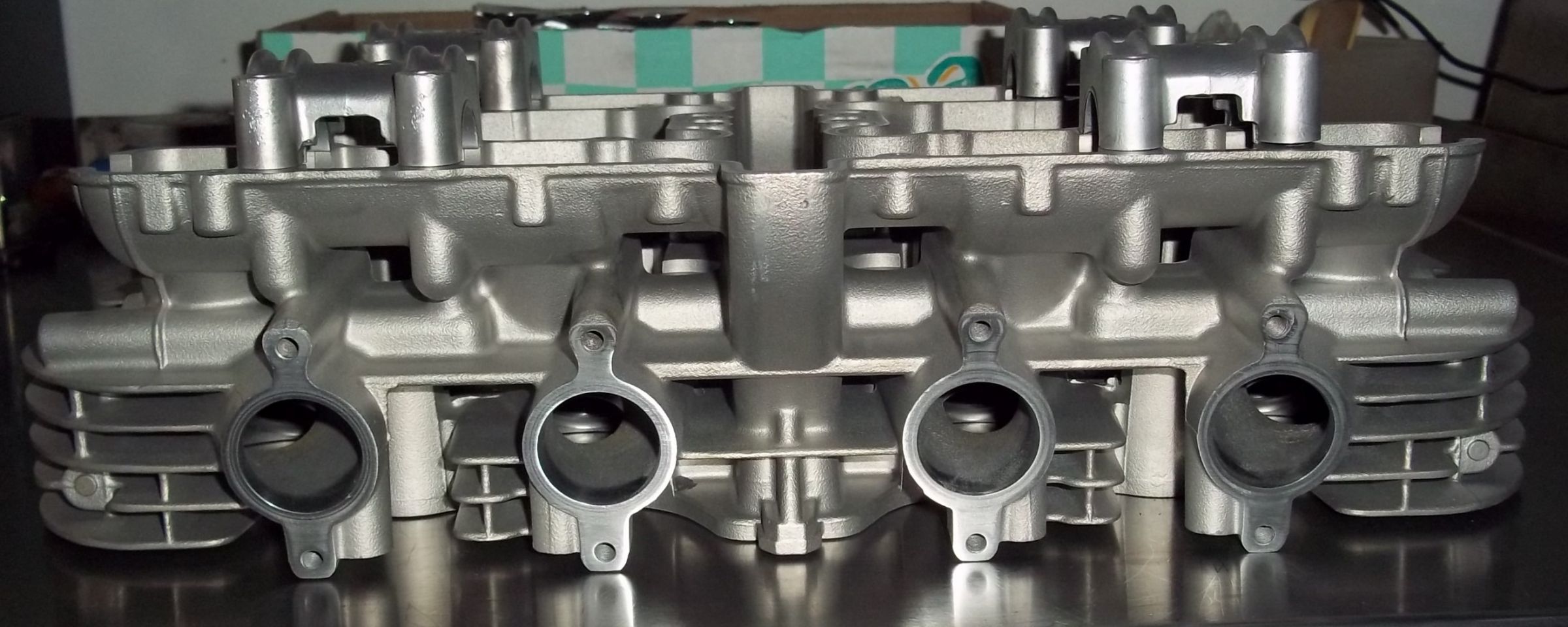

Vapor blast is another option RestoCycle has done a bunch of stuff for me.
Online quote form and samples: www.restocycle.com/
Some of mine:
Here's an XL head with amazing results, this thing was nasty
Some of mine:
Attachment IMG_0465.JPG not found
I didn't come here and I ain't leavin
Last edit: 10 Aug 2016 16:18 by Tune-A-Fish. Reason: Add image

Yessir! Niles has been a pleasure to do business with, I will be shipping off a pile to him again soon.
Oh and don't be afraid to send just a few small parts, he can add it into a larger project.
