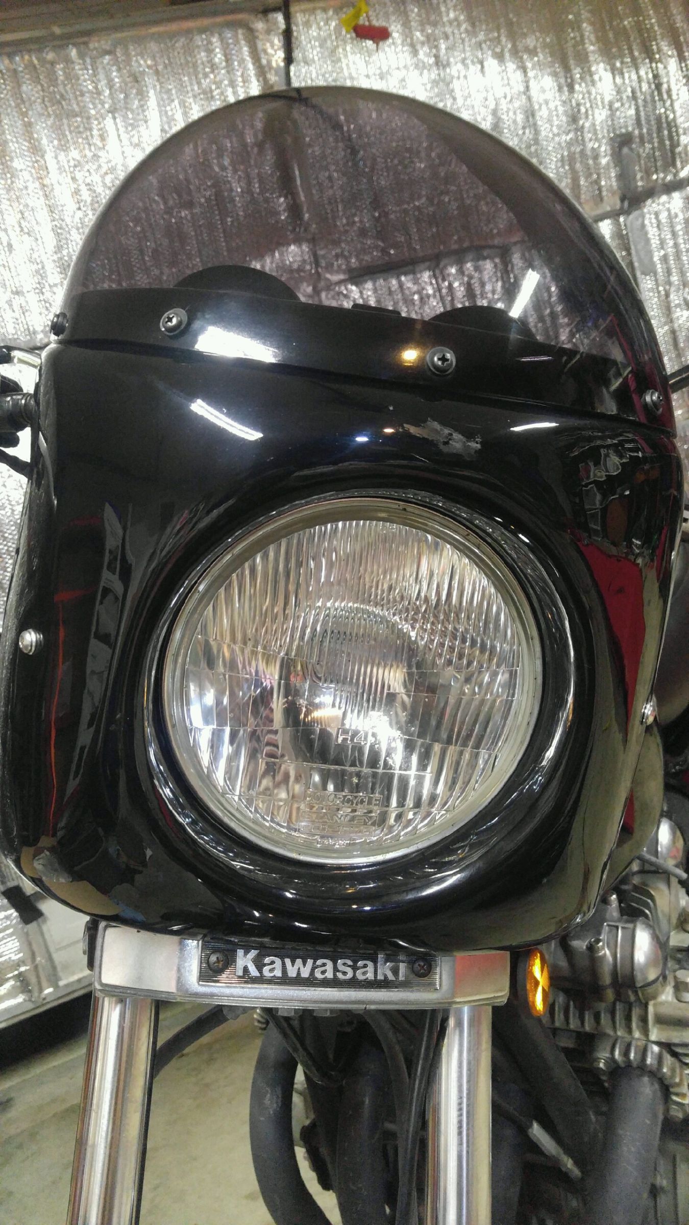

All and all it fit pretty well.

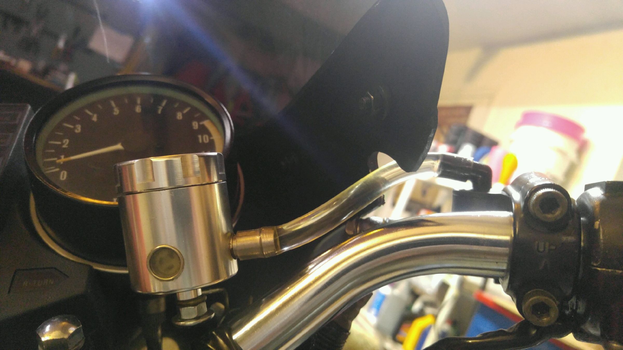

I used a front master cylinder from a 2000 ZX6r with a remote reservoir, the stock master cylinder was right in the way.
I used the brackets included with the emgo fairing that attach to the headlight bolts and also used some brackets on the upper fork tube clamp to make braces that run to the 2nd windshield bolts on either side.
The fairing was all to flimsy just using the 2 included brackets.
I'll post some pictures of the final brace location and design when I get them finished, waiting in my brother to get back into town so I can use his welder.
Anyway, pretty happy with it so far.

Looks nice. Very clean.
BTW, where are the turn signals?

Nessism wrote: BTW, where are the turn signals?
The bike didn't come with any and
I've not got that far yet, still on the fence.
The easy thing to do would be to mount them to the fairing, however I don't want to have to unplug them to take the fairing off.
The key for me is to make the fairing simple to remove, I want 4 bolts tops to remove and install.
I'll work on turn signal location when I get the braces finalized.

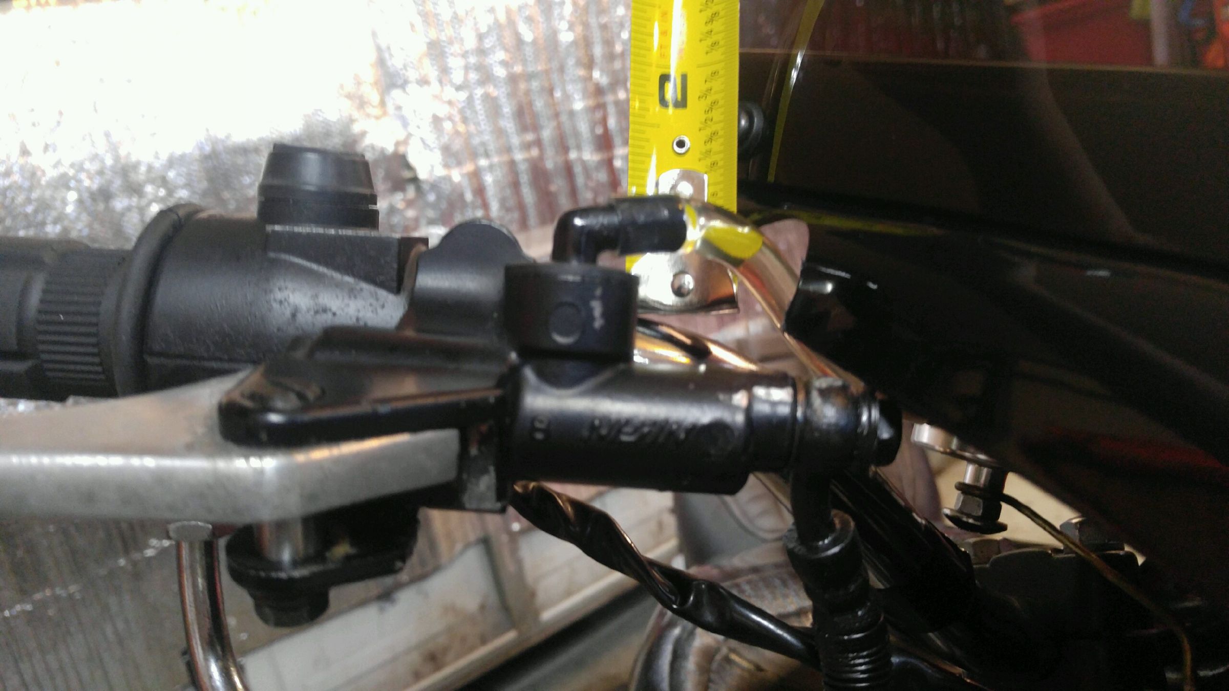

The chrome headlight ring will NOT pass through, it will fit around the headlight glass only.
I doubt the flat top master cylinder will work.
I'll post pictures of the clearance later tonight.

pretty tight.

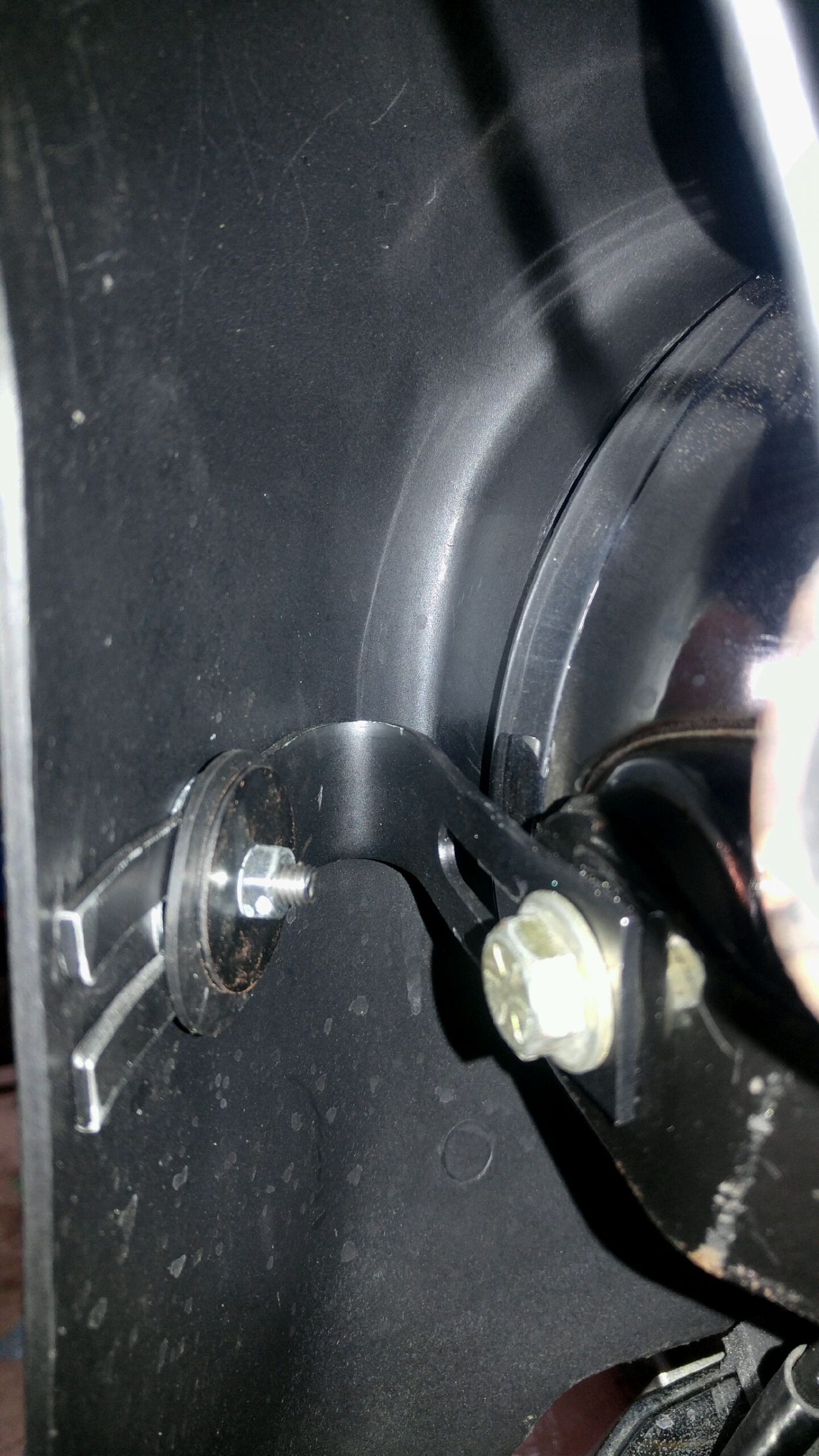

Are you able to picture how the brackets attach the fairing to the headlight or bike ?
The 2 side screws on the fairing shown in the 1st. picture. Where to they attach to ?

I'll get some good pictures tomorrow.
The included brackets attach to the headlight mounting bolts.
It's not enough, I've made some braces but i need to come up with a more permanent solution.

kzdcw wrote: Are you able to picture how the brackets attach the fairing to the headlight or bike ?

Thanks so much for the pictures :) Would it possible to use the stock turn signal stems that mount on the headlight fork ears ? I'm assuming you would have to drill holes on the sides of the fairing ?
