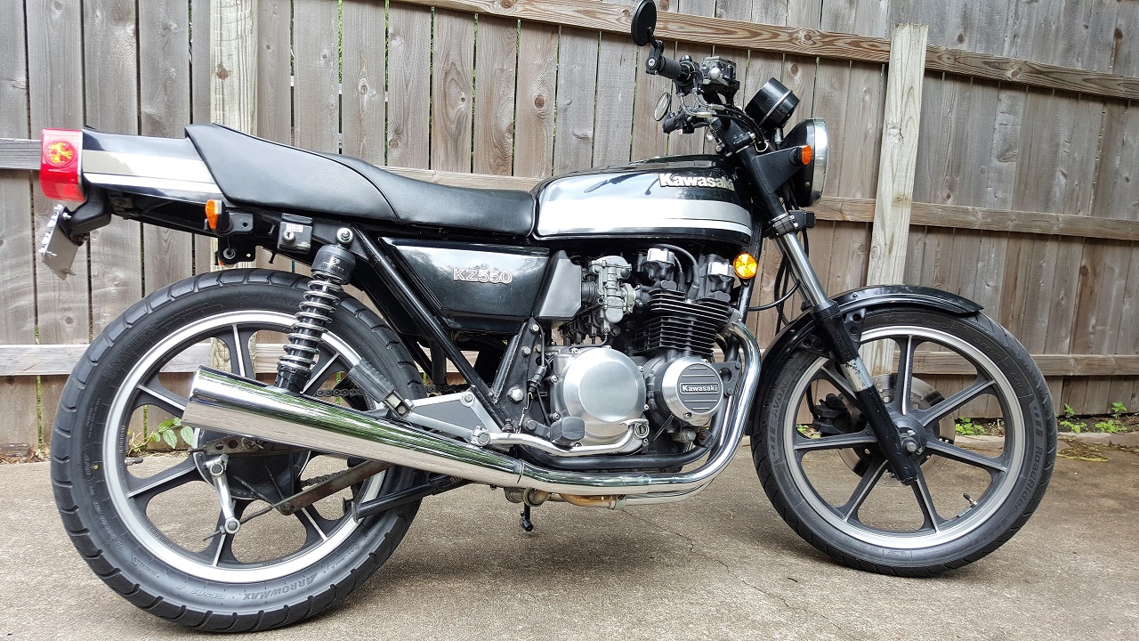

I faced the same issues with my 550a. It was a gift to me and in good, running condition so I was reluctant to do anything drastic as you are saying because I didn't want to stop riding it long enough. As Ness stated, while I had the valve cover off for shim work, I chose to do a little engine tidy-up too. The valve cover was probably the easiest since it's off. I don't even have any of my power tools like the drill press handy here so everything was done by hand. I used all the old "punish your body, not your wallet" approach that you are familiar with ;) which means - wire brushes assortment, several sandpapers and scotchbrite pads. Ultimately, the wire brushes and thinly rolled-up (like cigarette sized tubes) of sandpaper were most useful to get into all the snug areas. Just sat on the back patio in the evenings and cleaned until I was happy.
It occurred to me that much of the engine isn't really visible so I repainted the valve cover but chose to sand/polish-up the ends only which I had seen here on other bikes. You can see it here:
I found that when repainting, it was really useful to have a selection of artist's paintbrushes handy. I would spray the paint into it's rattle can lid and then dip the brush into it and hand paint areas which saved me from blasting at the engine with the rattle can. If you look at the timing cover, the passenger foot peg mount and much of the upper engine - cylinders and head, they were all hand painted with just brushes dipped into the rattle can's lid.
As for paint... Well, I actually chose BBQ paint because of the heat factor and I found that even while it's "flat" or "matte" finish, after I ran the bike for a while and the paint got good and cured, I was able to kinda' hand-buff it with soft cloth and it kinda' made it shine a wee bit more which brought it closer to the satin range from the matte range of finish. To be honest though, I kinda wished I hadn't done that because the rest of the engine's black is still original and thus, matte/flat due to age.
Cost wise, I've probably spent less than a handful of singles on the engine's looks so definitely on my budget and now the looks are in keeping with a presentable but still on the road bike.

That is a really really clean 550 Wrench, thanks for sharing!! Really appreciate the tips too, I like the idea of using brushes on some of those hard to reach areas so that you aren't just wasting paint trying to spray it in, will definitely be pirating that technique :P
