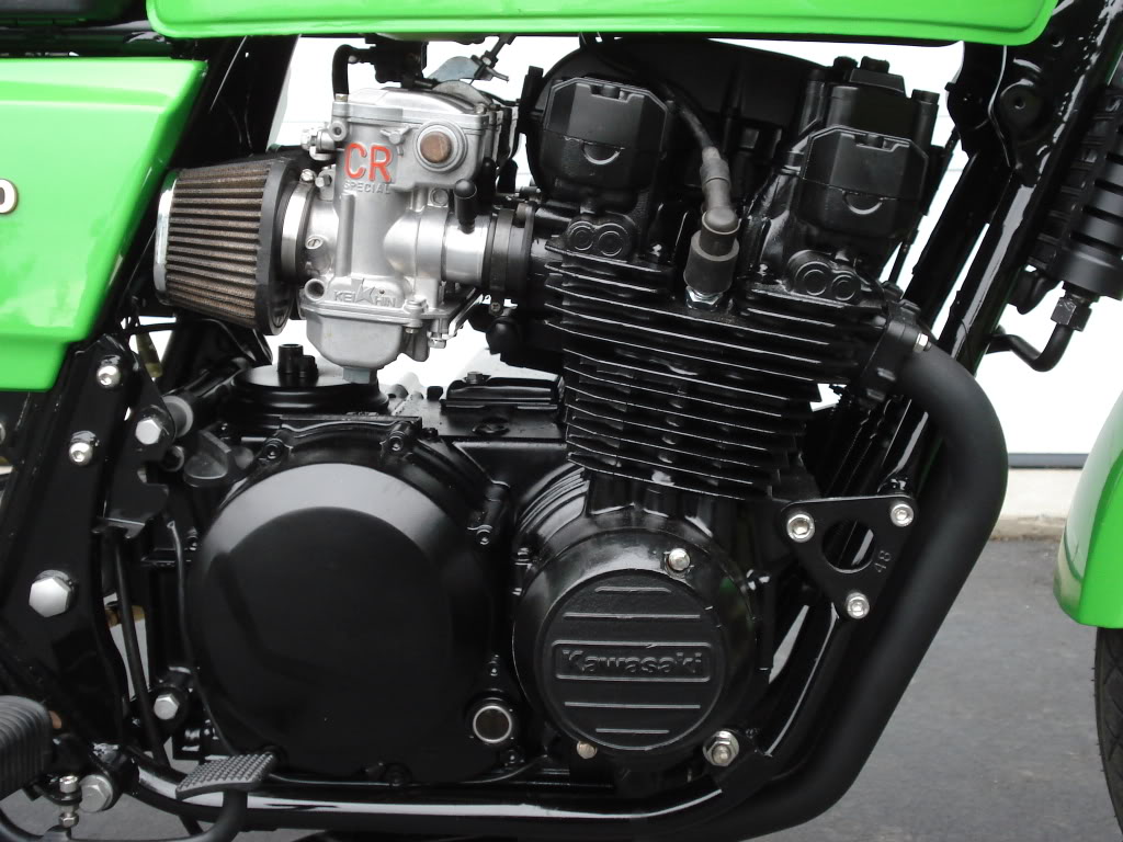

SEM Hot Rod Black works great. It's catalyzed urethane, resists heat and chemicals well, and has held up for quite a while on my 550
