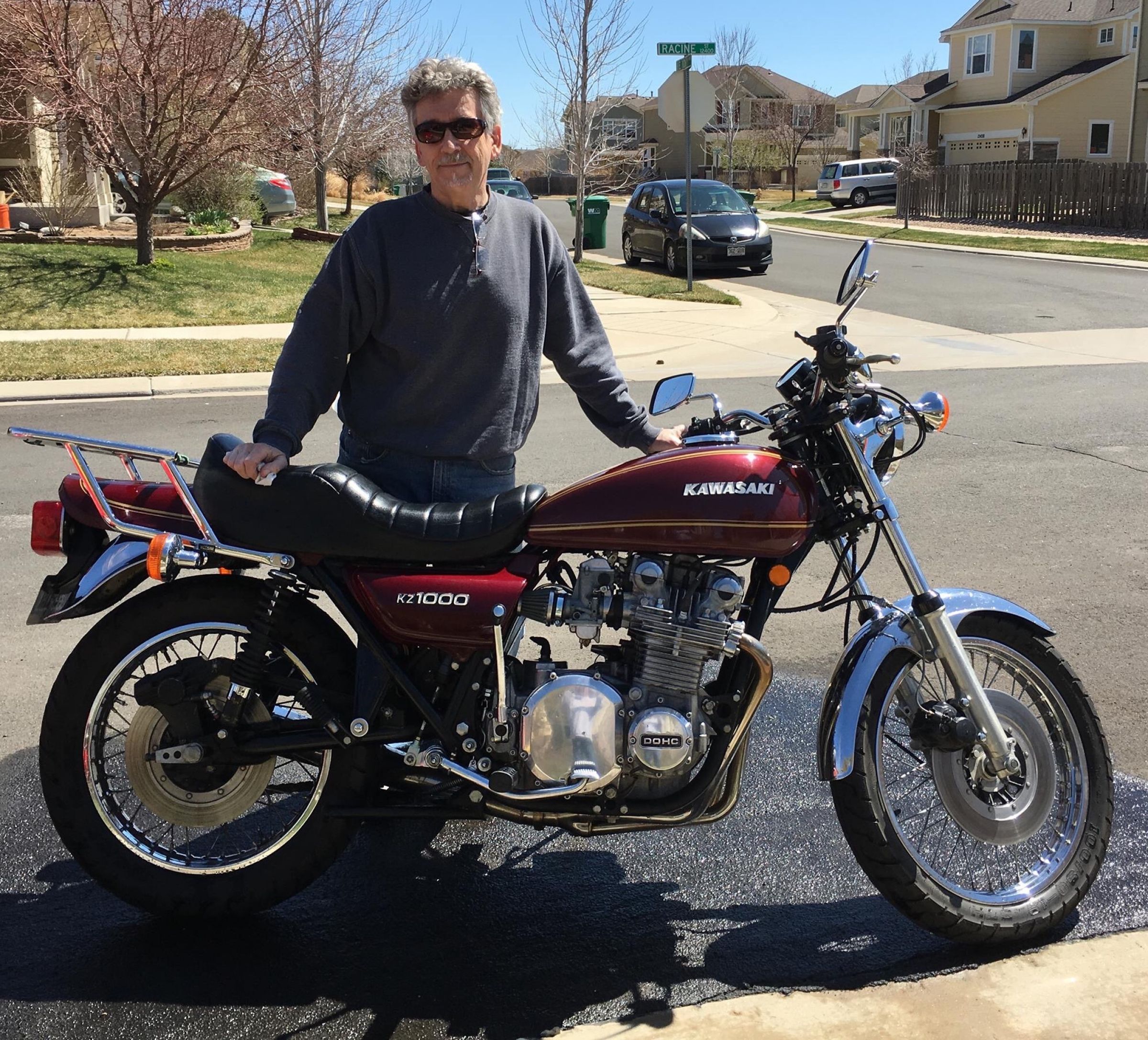

16 Apr 2016 19:57 - 16 Apr 2016 19:57That's pretty close to the seat I made for my bike Steve. I don't care for the way that one from Z1 looks but I'm sure it will appeal to many others.

17 Apr 2016 09:57Ok, I dug out an older kz1000 LTD seat from years of collecting KZ junk.DK900 wrote:swest wrote: I got one for mine. Nice for short rides but a real PITA on long ones. So I fitted a LTD style seat. Now I can go as long as I like.
SteveThat’s the decision I’m trying to make now. My 76 KZ900 A4 has an original seat off a 900 (or possibly 1000?) LTD on it. The seat needs new covering and probably new foam. I’m trying to decide if I want a reproduction of the original seat or a repo LTD seat. Steve, where did you get yours?missionkz wrote: That's pretty close to the seat I made for my bike Steve. I don't care for the way that one from Z1 looks but I'm sure it will appeal to many others.
Mission, since you say you made yours, did you recover the original? That makes me wonder if an auto upholstery place could fix up the original? I’ve seen the kits with a cover and foam, but the ones I’ve seen pics of after they were put on look kinda cheesy.
A crappy one with bad, ripped apart vinyl and crusty foam but clean metal pan.
I found a person on eBay selling LTD replacement covers for around $40 shipped.
I stopped by an upholstery shop and the guy gave me a 2" thick by around 14" x 30" piece of medium density seat cushion foam for only $7.00! No idea how $7.00 came up but maybe it was off fall from an old job of his.
Ripped the old seat apart and used my wives electric turkey carving knife to trim out a lot of the old ratty foam and cut the new piece to fit and overlay.
I used water based contact cement on the two foam halves. Then wrapped the foam in some medium thin clear plastic followed by the new seat cover.
There was some old plastic sheeting on it so I removed it but followed that idea with new plastic.
The whole operation took about +2 hours and was easier then I expected.
