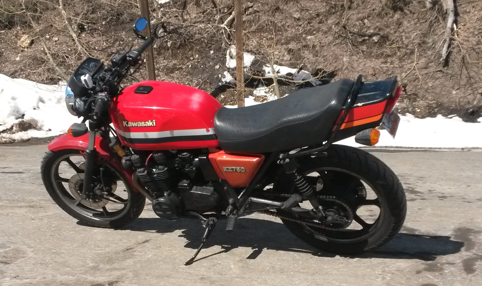

Others that interchange. (KZ or Z) 750L, 750P aka GT750. I look for 750 parts but the 1000 & 1100, counterparts, 1000J for example, most likely fit. Not so much the 550 stuff.

22 Mar 2016 13:50 - 22 Mar 2016 13:58barney wrote: I'm not sure the P or GT750 models are interchangeable
That's right! It has a tail rack instead of a cowl.
Kawasaki mixed and matched stuff. The tank, fenders, handlebars and instrument cluster are the same. Not the side panels or tail. Same case in the other models but on other parts. None are 100% the same.
Speaking in terms of the 750 that is.
