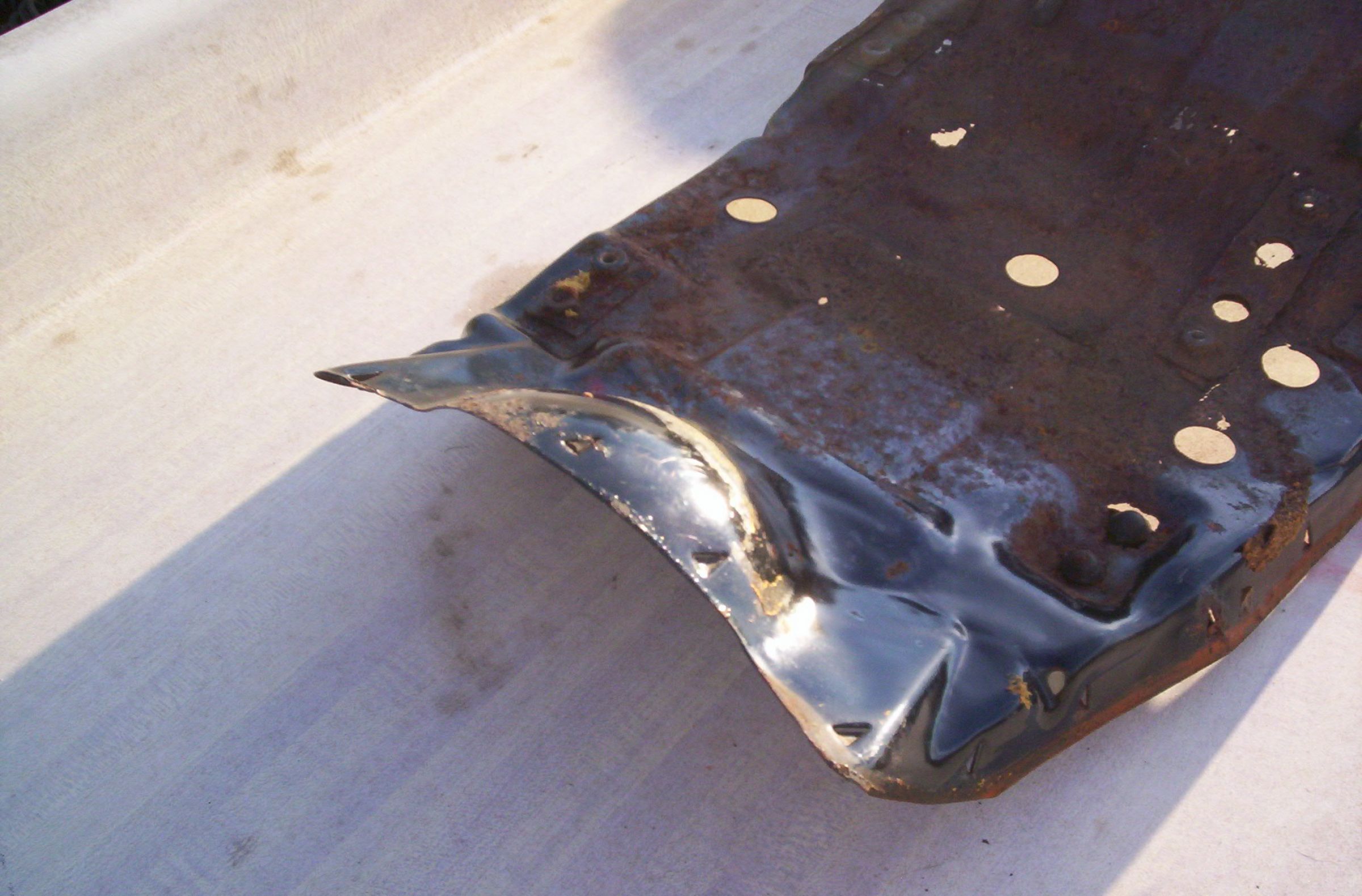

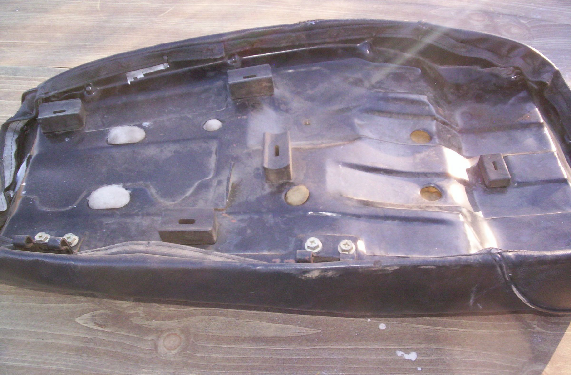

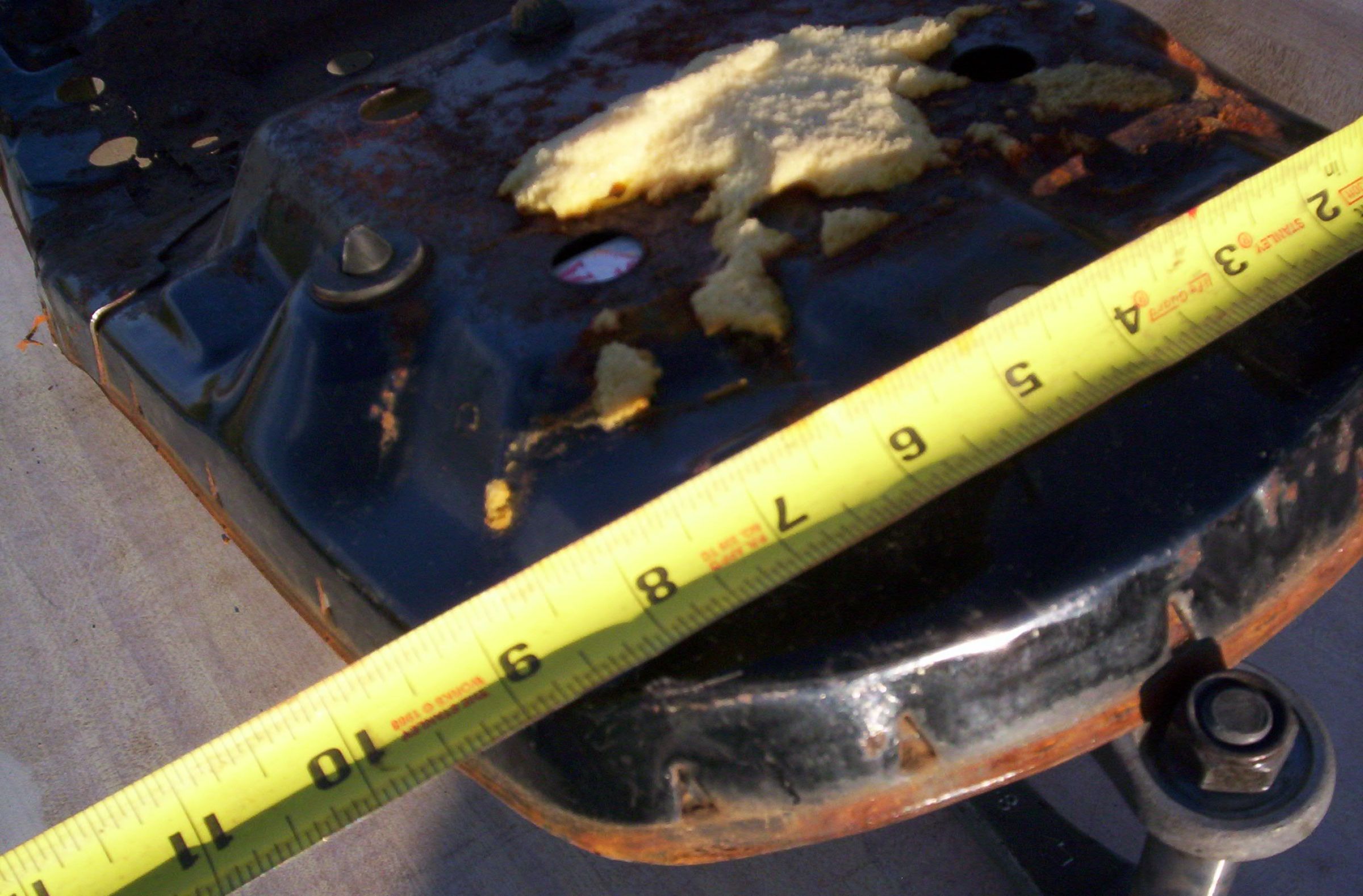

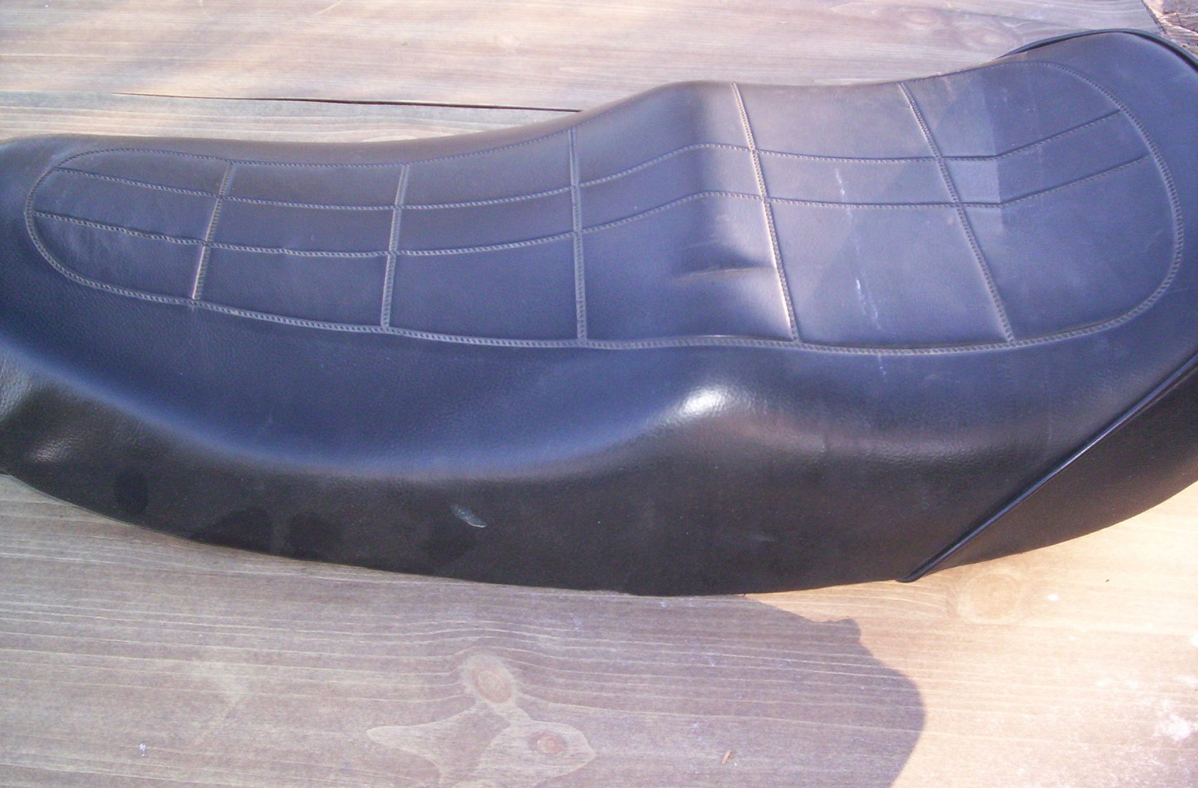

Now that's it's light I took some shots of the J pan and my Z1 seat. You'll notice the J pan has a raised curve in the frone, is stepped in the middle and squared in the back. It is also longer that the Z1/KZ seats.
The following user(s) said Thank You: JaFlo

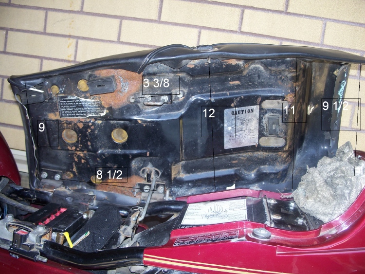

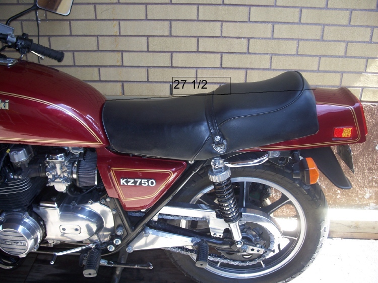

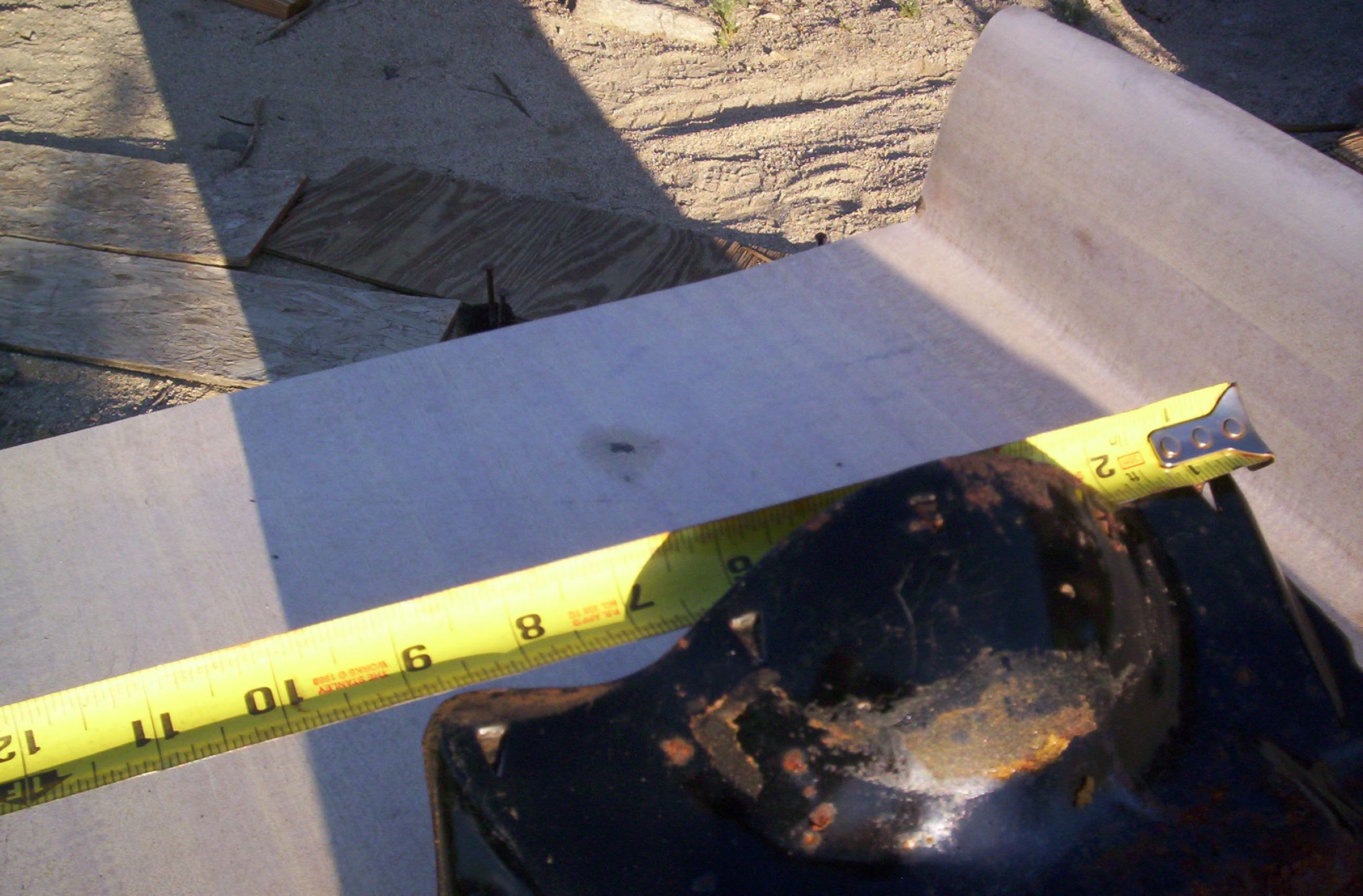

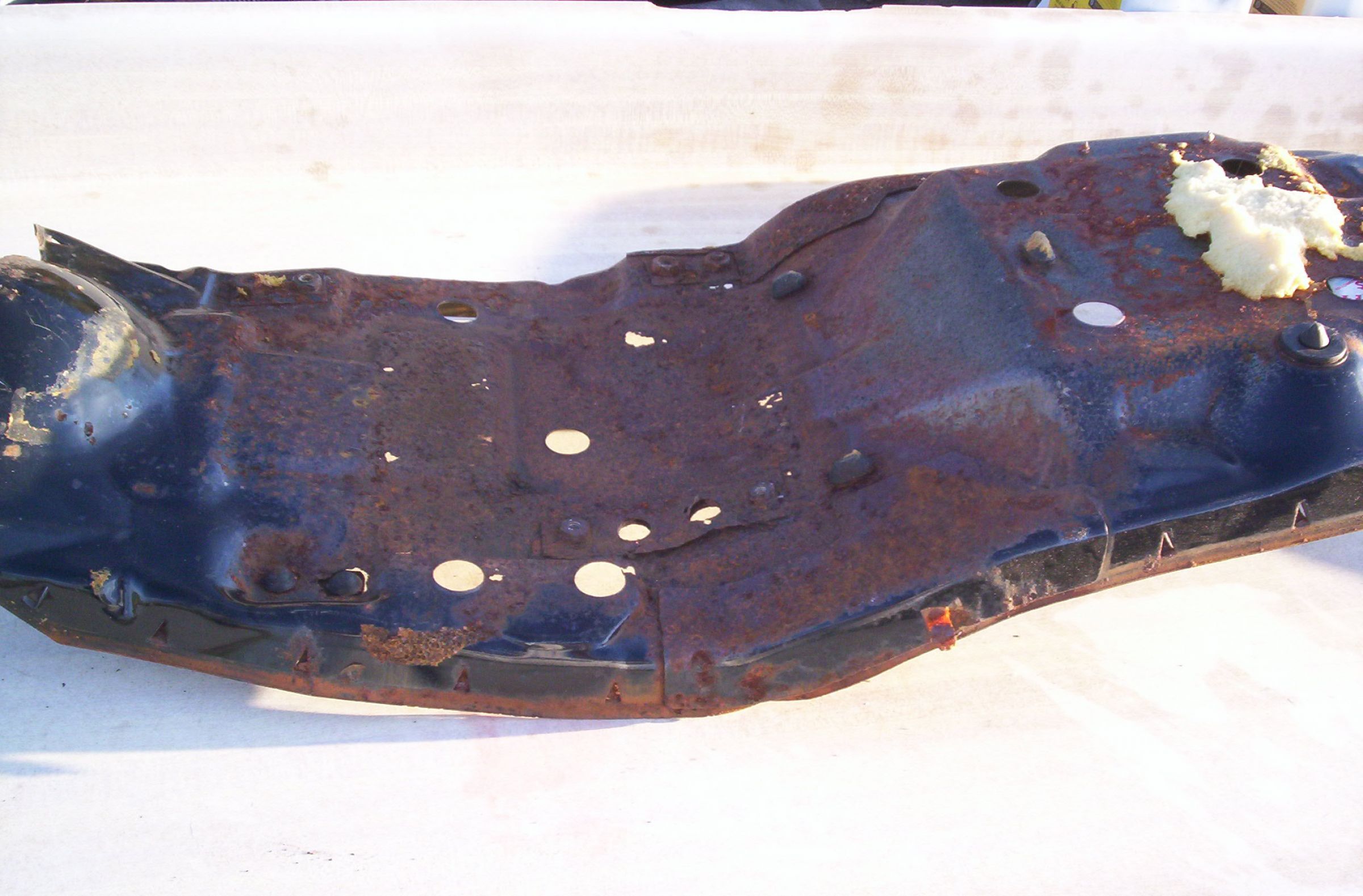

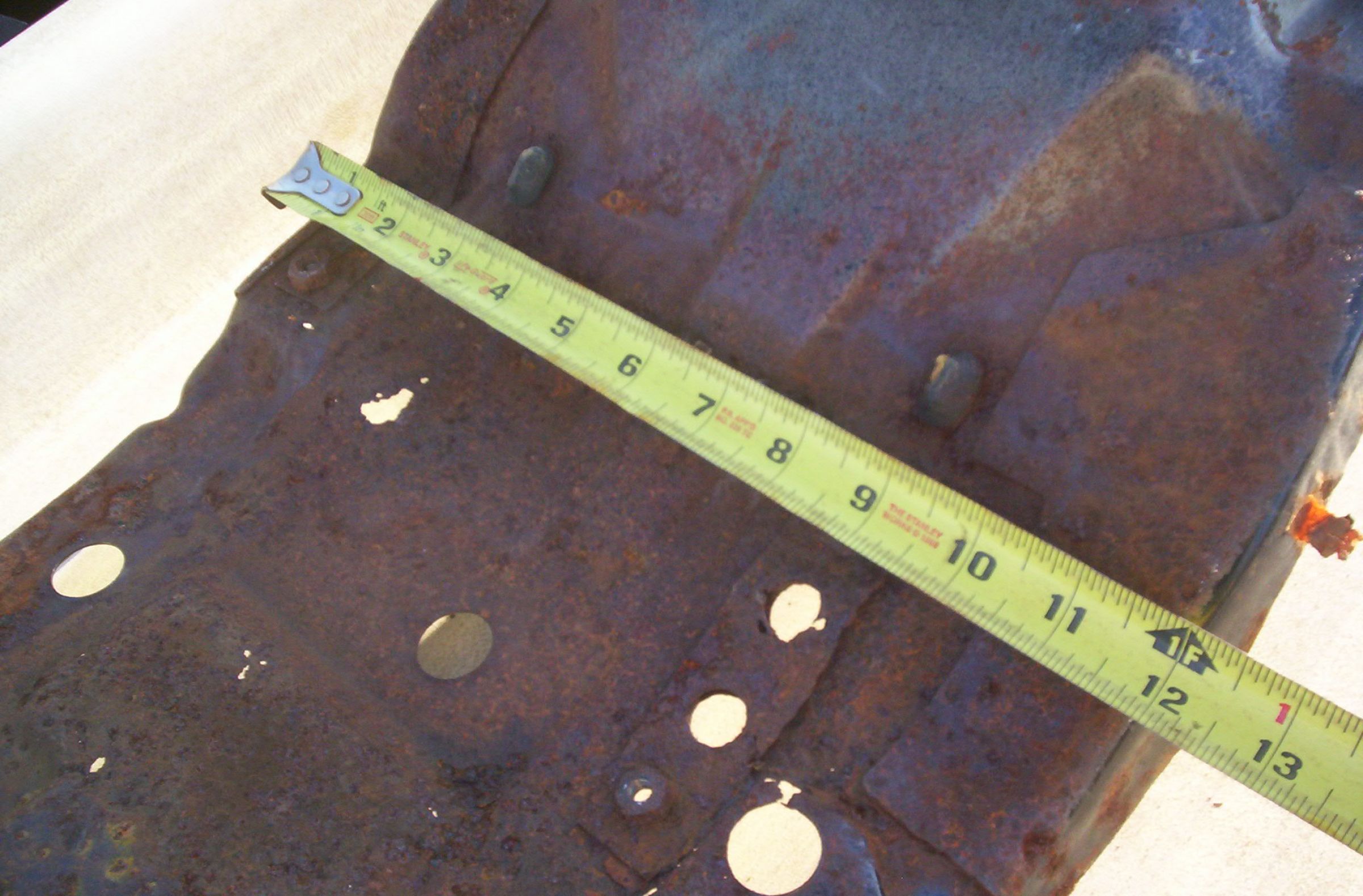

My 1980 750E1 is under a winter cover at the moment but I took the following photos and measurements a few years back for another KZR member. Let me know if you need more measurements and I'll get the bike out.
Here ya go
Here ya go
