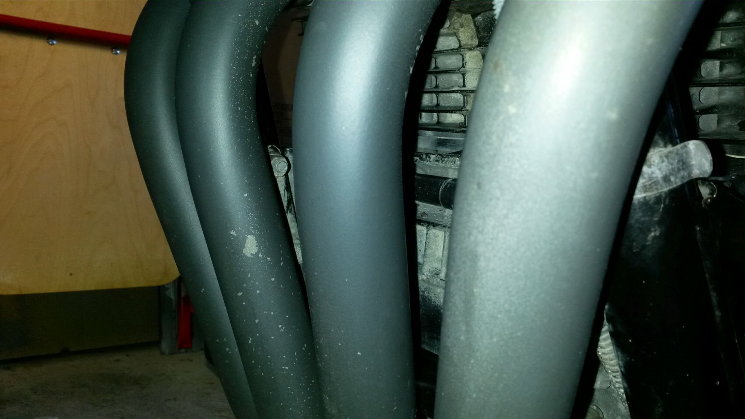

Don`t use Ceracote c- series coild- hardening coating on exhaust pipes.
I used it and it was excellent as long as det weather was sunny.
Riding two days in rain, and the headers looks like this:

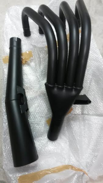

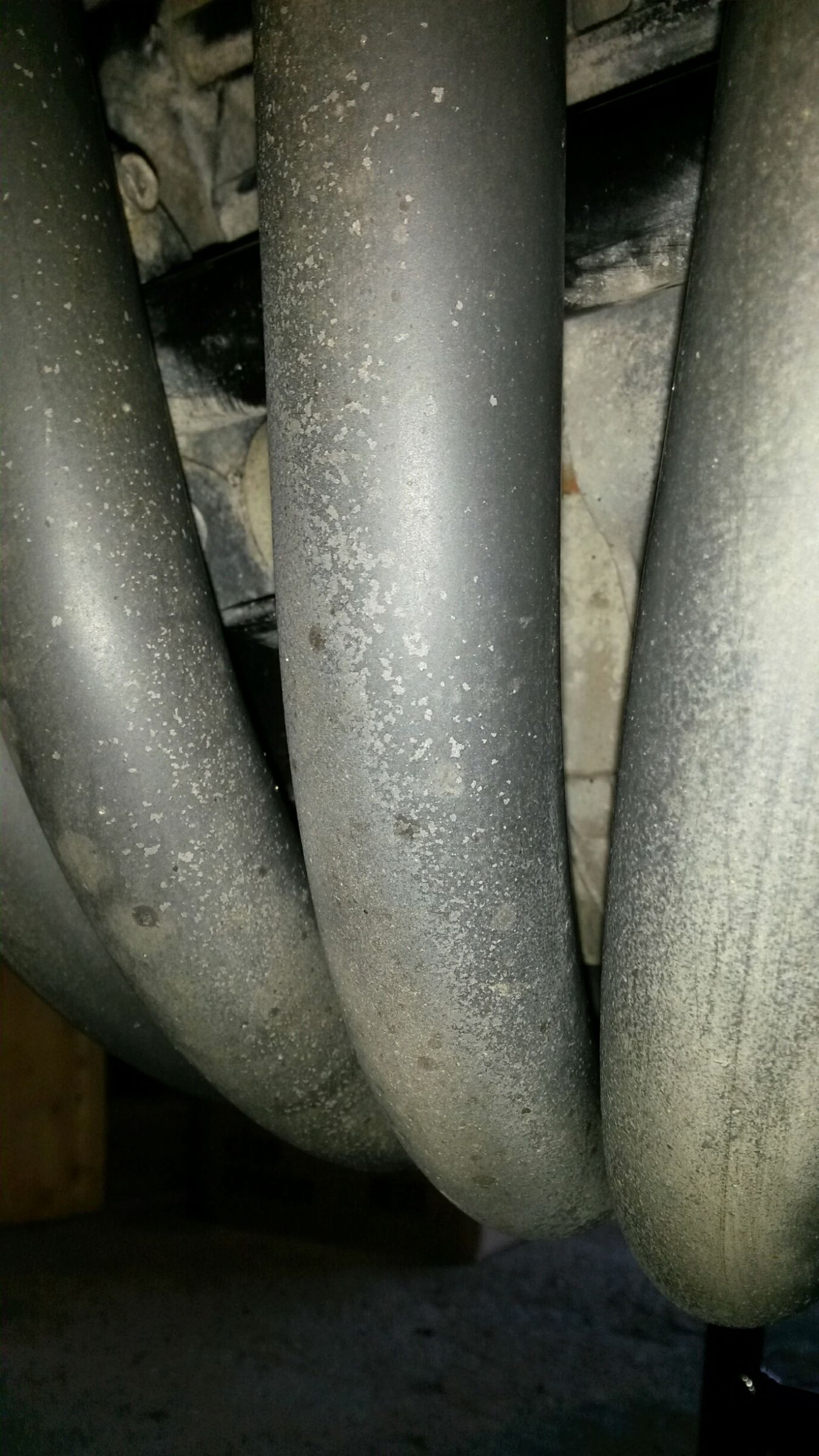

Ok, I"ll give the Ceracote a second chance, heat-hardened this time.
Got the exhaust back from the workshop two weeks ago, tjis is how it looks today.
