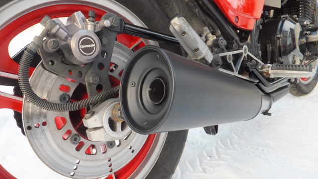

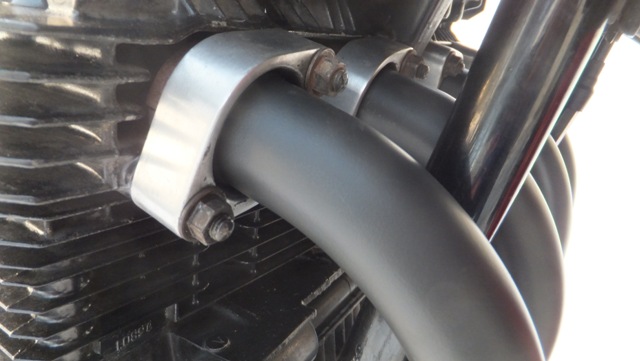

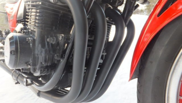

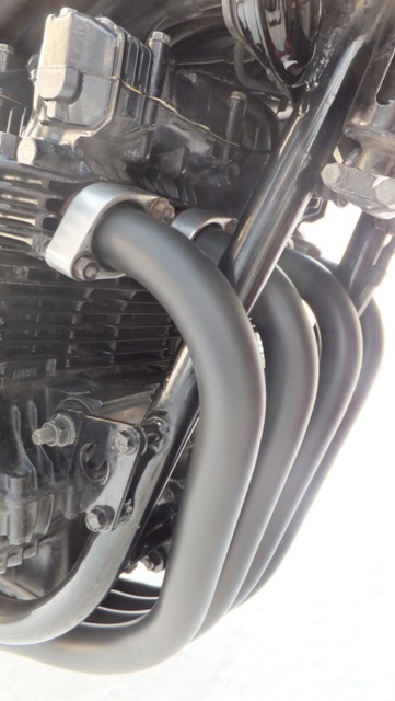

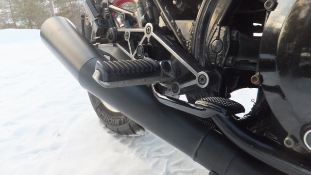

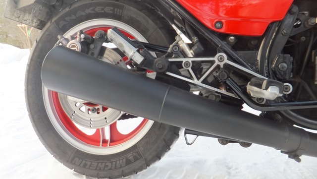

I got my exhaust coated with ceracote this Winter.
Good finish so far, but haven`t tested it yet in high temp, still 3 monts of winter here.

Those turn out really nice. I'm getting two sets painted myself.

That Ceracote looks great. If it holds up for a few years you've got a winner!
