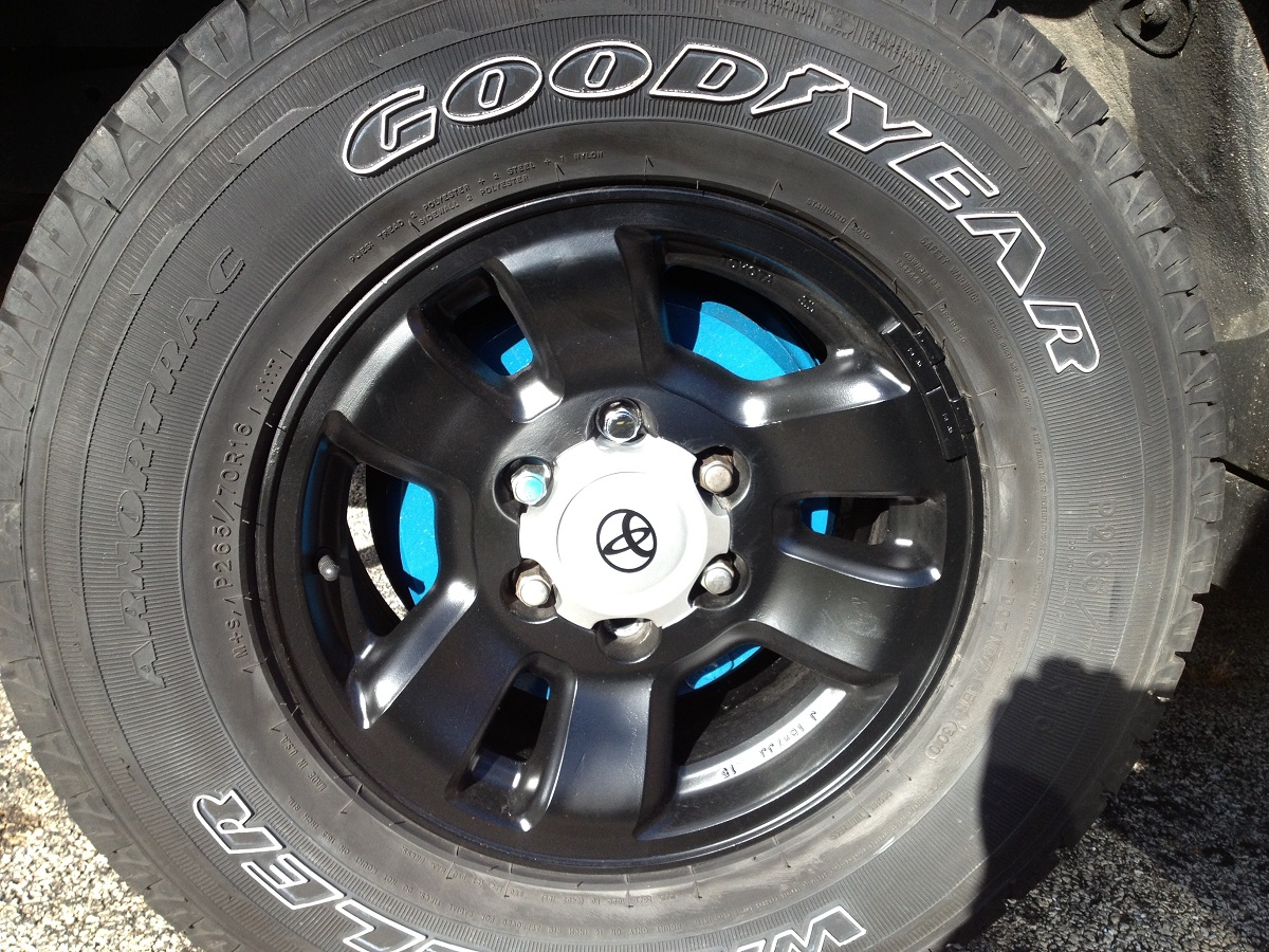

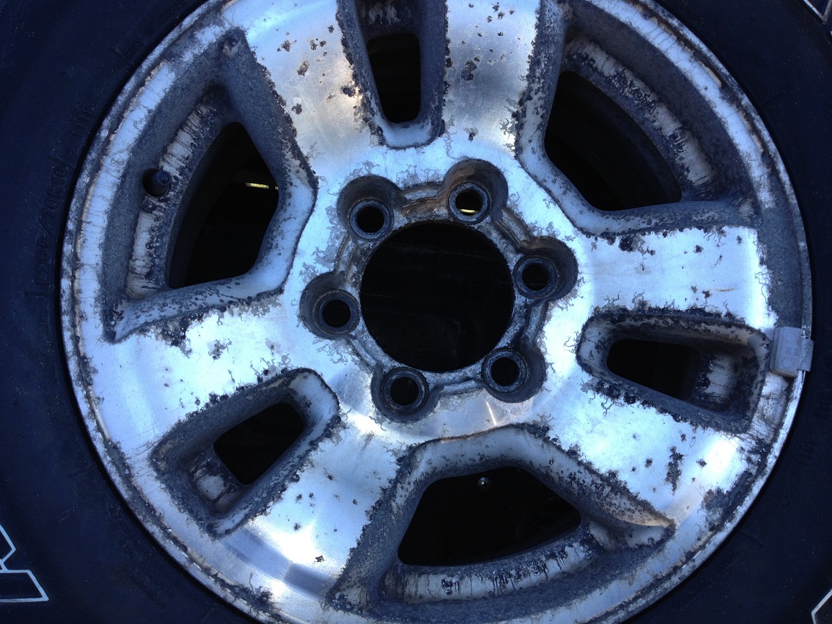

15 Dec 2015 06:18Coyote14 wrote: Ok, my body shop wanted 200 to paint that fender I got from Pete ...wtfudge!!! And I offered to sand it down. 30.00 worth of rattle can acrylic lacquer an sand paper and it's done. A lot of sanding, spraying many coats,wet sanding and buffing . Cost more than 200 if my time is worth anything, but just couldn't bring myself to pay 200 for that tiny fender. We shall see how it holds up. I
Looks real good, Dave,
this is what the rims looked like before the prep work
this is after , with the Satan Black paint, but they also make a Gloss Black
