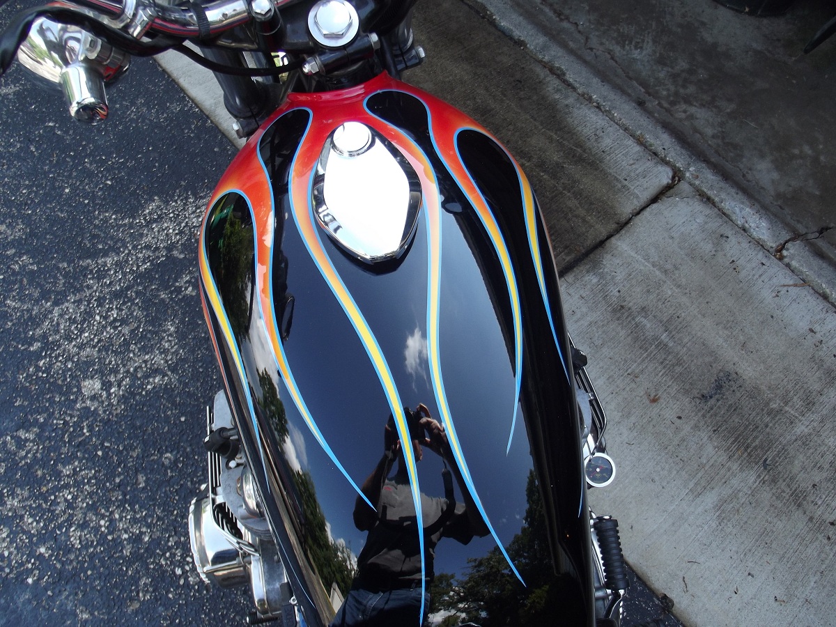

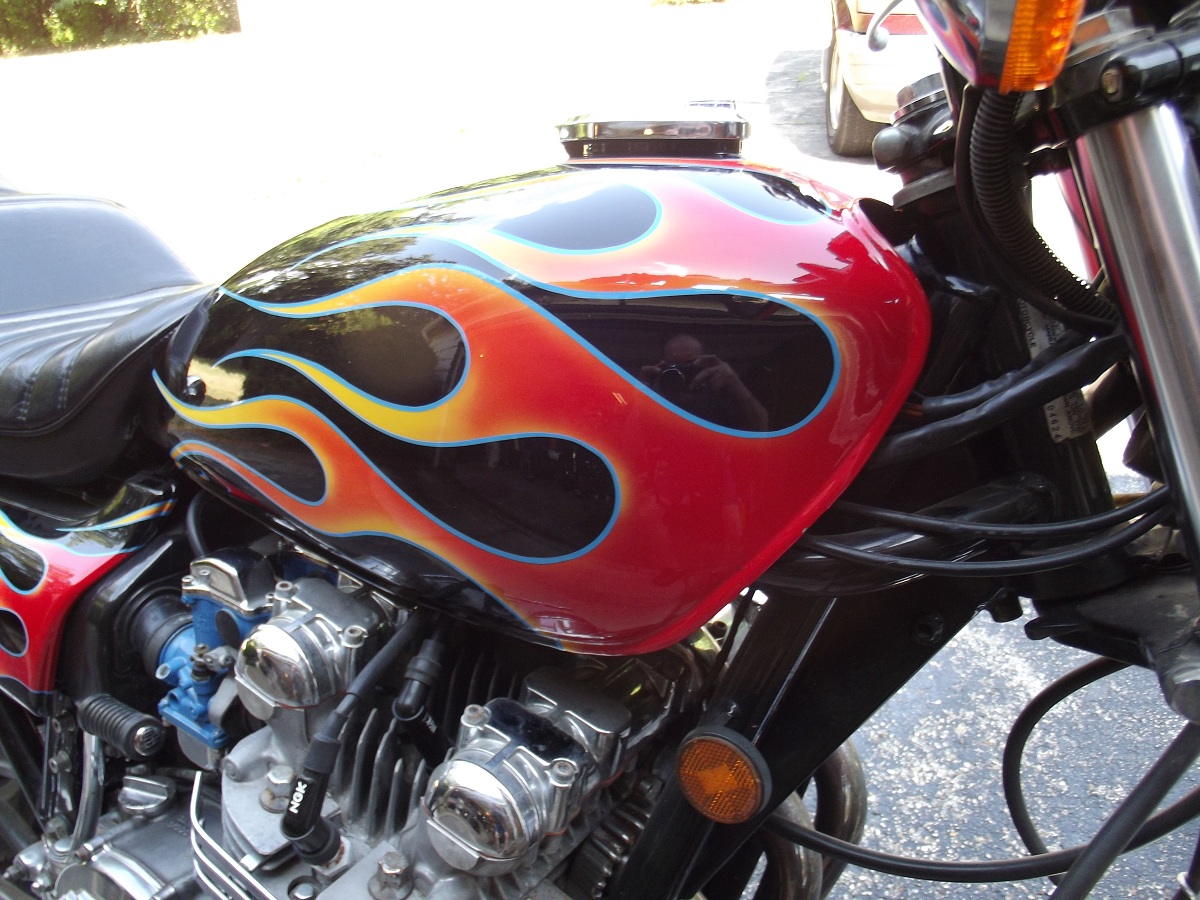

I don't know if it can be done, but can someone airbrush a multi colored flame paint job like this ??
Pete
Pete

Plenty of painters can do that, but it is time consuming and expensive.
It is more a technical problem just applying laying out the shapes with vinyl tape and blending the paint, you don't need any arty skills to do it.
That is a nice job, good colours and the blue really makes the flames pop. Look how smooth the curves and points are with no evidence of back taping.

i would bet the blue lines are freehanded with no tape.

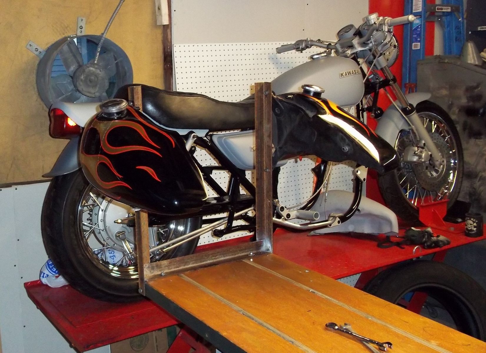

Yes, blue was put on by a hand pin stripper. Some people clear over stripes, some don't. I did these Harley Superglide tanks many years ago, I had my friend stripe the red. I clear them. These were in the middle of a re-clear, after 12 years. gas got to them, from a leaky cap. I like simple flames. I don't over lap them. Black always looks good with flames. As long as they have good flow lines. I have seen so many bad tape jobs, I would be embarised to have on a tank!
Good luck, find a good painter, hopefully someone you know. This stuff ain't cheap.

I always leave a good margin around the gas cap and fuel tap to avoid petrol getting between the paint layers.
Back taping is the easier way to do it than hand pin-striping. An indication of minimum cost, a friend of mine did a custom flame job with some basic stencil airbrushing on a cruiser bike for £600, the steel and plastic were in good condition to start with.

+1 on the hand striping. I did the flames on the VT below, but I don't have the talent to stripe by hand, so I taped the edges. I cleared over the tape, and once it was sanded and buffed it was almost smooth, but still obviously tape. Paint looks SOO much better.

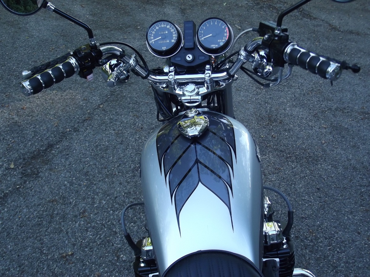

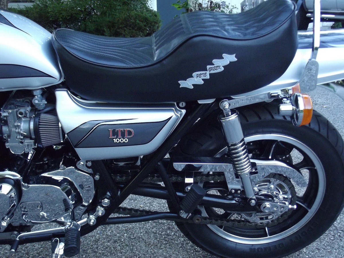

- pete greek1
- Posts: 1510
- Thanks: 185
Re: air brushflame paint job
10 Oct 2015 07:33

Man Pete! That cycle is looking good! 1st time I have seen some quality pictures!
Could be a cycle of the month candidate!
Clean & nice detail! Chrome always helps too!

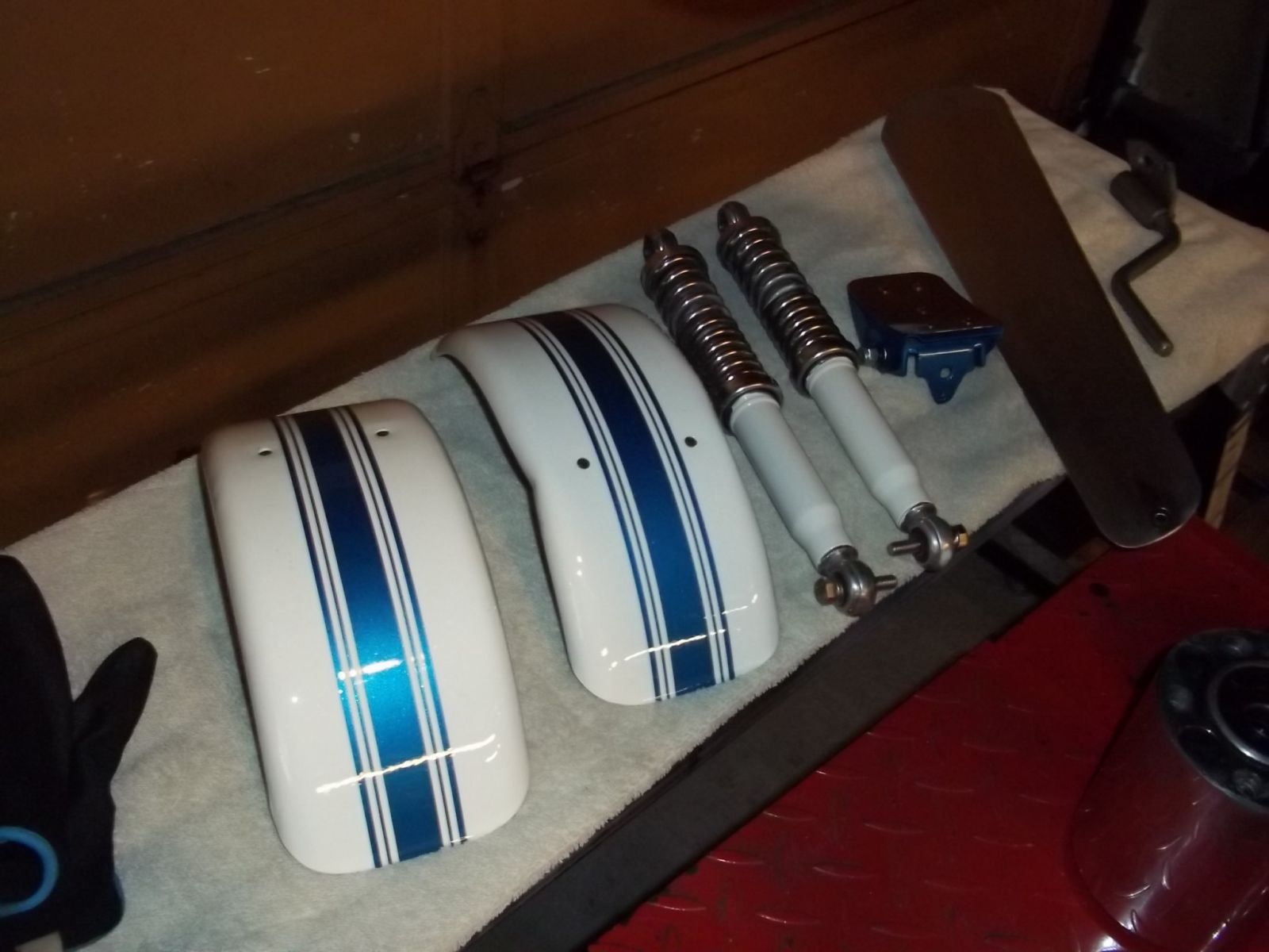

But I just sprayed this mini bike Monday with 16 year old medium Blue Ford color. White and blue theme going. I used 25 year old pinstripe tape. Pulled about 4-5 feet off. Warmed it in microwave a few seconds to warm the glue! And it worked perfect. Taped over the white, sprayed the blue, then cleared it with urethane clear coat,
4:1 cheap clear.

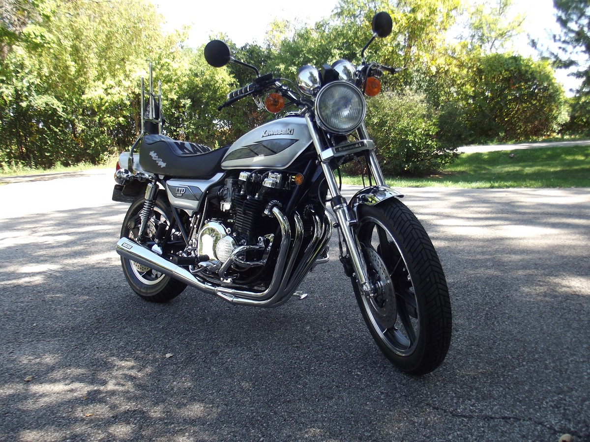

- pete greek1
- Posts: 1510
- Thanks: 185
10 Oct 2015 12:36
Here's a better picture, I got a lot of compliments from some old Harley guys that had 900s & 1000s back in the day before they became Harley guys, at the 100, 105, & 110th year anniversaries up in Milwaukee, they'd tell me they wish they still had them,
Pete
