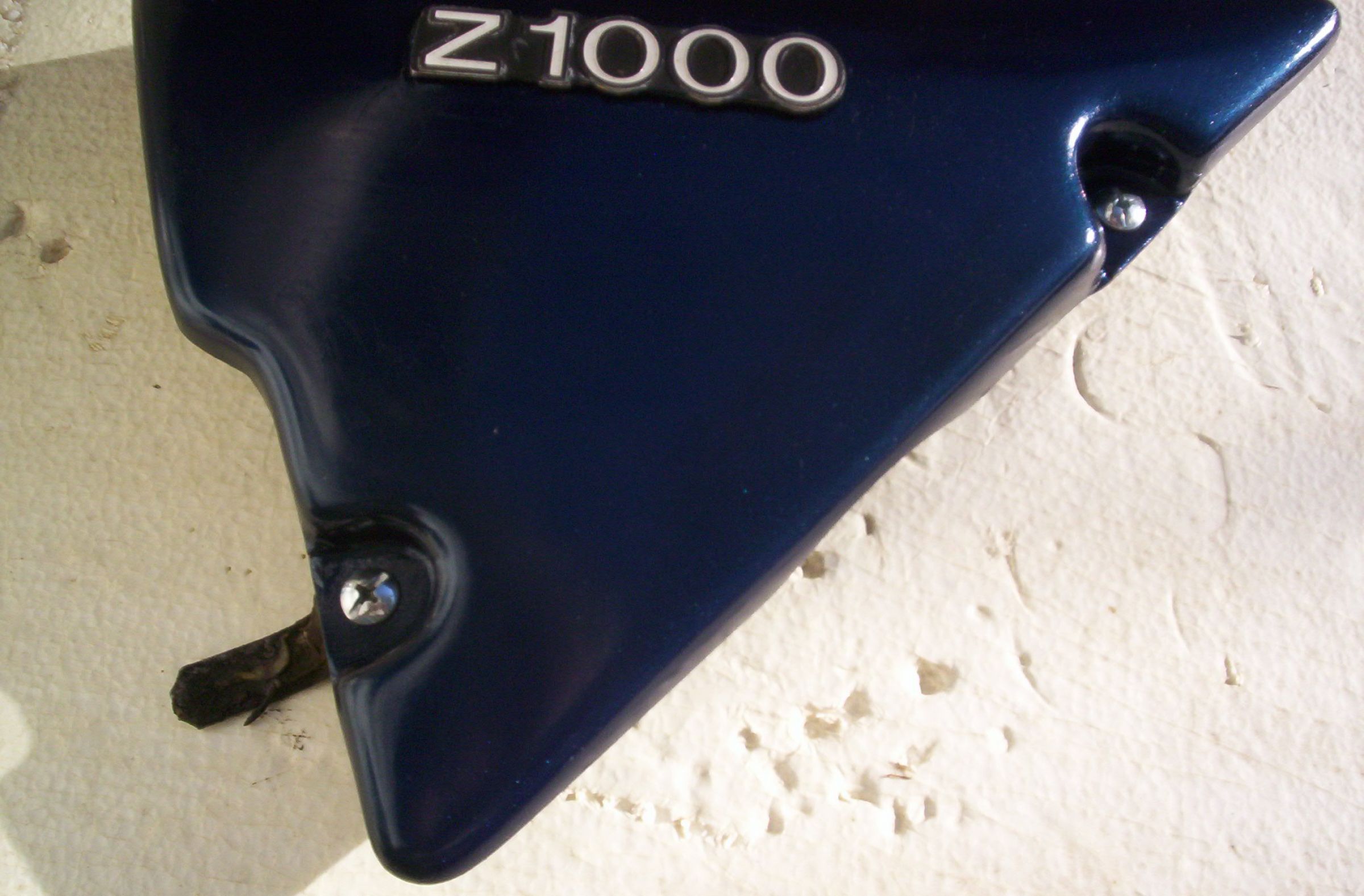

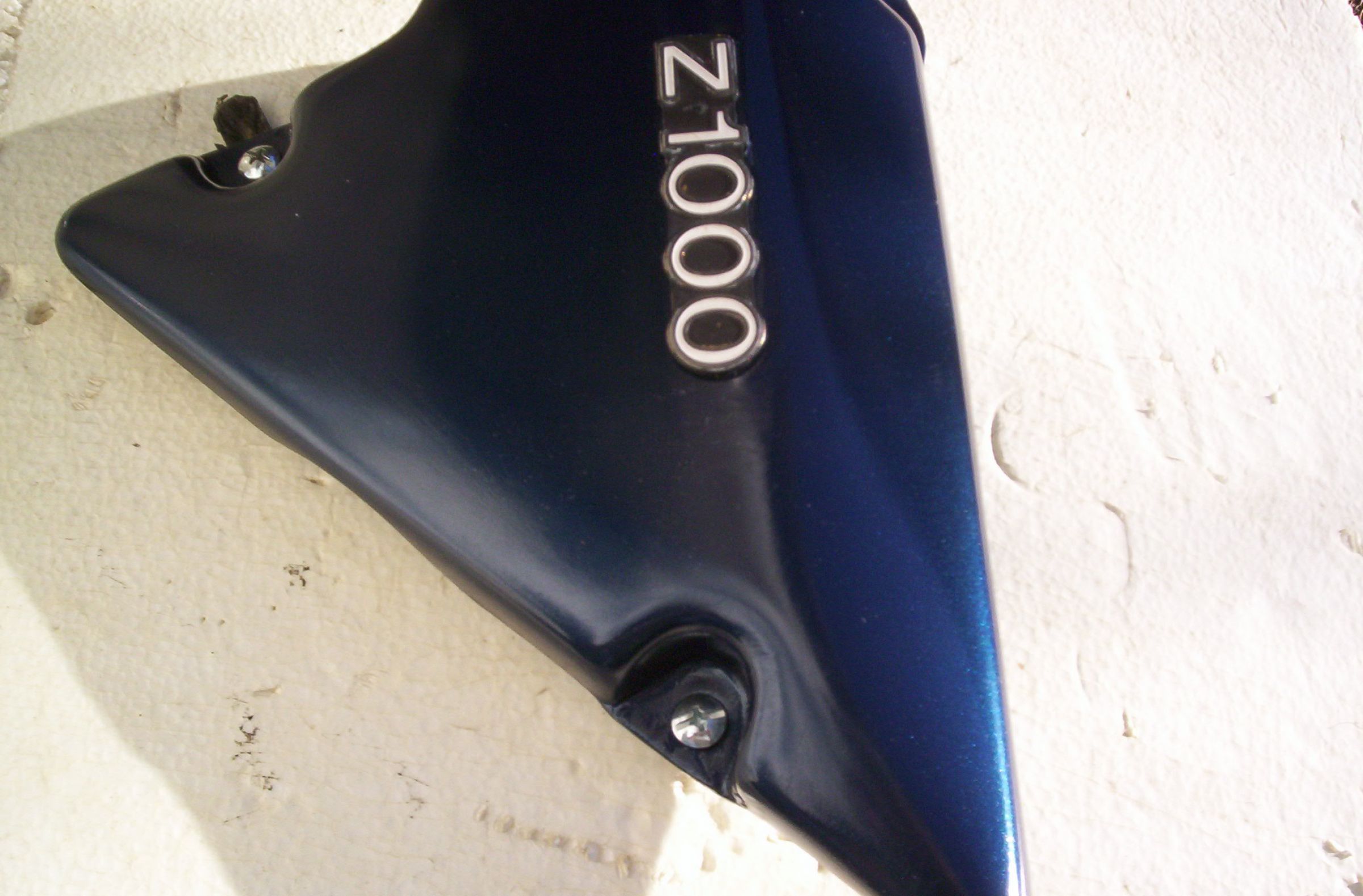

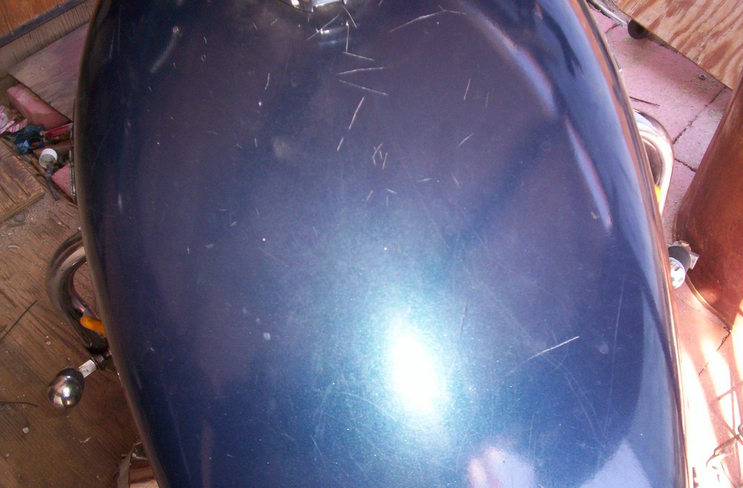

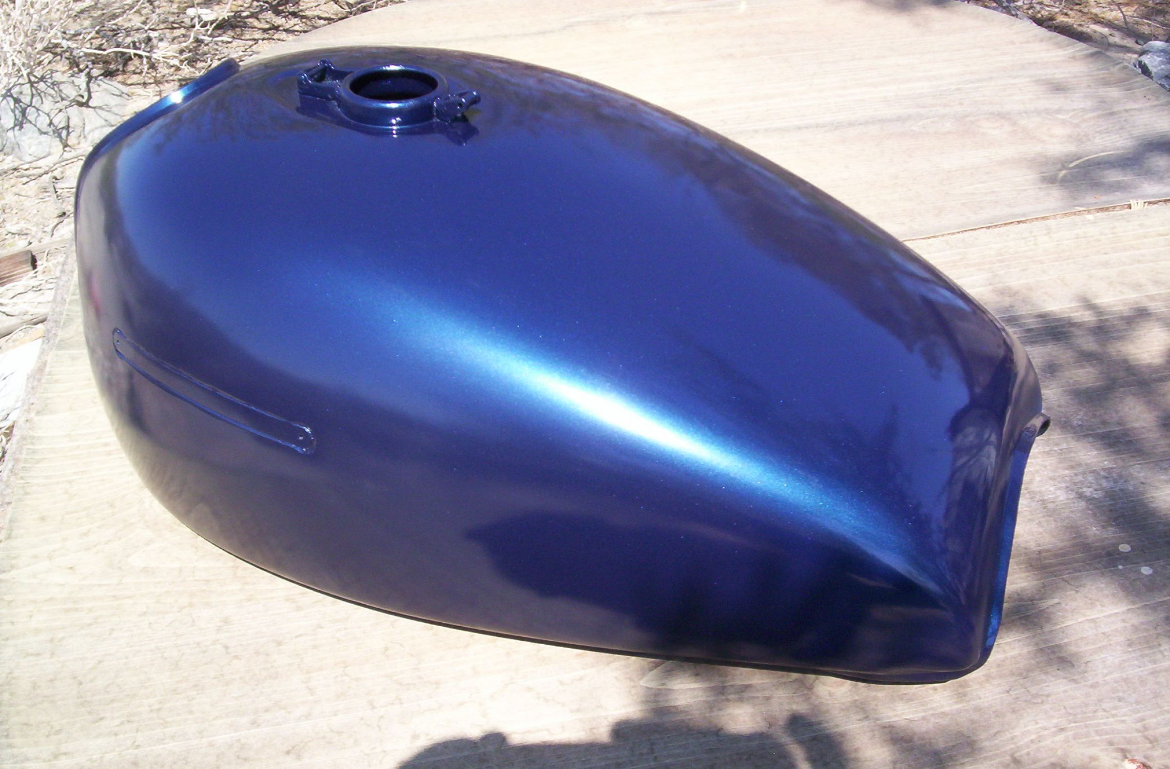

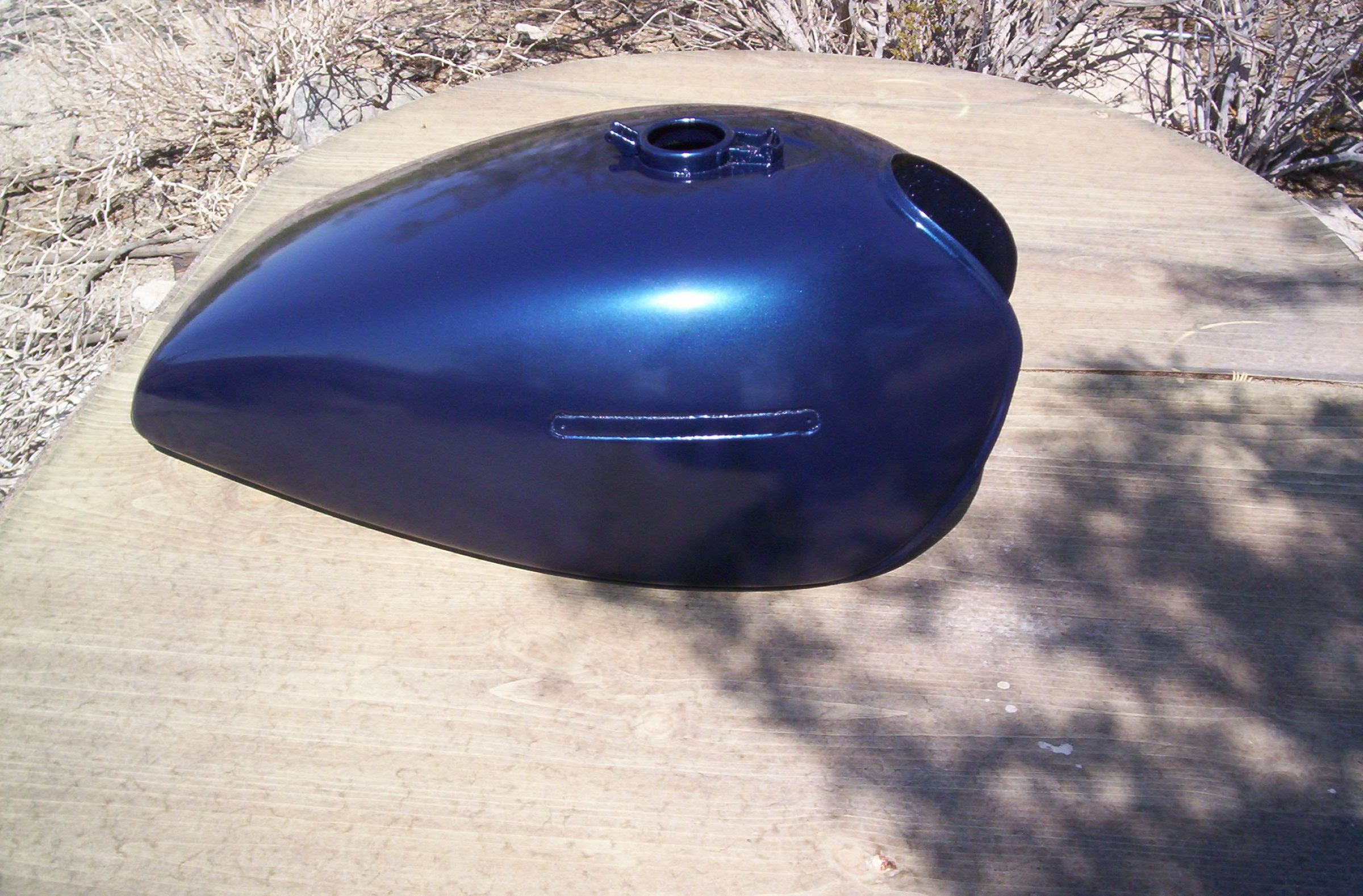

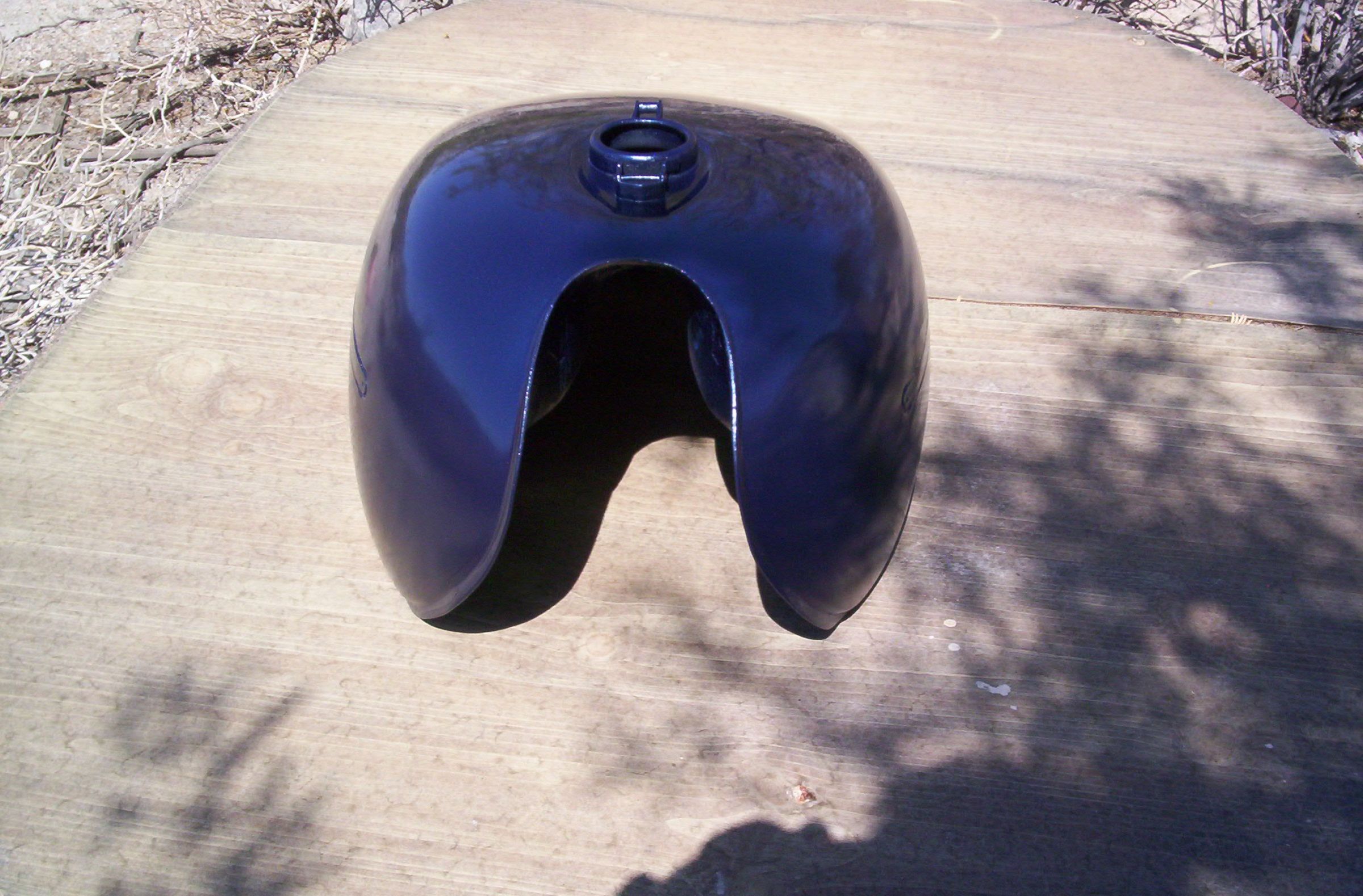

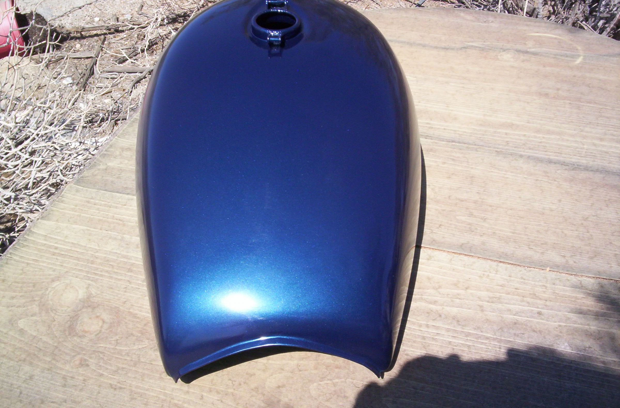

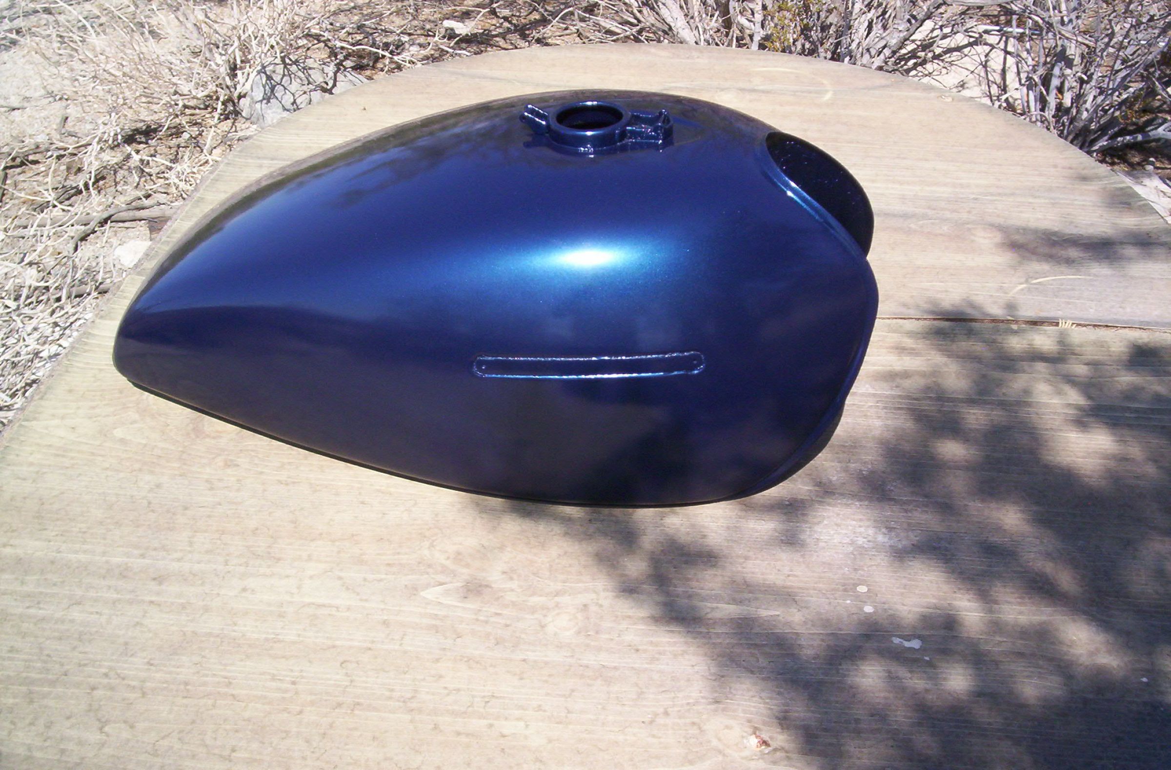

Well back at it again. Not only did the goat scratch my paint, it was cracking, a big chip came off too. I think the primer failed. :dry:
For the last couple months off and on I've been stripping, priming,sanding and put color on the spare tank. It's been a couple days. Got some more sanding to get the fine blemishes out, wet sand then color and clearcoat. I'm taking my time this time. Good thing I have a spare tank.
The sun is so intense out here and it gets very cold too. Very hard on paint. :pinch:

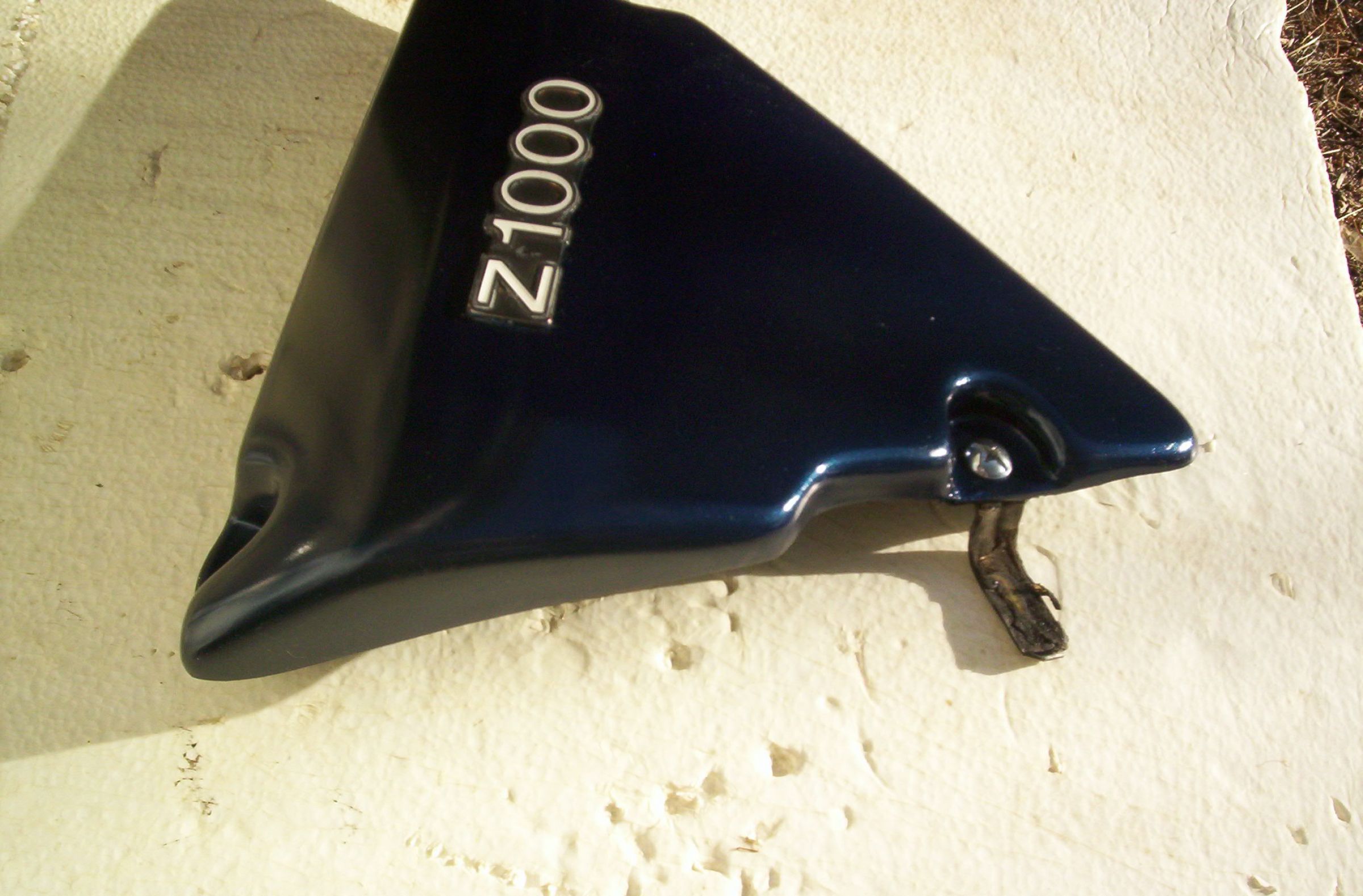

Taking my time I wet sanded it and took out the small imperfections. All was going well until I put on the clear coat. I guess I'll have to live with it while I strip down the other one. It has less dents so I'll try the freeze method to take them out. This tank has a lot of filler in different places, the paint was hard as a rock so I figured it would last. I figured wrong.
