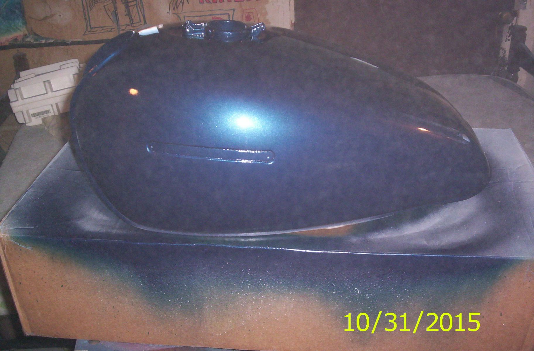

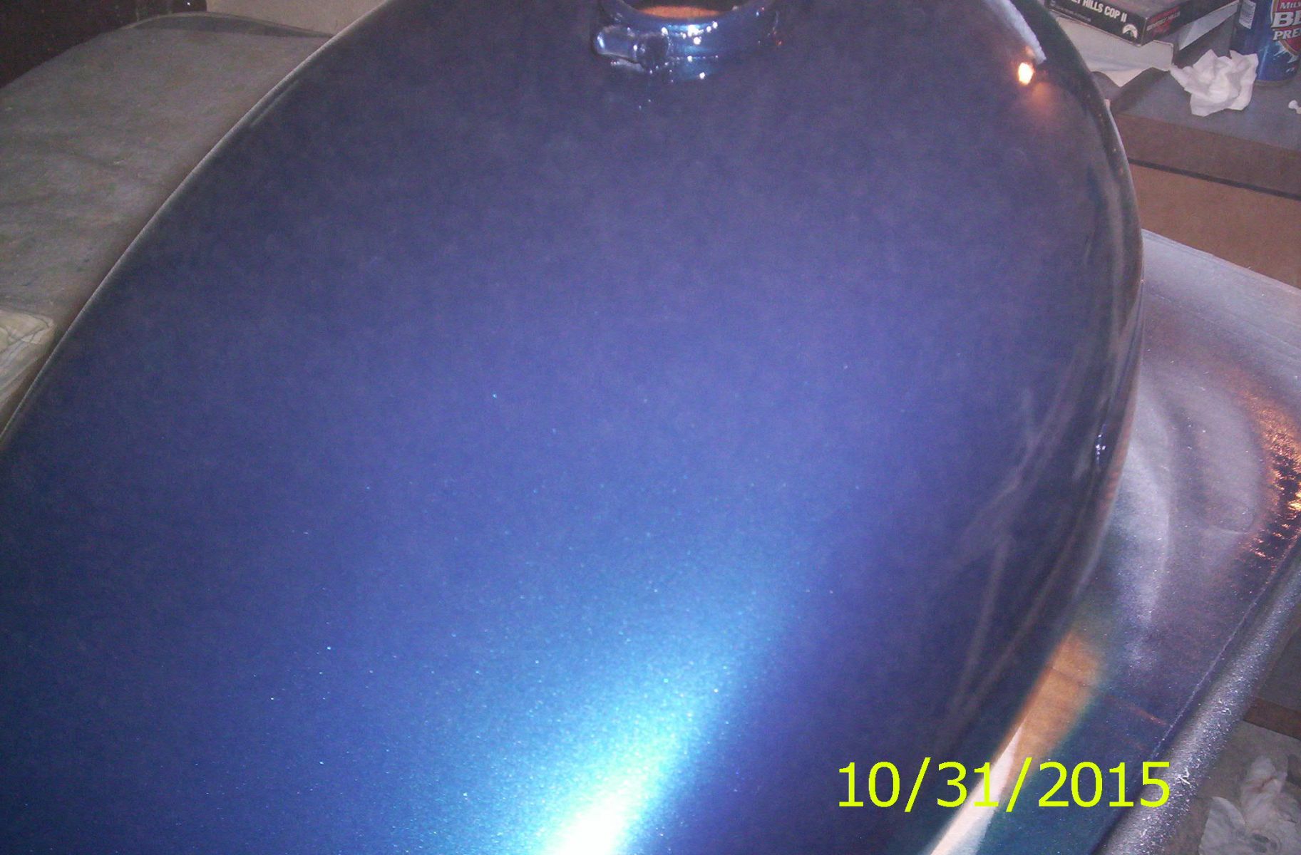

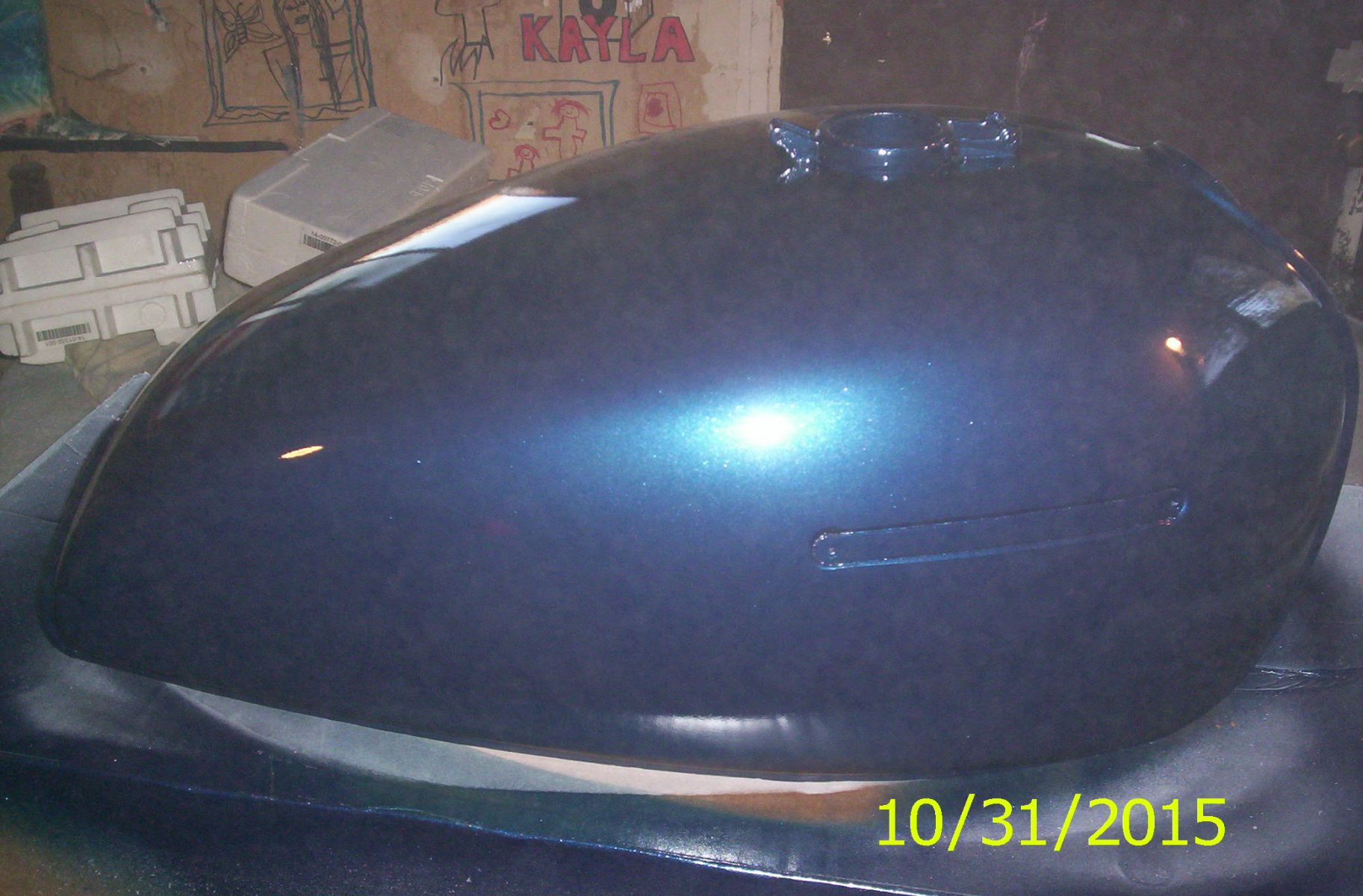

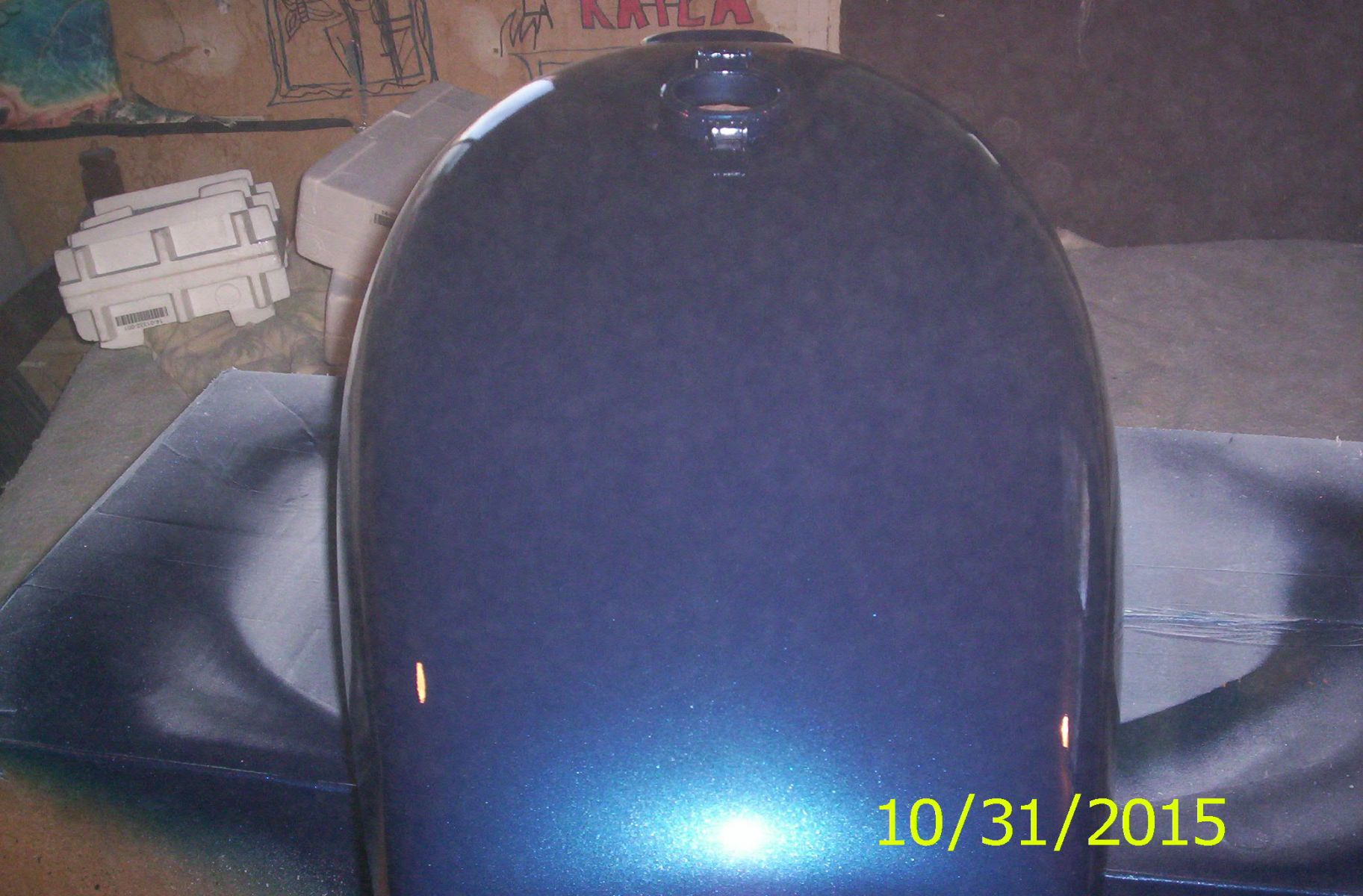

Since I posted on this thread, I've been sanding and prepping the extra tank for paint. I squirt on some color, wait until it cures and sand out the blemishes. No rush, a lot of other things to do. Humidity is low this week for a few days so I decided to finish it if I can. 27% today. Going from 220 to 320, then 600 grit, painting in between, it's starting to take shape.
F it, I bought a extra can of color and went for it. Didn't need it. Got 4 1/4 full cans left and clear coat is on. Two light coats and one wet coat, ten minutes apart. Looking good. Got plenty for the side covers and tail
This is my daughter's bed room. Before I could paint the walls, she decided to draw on them. She was 12. Kayla was born so she was included in the art work. I can't bring myself to paint over it all. When she comes to visit, I can tell she likes it. Oh well, history preserved
The tank will sit in there for 24 hours before I do anything with it. This time I dug out a respirator I bought 15 years ago.No smell, Why didn't I do it sooner? I hate the smell of paint and the high is horrible. I don't understand me sometimes. :dry:
