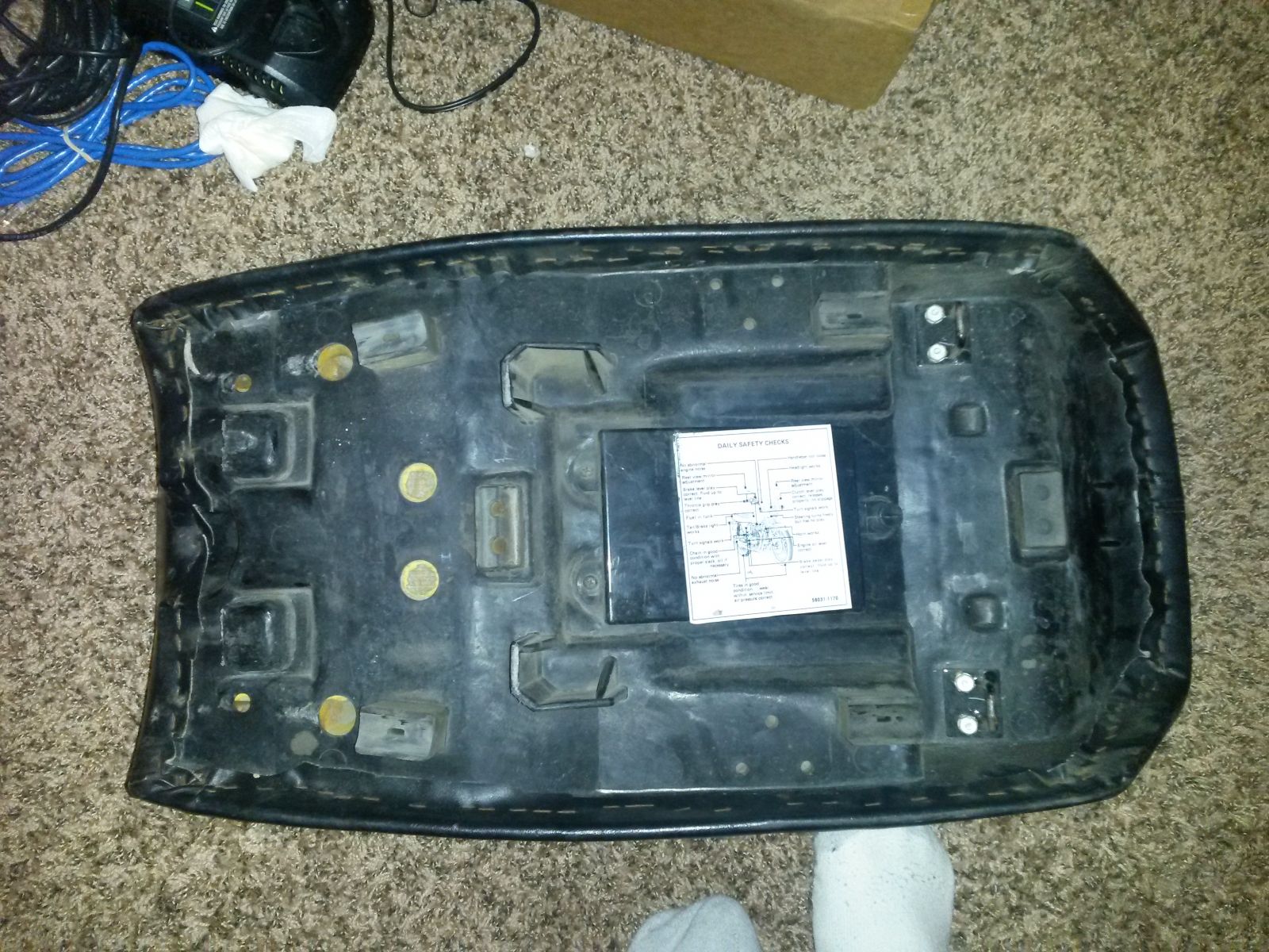

I have an 82 GPZ 750. I want to purchase an old seat that I can re-cover and fashion into an Eddie Lawson type seat. What other 750 or 650 pans are an exact match? Mounting, set ;latches, etc.

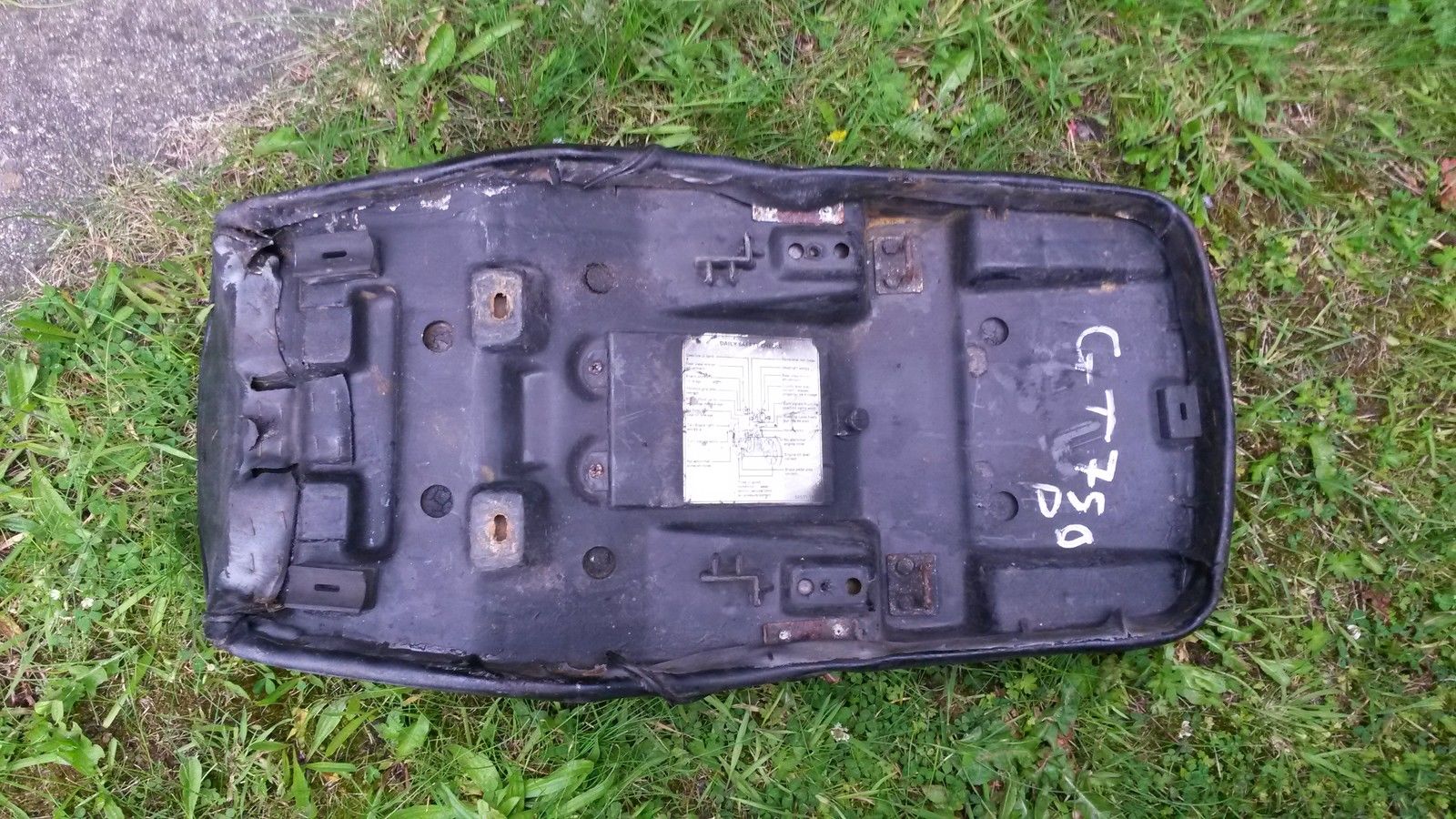

I ordered one from a Kawi GT750 (Z750P1) from the UK. Talked the guy into stripping the cover and padding to save shipping cost. Not sure if it's an exact match but I'm game to make some alterations. I'll let you know.

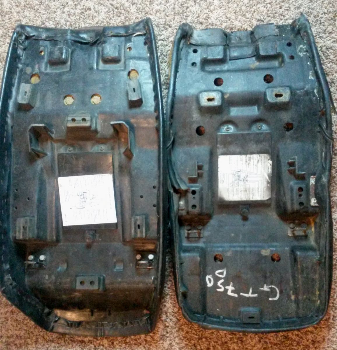

OK, I finally got the seat pan from the UK. Here's a side by side comparison.
The pans are obviously a different shape. This isn't concerning me very much actually. I did a trial fitting and so far my observations:
I had to remove the front pads to get the front tangs to engage but they did nicely after that. The seat is flat at the back so it interferes with the grab bar and tail piece so i wasn't able to lay it flat, I'll have to trim it back an inch or 2. The latch loops are too far forward but I should be able to move them back and maybe use spacers and pads in certain places to get the seat to sit even and flush. i plan on converting this to a solo seat/tail rack similar to this but more practical than pretty.
Overall, it should suit my purposes but I don't know if it will suit yours, Jrider.
