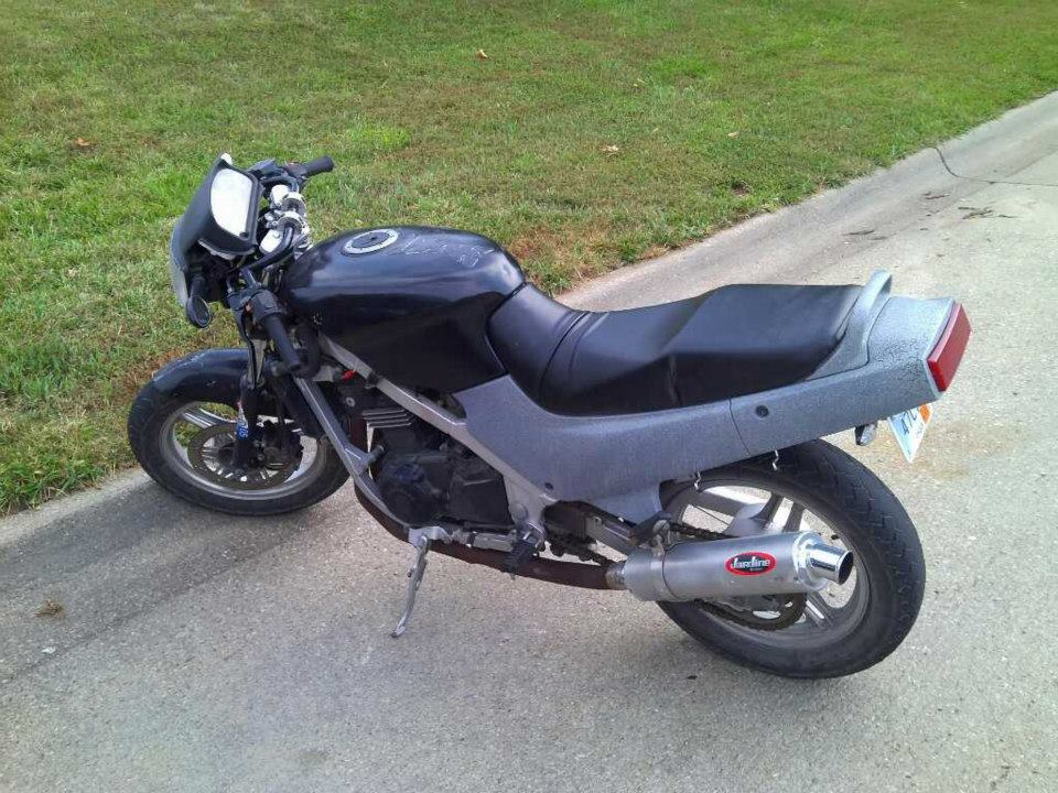

I re-covered the seat on my ninja 500 ex with marine vinyl. Did some tricky folds on the high-side transition, I would have preferred to put a seam there but I didn't have access to a machine. Also it worked itself into a bind in the curve to the tank bit as you can see in the pic. $10 in materials it was worth it tho, was my cheap 'drag' bike.
