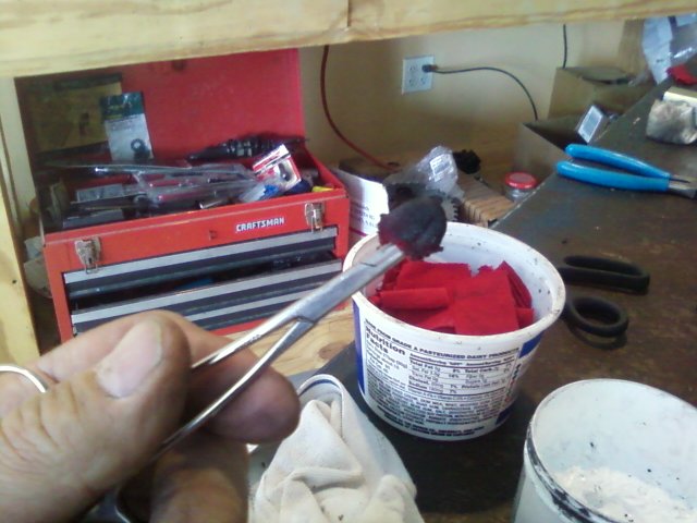

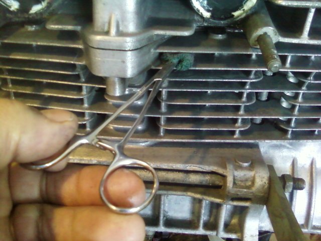

Very nice bike! Your fork lowers have a clear coat on them, thats why they are a bit yellow. i would strip the paint off them before polishing. makes 0it a bit easier than sanding through the paint.
This is from a different thread, i have found it works REALLY well for getting in between the fins.
