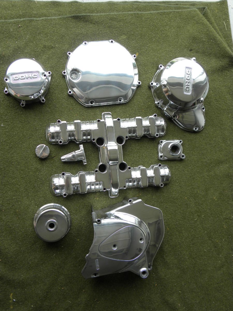

I have used simple green and also some aluminum wheel cleaner in a store that you spray on and rinse off after 15 seconds. But you cant beat doing it by hand. Here is a set of polished aluminum cases. NO I didnt polish them I bought them. Much easyer :lol:
www.kzzone.com/
- peter1958
- Posts: 1553
- Thanks: 198
Re: Cleaning aluminum tips needed...
01 Aug 2014 13:07
But what what they cost I could go buy a kz 400 :sick:
www.kzzone.com/
01 Aug 2014 13:34
But they look GREAT and will be easy to maintain. Ed
