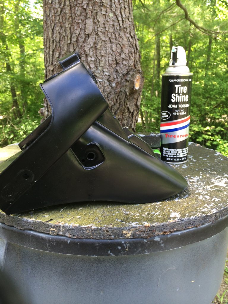

I found an old can of tire shine and gave it a go..
Came out nice..
Will see if it lasts...

Only problem with the tire shine type of products is the finish attract dirt and fade with time.
When wet or not wet they also sling juice all over and on other parts.
The look is temporary.
Not familiar with the Firestone product.
I must say it looks great, good job.

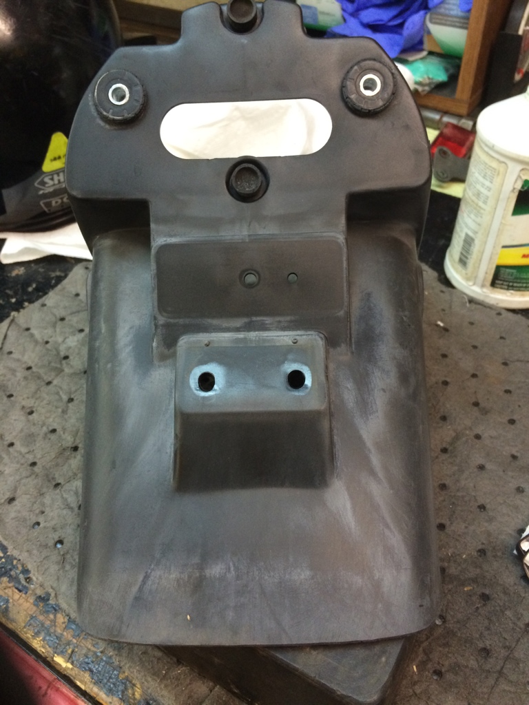

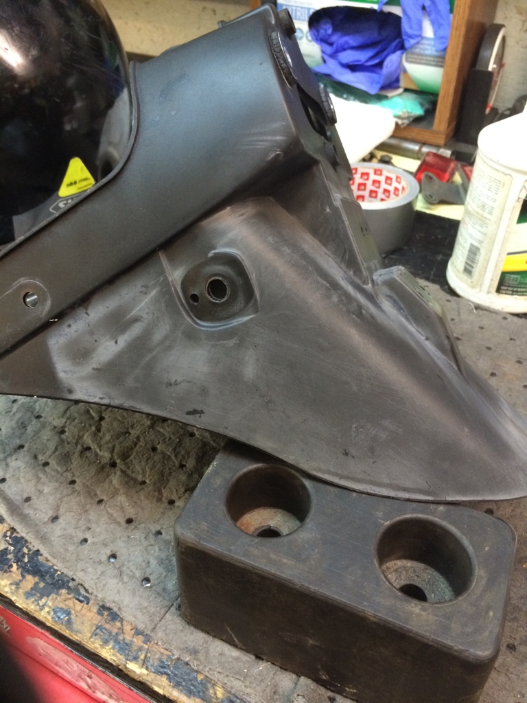

You are absolutely right about the grit. I painted my airbox. i sanded with 120 to get as much tooth as possible. Then I wiped the whole thing down with acetone, and then Immediately sprayed Rustoleum plastic primer, 2 coats. Then sanded with 320, then Rusto semi gloss. looks great. but time will tell how it holds up.
