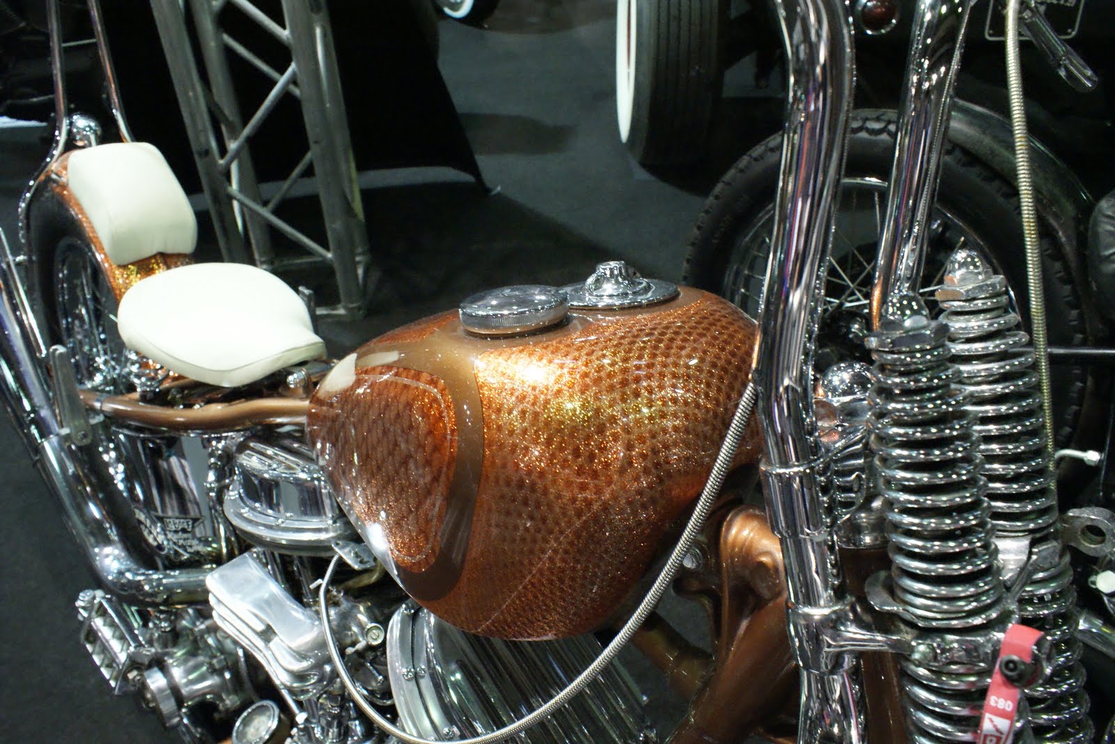

Looks like I am not the only fish net painter
check this out

Okay so I really can't figure this out correctly. How on earth do you paint the outline around a pattern in a different color . Do I just clear coat and do the outline last?
