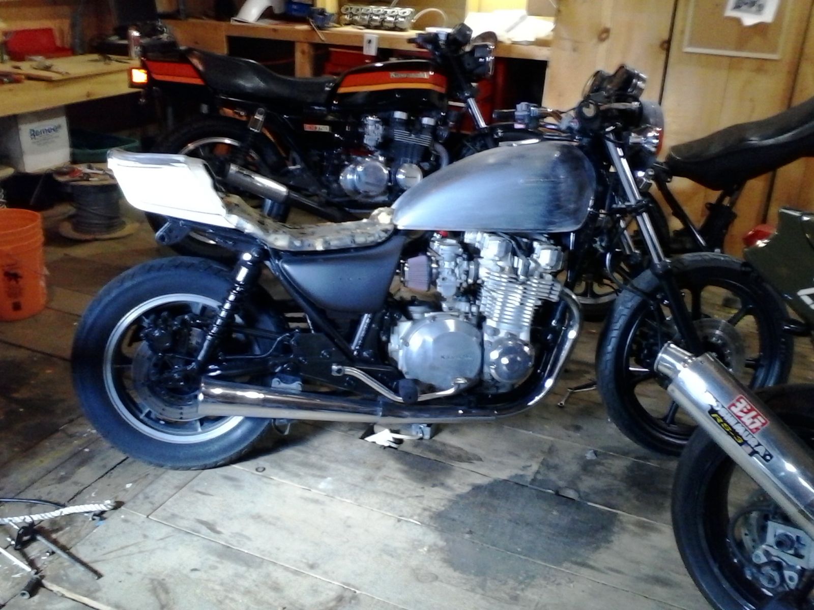

Has anyone done this? I'm planning the build of my seat for my 80 KZ750. I was thinking of using most the front portion of the seat pan with the seat lock, hinge points, and the stock rubber supports, and placing fiber glass over it to achieve my seat profile/cowl.
Any thoughts on this?

My son did this on his 550 LTD pan. Cut the rear section off of it after installing a rear tail section from a KZ650. Reshaped the original foam, adding heavy carpet padding for support in some areas. Turned out well. Now for upholstering.

I have the same bike, and seat/pan, etc. I've cut down the foam to half the thickness (and repainted the pan after getting a bunch of rust off it) to make it more sleek looking. I've got a new skin en route off eBay, and will see how it looks with the recontoured foam. I want the same look as your one pic with the 750 style tail on it, but with an actual cushion, but if it still ends up looking dorky like the original LTD seat, I may follow your lead and try and graft on plastic to the tail of it.

this works.
nice lines,the "right"look i like it. :evil:
maybe if it could be dropped down just enough to cover the frame rails. :whistle:

Okay. Got a mold made from the back half of my tank. As soon as it warms up a bit more, I'll lay the glass cloth inside of it to get a nice smooth plug.
Did a little massaging of the pan to get the right line along the frame. Next step is laying on the glass cloth to the pan to strengthen it up a bit. It's a bit flimsy after I cleaned all the rust off.
As I get more done I'll post up more pics.
