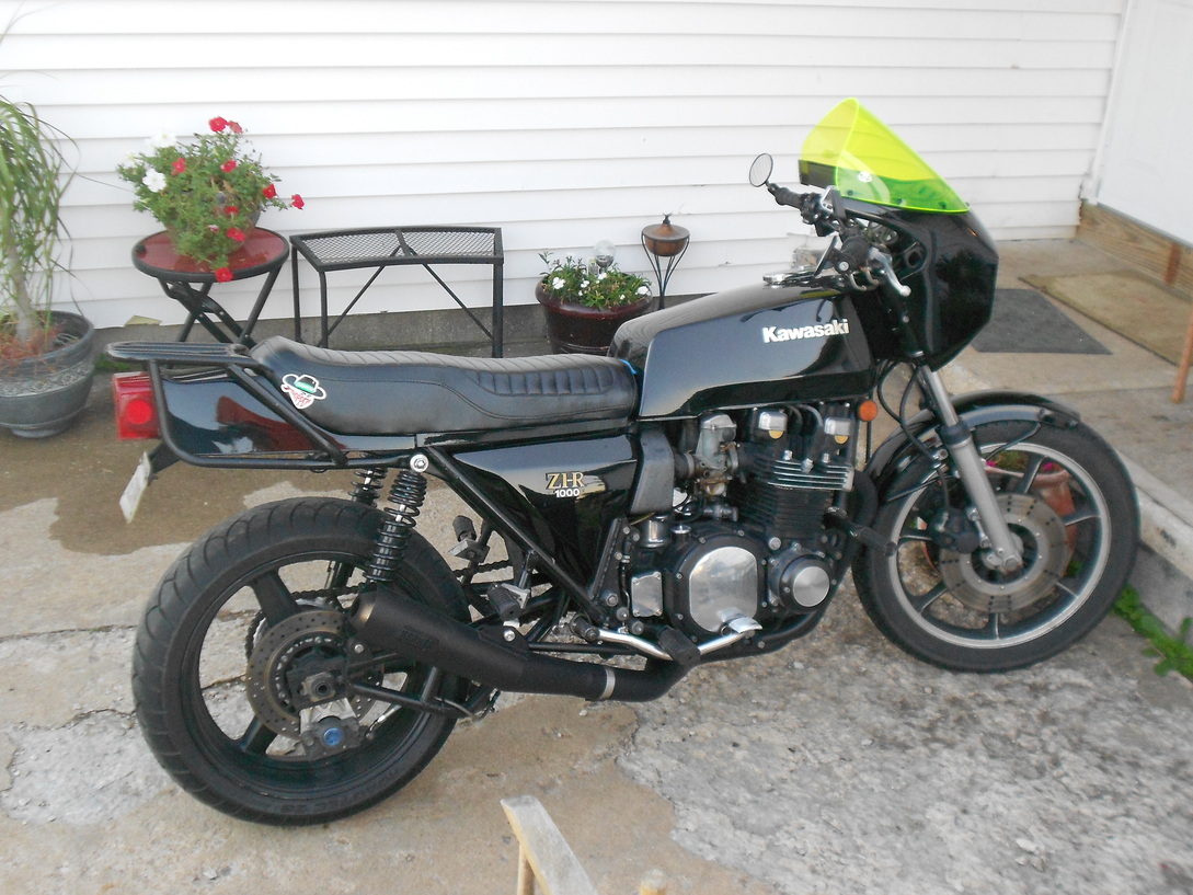

02 May 2013 13:48martin_csr wrote: This seems like as good a time as any to ask... How doable would it be for someone to make a frame-grip-luggage-rack combo, sorta melding the stock frame grip & a Kawasaki rack into one unit? In the pics you can see where the frame grip attaches to the bike. Tthe luggage rack attaches at the same rear mounting points as the grip & at the tail light bracket. The custom unit would probably attach the same as the stock frame grip. Or perhaps at 3 points, but others have reported that the tail light takes a beating when a rack is attached to it..
here is a rack i built from stainless tubing that use the shock studs and turn signal mounts for attachment points.

03 Jun 2013 06:42what pipe are you running? it almost looks like a kerker cut back to the baffle.

That's a sharp looking rack Leon, I need to find something like that for the 650.

03 Jun 2013 12:07it is an unmolested kerker withe aluminum end cap(no baffle) that has kerker cast around the end.
i bough it from vernons.
thanks bluej58 it works very well.
